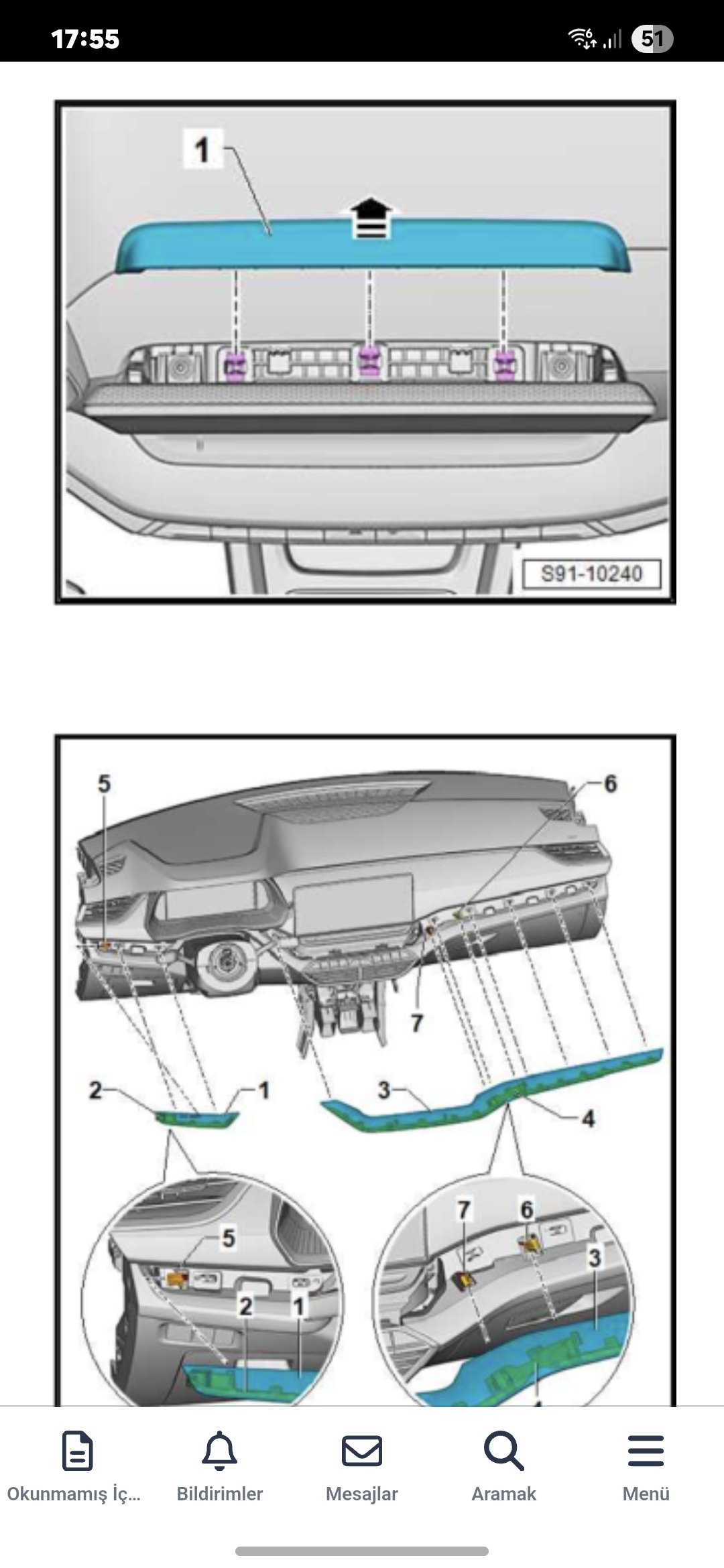

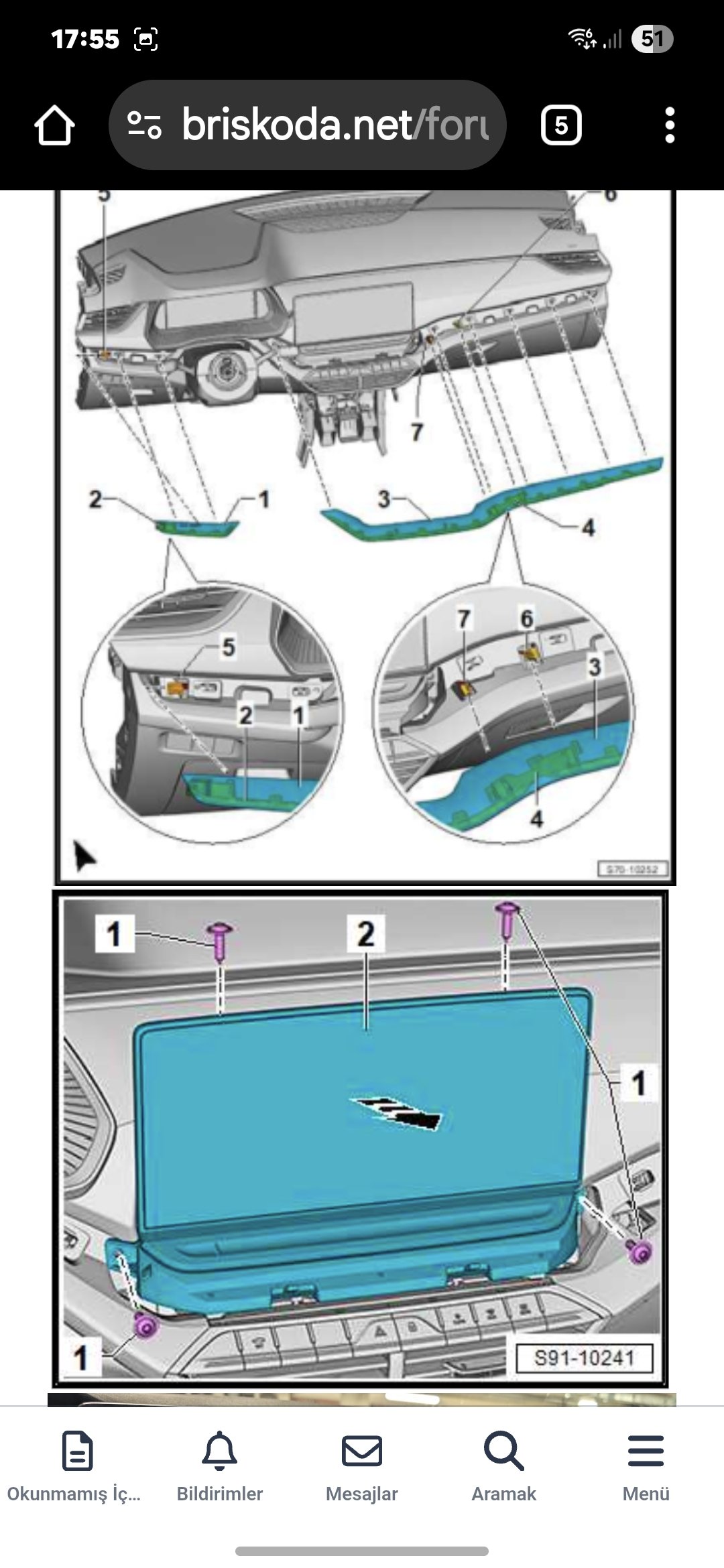

Thanks. I got the front panel off but I can't get the panel behind the screen off. Is there a trick?

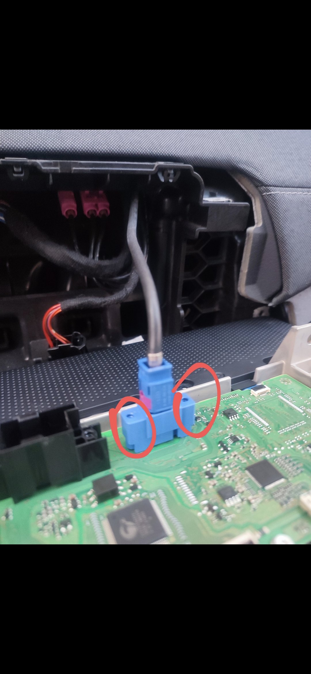

I dismantled it using these tools,
When you unplug the connection cable, make sure multimedia is open, the on button will be disabled.
Nearly there now. Just the screws around the plugs are really tight. Need to get the right screwdriver.
You said to make sure multimedia is open when unplugging the on/off button. So, do I need to leave the metal cover off, like in your picture? There is no way to have the cover on, multimedia open and still be able to access the on/off connector.
remove the vedas in these pictures, the metal protection should be released, while the power cable is connected, remove the audio socket. then check.

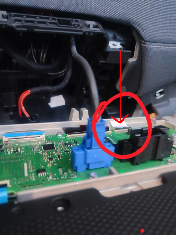

I have the ignition on and the infotainment system is also on. As soon as I disconnect the connector (marked with an arrow inside the circle), the screen goes blank. Did I miss a step?
There were also those who cut the metal protection. Those who cut the area in the picture and removed the socket. Try that and see.

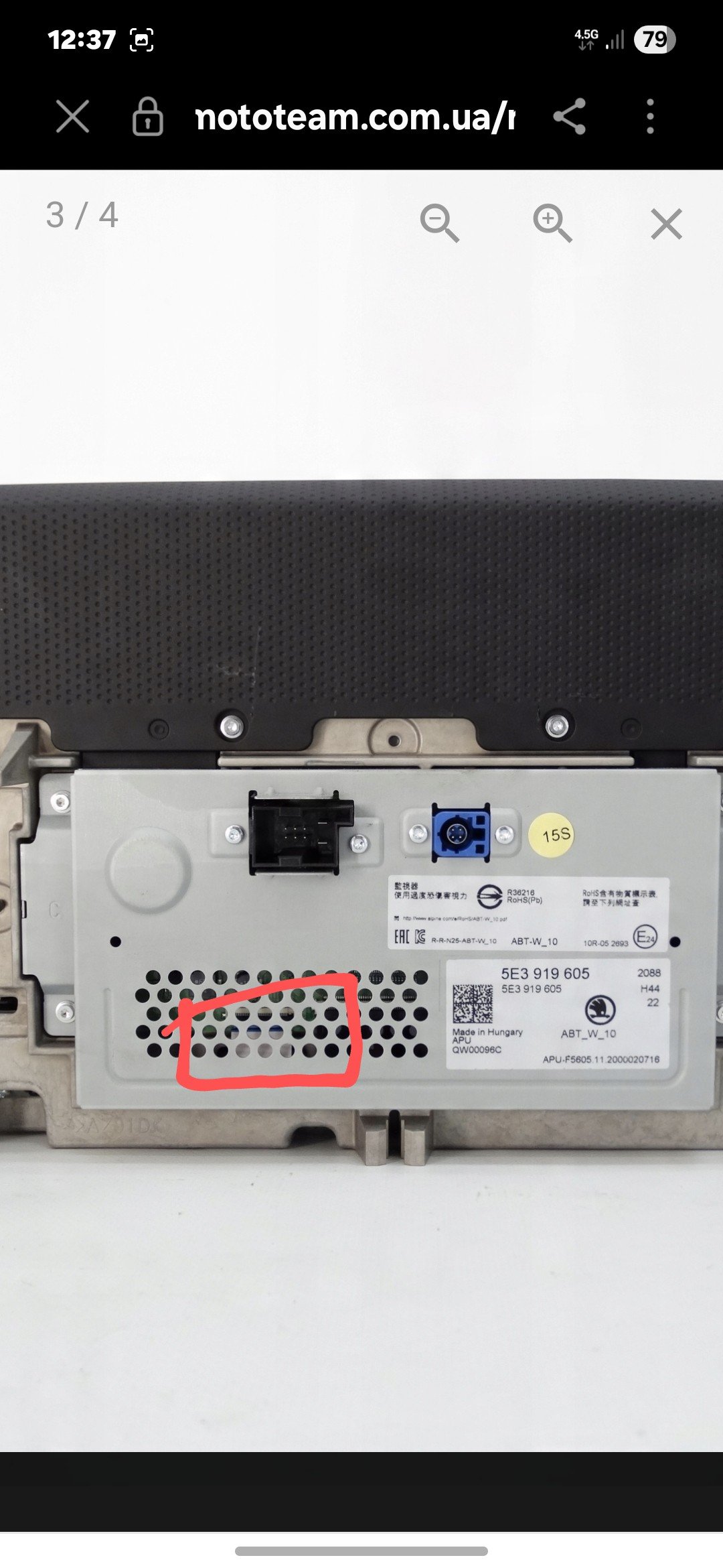

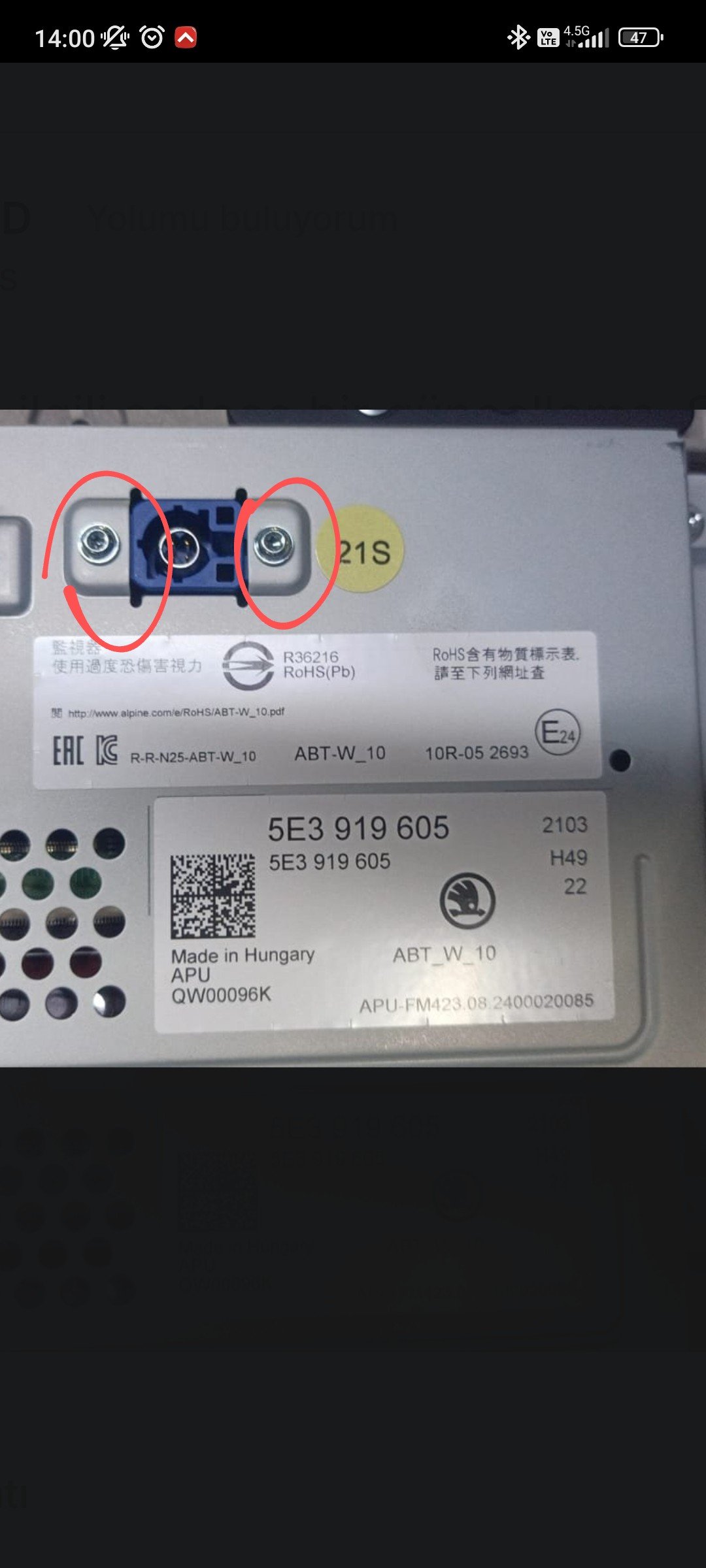

Thanks, but that's just the same connector. I see you got the picture from mototeam.com.ua. Could you please send the direct link or links? Maybe I can find some additional info.

Sorry, I don't understand what you mean. I had the blue and black plugs connected to the infotainment system. The screen was on and the radio playing. As soon as I disconnect the marked flat connector, the screen goes black.

Well, I had another go at disconnecting the flat cable as suggested earlier in this post. I had both, the black and blue plugs connected and the radio was on (not sure if the ignition was also on). I then disconnected the flat cable shown in the picture of the earlier post and this time the screen stayed on. So, when I lock the car, the screen goes off. When I unlock the car and turn the ignition on, the screen also comes on. The On/Off button underneath the screen is now inactive and so is the volume slider. The volume can still be controlled from the steering wheel. Since I never really used these (now inactive) controls, I won't miss them.
The car is now sitting in full sun on the drive and at this stage I'm quite confident that this is now finally the end of endless infotainment reboots and full volume radio when the car is locked.
Many thanks @omeromeryigit for your suggestions!
