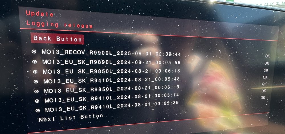

Had the same problem with phantom touch and stuff. Thought dealer changes Display but I was told there is MIB Software 1999 which will be updated. I thought 1989 was the latest Version? Tomorrow I will get the car back.

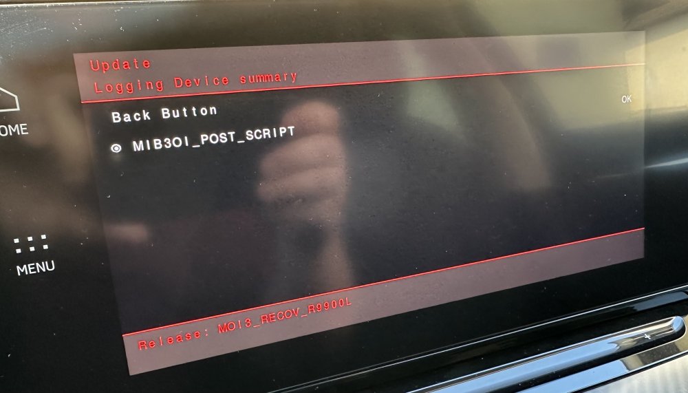

So the displayed software version didn’t change. What I can see is, in the Update Menu they tried installing a „MO13_RECOV_R9900L“ but in the log it says only Post script was done and no other components updated. So I don’t know what they did.
