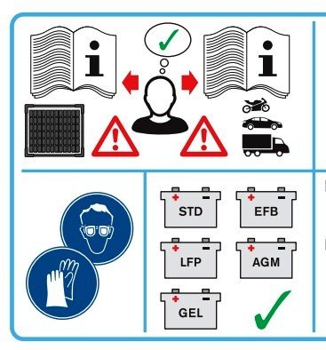

1 hour ago, Tilt said:
Can you 'solar charge' an EFB/AGM battery ??????
Yes.
Some links below, how much it can recover is very dependant on things like I've outlined previously but if the battery has been recharged previously then if the battery is in a reasonable state of charge and health and the charger isn't going against too much load of the car and some of the stuff owners/drivers leave connected when the car is not in use then at worst it will slow the drain at least a bit, or it might be able to maintain or add to existing state of charge.  As Tesco has it every little helps (unless the battery was/is too used, abused neglected already).
Auto Express - Best solar chargers for car batteries 2024 - the test is for 'fun' cars that are locked up and not used over winter (what a waste of potential fun), - "These are not designed to charge a flat battery but should help with the natural discharging and power used by alarms, dash cams and clocks."
"We also checked the conditioners would not overcharge a battery or take power out of it in darkness." - https://www.autoexpress.co.uk/exclusive/43793/best-solar-chargers-car-batteries-2024
Ring (pictorial) instruction booklet. - https://shop.ringautomotive.com/media/catalog/product/file/G15118871_UI_RING_Solar_Power_Battery_Maintainer_MiCh_WWW_02_2.pdf
Edited by nta16
