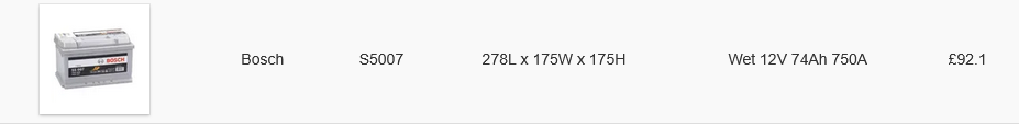

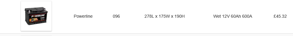

A great deal of battery problems are caused by people buying a new one and getting it wrong.
E:G car specifications may say it needs an 096 and they look for a reasonably priced one and end up with
Screenshot2025-02-13at13-04-53096CarBatteries.png.e1f053389ecef3415cd38ca051c650a8.png
Because it's "The same size" 😉 but costs less.
But they needed
Screenshot2025-02-13at13-05-16096CarBatteries.png.7bc66e71174280ad6f10c8f6f1a43ea5.png
They will both start the 2.0l diesel when new and fully charged.
But there is no way they will be as reliable as each other.
096 just means 278L x 175W x 175H which many don't realise.
