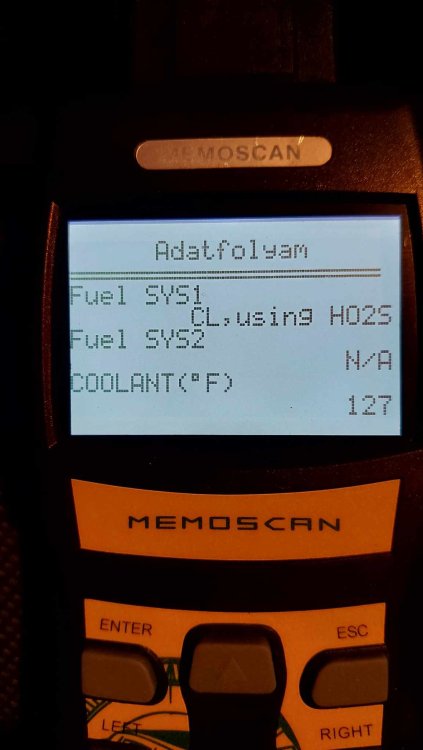

Well, I managed to read the car. Then I read that I drove 25 km with it.

From that indicated 127 f from the OBD, it does seem that the engine is running cold - unless the sensors are faulty and sending low readings to the ECU. Are you able to take a temperature reading of cylinder head with (say) an IR thermometer?
If head temperature is broadly similar to the one from the OBD, the only way I can see engine temperatures remaining as low as indicated is the thermostats remaining open all the time (or the cooling fans running constantly) - even then, the engine should eventually reach normal temperature.

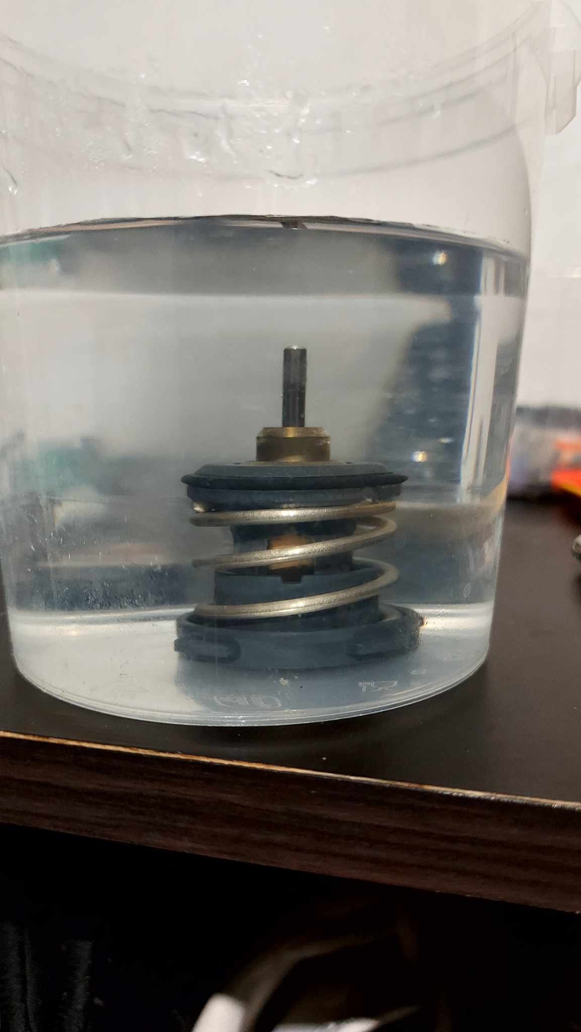

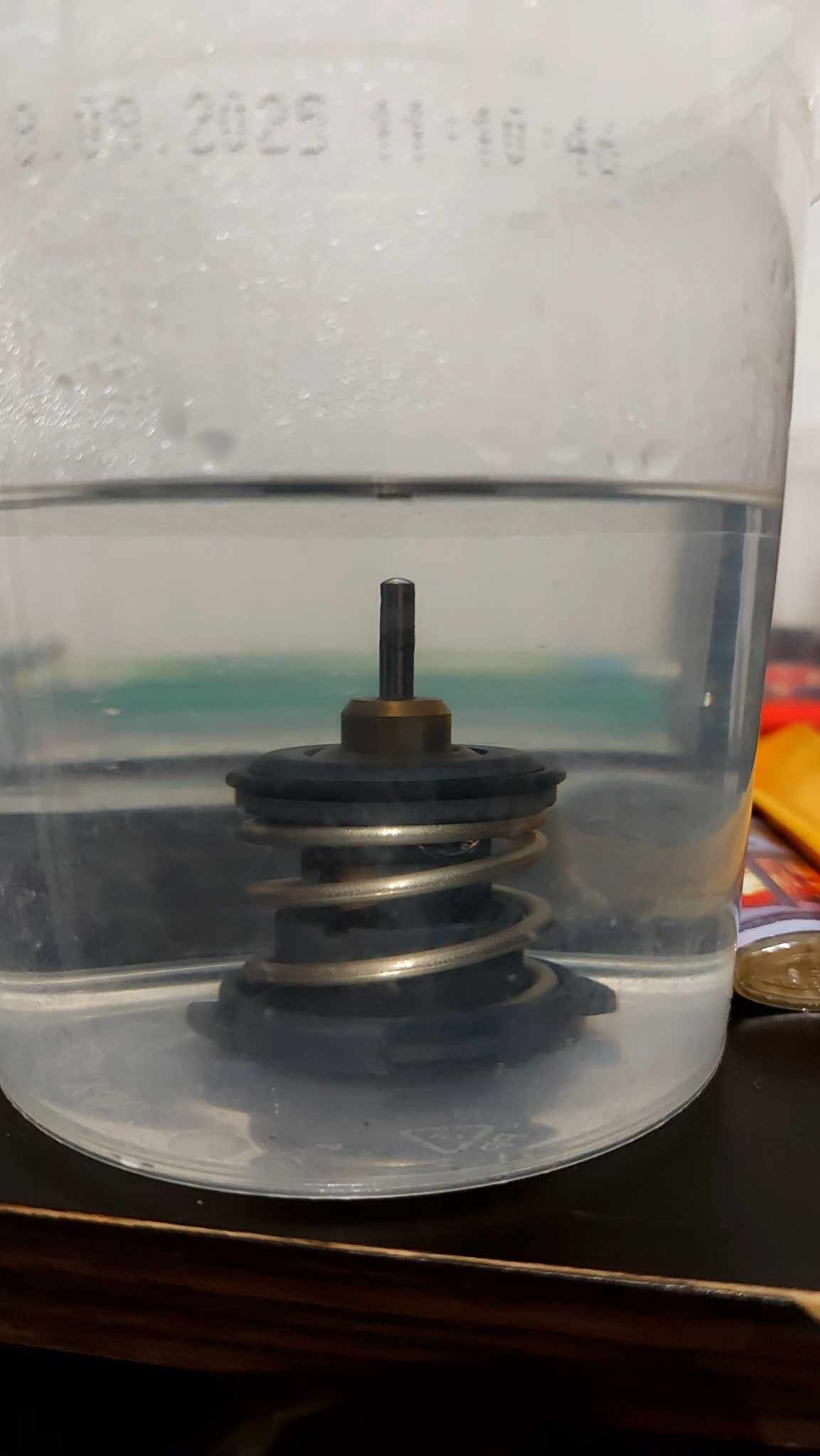

Now I looked at the old thermostats to see how they behave in hot and cold water. I'll be honest, I have no idea how it's supposed to work. I couldn't find an exact description of it. The ones we put in are not of poor quality either. One is a Behr, the other a Meyle.

The second is placed in warm water, the first picture is placed in cold water. This is the thermostat that opens at 87 degrees. The pecs came out, but nothing else moved. After the hot water, we put it in the cold water, but nothing happened.
Warm water or hot? You called it both.
You really need to bring it to the boil to see it open fully, 87° is the regulated temperature at which it will barely be open.
What is/are "pecs"? A typo?

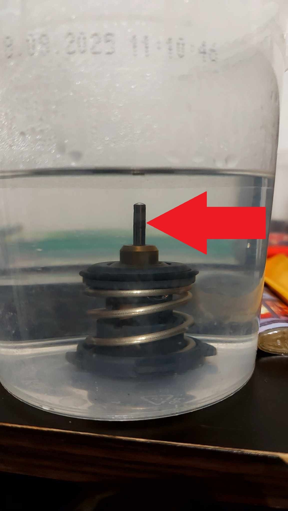

We put it in boiling water. Under "Pecs" I feel the little metal rod sticking out of the top. It should slide out with the heat, right?

I am struggling to follow your somewhat incoherent postings.
The two photographs, are they of the same thermostat or the two different types?
Are they first one cold second one hot, warm, or boiling?
Both photos look exactly the same and look to me like the fully open position, I think I can see wear marks that witness that. So if one was taken in cold water and the other in hot water then the thermostat is jammed open.
Even more confusing, was the cold water photo taken before or after it was placed and photographed in hot/boiling water?
The thermostat should have retracted fairly quickly going from boiling to cold water.

Okey, sorry.
In both pictures, it's the same 87-degree thermostat. First, I put it in boiling water. Then the metal pin at the top came out. You could see it moving outwards. Then I put it in cold water, but nothing happened, it didn't move. Here, it was already suspicious that it wasn't working properly. I've now found a video explaining how the thermostat works, so that's clear. I replaced it with another one, a Bher brand, but nothing changed. Then the internal thermostat, which is behind the water pump, was also replaced with a Meyle brand, but no change, the water temperature still shows 50 degrees. It would be strange if the new thermostats were exactly the same bad. There is no error code. All I can do is open the thermostat again and test the new ones in boiling water. (By the way, if you hover your mouse over the image, it will display the link address at the bottom left or right and say "hot.jpg" or "cold.jpg". It would have been better if I could put the images side by side, but that's how it works.)
