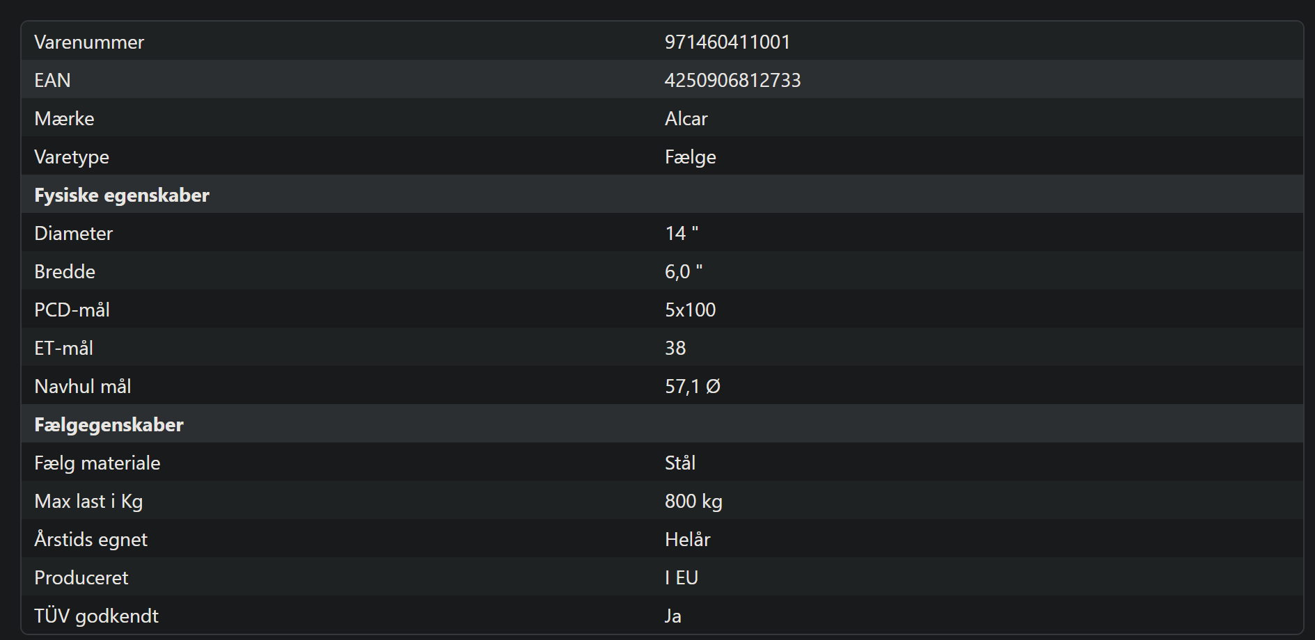

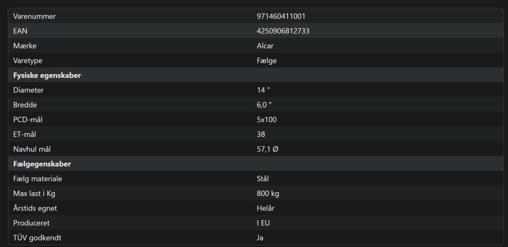

Is this the Alcar you're talking about?
The specification of that steel rim is 6Jx14 ET38 5/100 57.1 which is different from 5Jx14 ET35 5/100 57.1, ie. 1" difference in the rim width and 3mm difference in the offset...plus the appearance is different...which you can see from the photos below.
