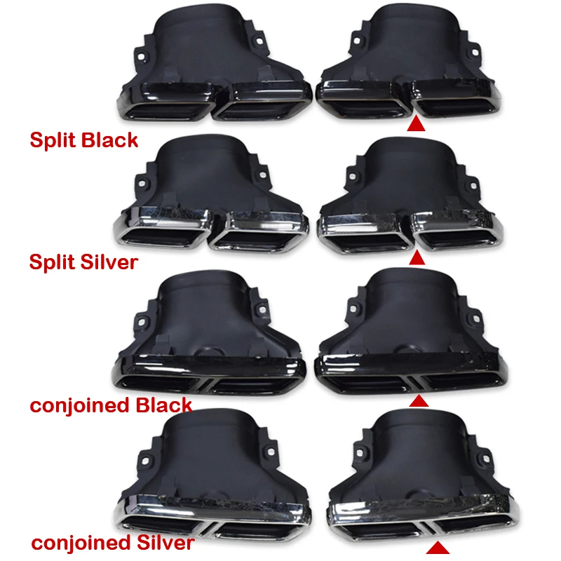

15 hours ago, MartiniB said:
@travs
"split silver" looks exactly same as i installed
-> https://www.aliexpress.com/item/1005009340362950.html
I’ve done a lot of looking and comparing. These look too square and not like yours which seem to compliment the inner angle of the cutout.
No criticism, I’m just being picky and will keep looking…
