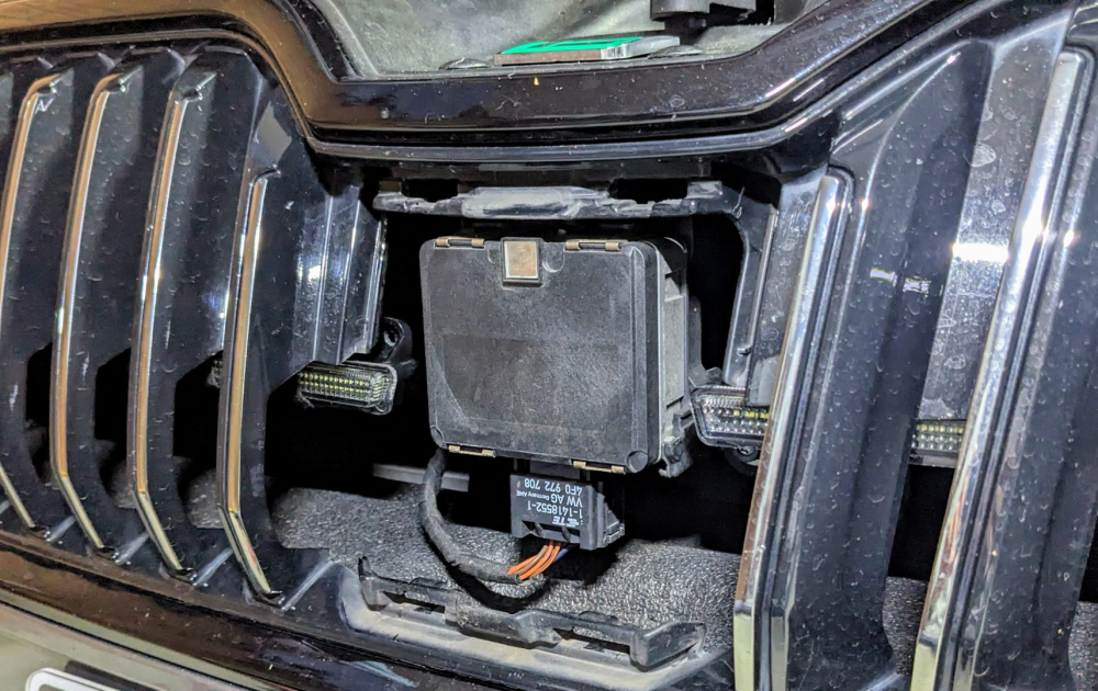

ok guys i found out that after I opened the rader panel. my radar is not in his place, it is TOTALLY LOOSE.
Like I can take it out fully, and it isn't like in this picture

Perhaps it has just unseated itself from the mounting bracket and needs pushing back in place, or maybe the mounting bracket needs replacing as they have been known to fail, same thing here on a Kodiaq

A few years ago, I had the same problem of "Front Assist Unavailable" appearing on the dash. It turned out to be a broken bracket holding the radar unit in place.

yes i took the grill off and dismantled the front grill the brackets are broken i sorted the brackets with large tie wraps put it all back together
