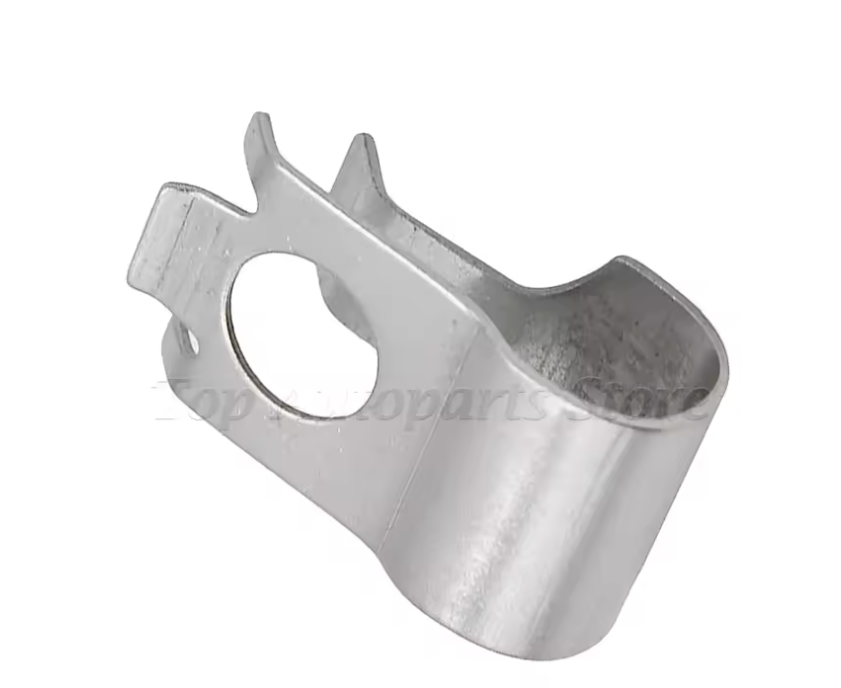

the turbine actuator lever on the axles has air for sure, it can rattle like that, there are fuses that secure it so it doesn't rattle.
