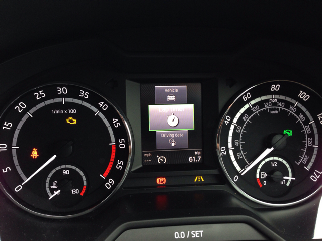

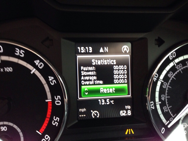

Where is the option to code the laptop timer? Do you know what the coding is thanks
Go into lthe long coding on module 17 (Instruments) - can't remember which byte & bit, but it is a documented one in the latest version of VCDS.
Haven't tried it though, can't see the point for me.

Lap timer enabled via vcds works thanks andyvee
