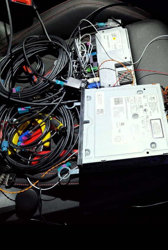

Columbus MIB2 CarPlay/Bluetooth/Satnav not working
Which SW Number?
Mib 2?

Jamming on Superb 3 FL Infotainment System Amundsen
I know that iOS Firmware have also problem with actual iOS
System Lost the FeC Codes. Bluetooth, Navigation, Android Auto etc etc ist Software prodect function
Update Firmware 0480
MIB 2 or 3?
