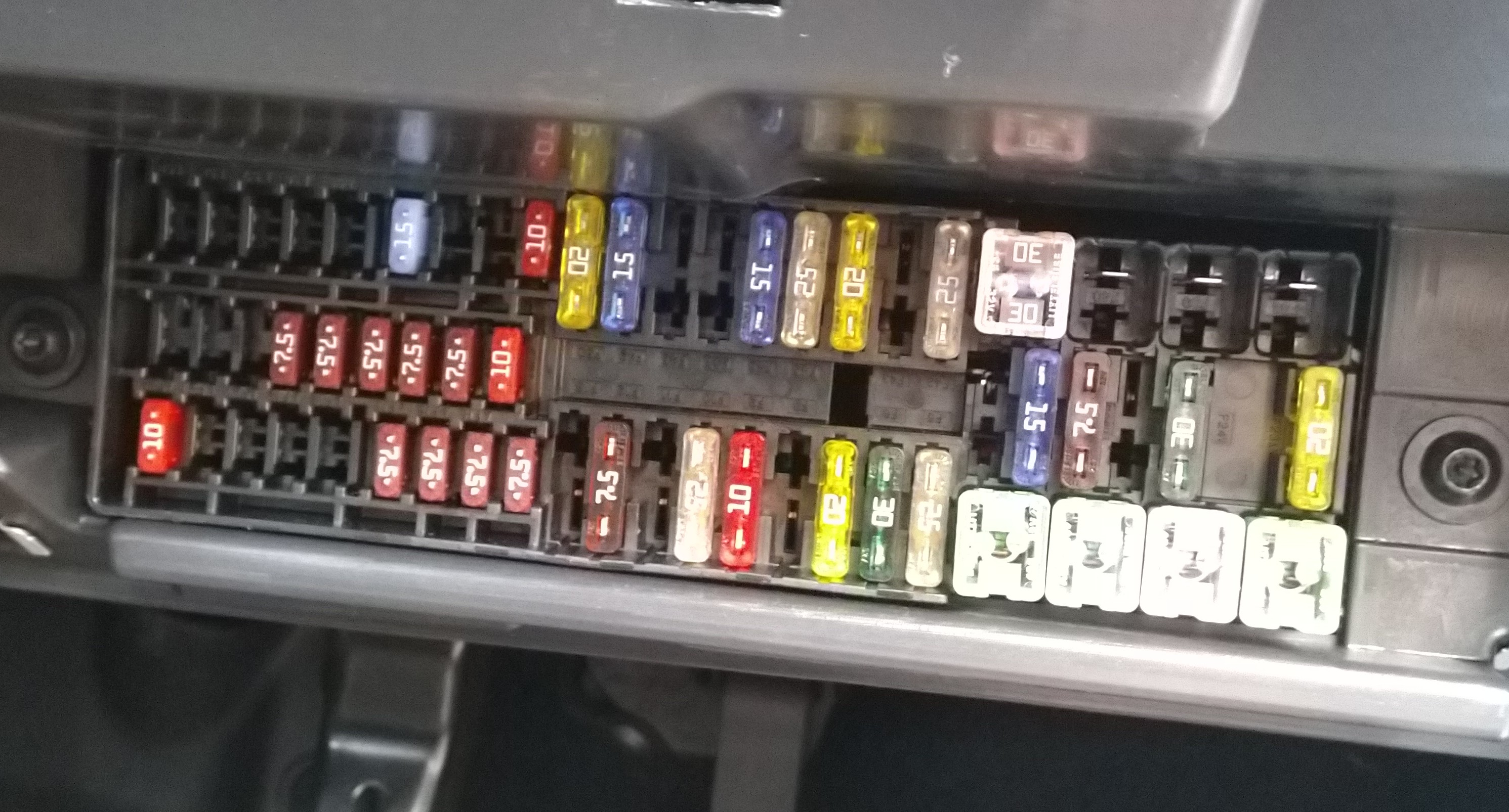

  20. This panel is just in front of your knees, not too obvious, and will require a sharp tug to get the cover off. Fan is 24.
  21. This is the fuse panel from a 2018 1.0 SE Tech. I would say your feed needs to plug back in to the bottom row, 2nd position in from the left. If the fuse protecting the car circuit is 7.5A then that's confirmation. This is marked as infotainment screen in the handbook. Who knows if this will fix your issues? Other suspects are 15 (A/C) (2nd from right on lower minifuses), 24 (blower for A/C) (5th from left on right hand middle row between the square fuses), not 31 - (this is also fuel pump so the car won't run). Finally - not impossible the previous owner just stuck it in a switched live socket that worked for him. But that wouldn't explain your other faults.
