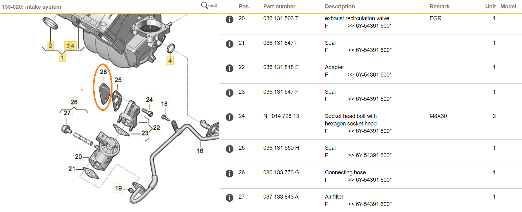

Items 20/21 here, I think: LLLParts They tend to need a socket extension to reach easily from the top, and try not to drop screw or bracket once loose.
