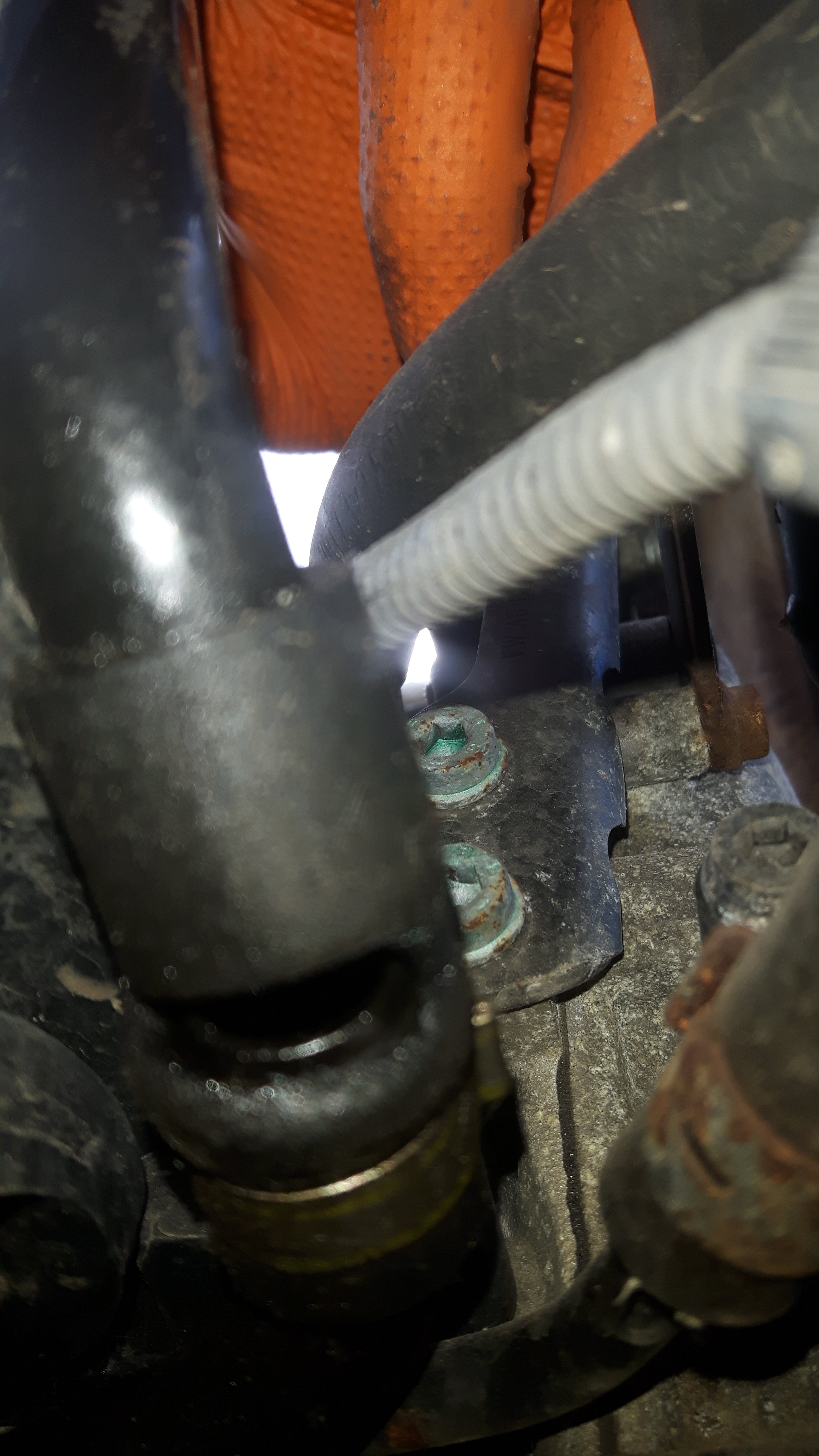

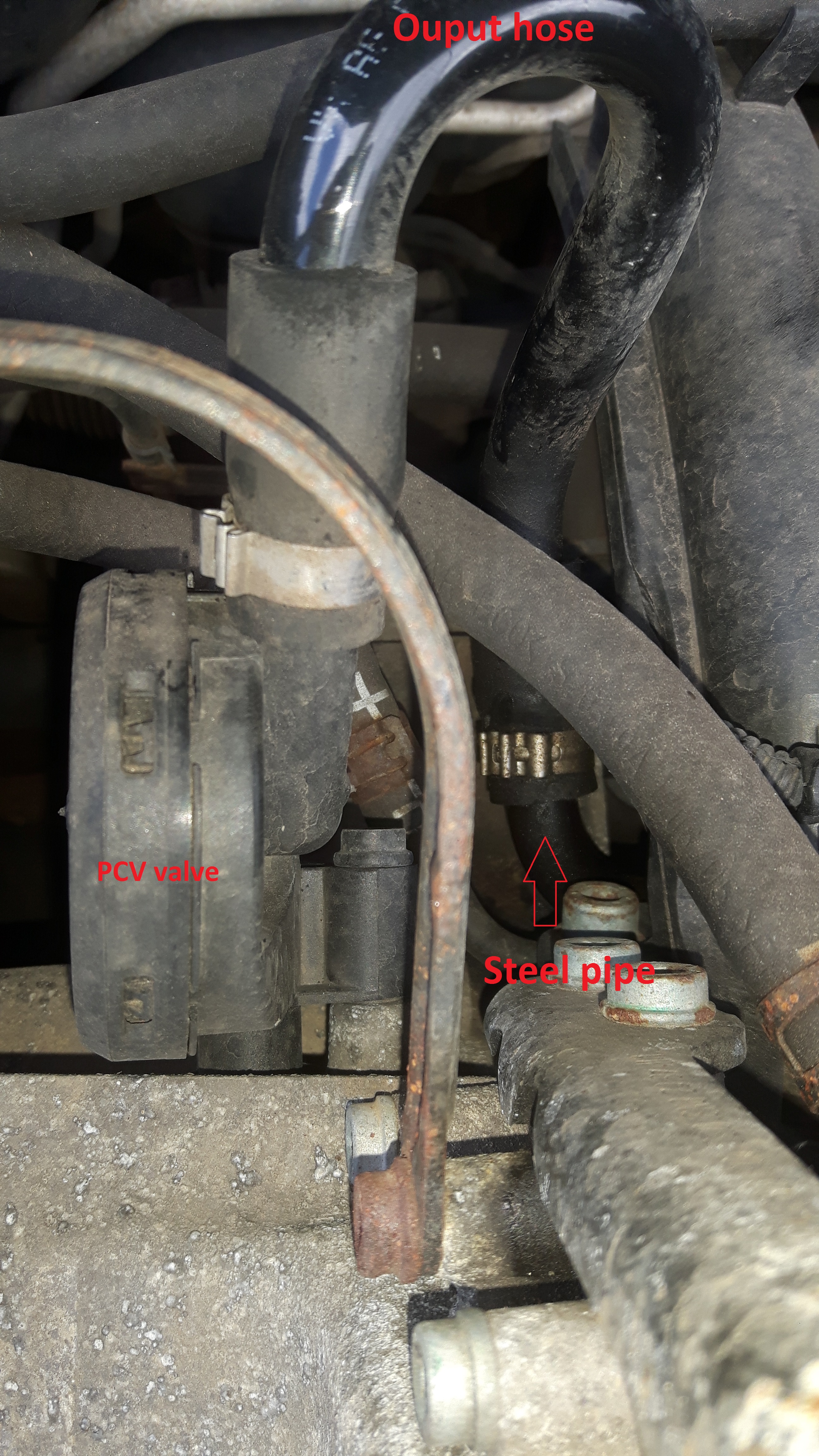

  2. Exhaust leak would probably have been the flexi section of the front part, beyond both oxygen sensors, so unlikely to be relevant. Dead batteries can cause fault codes fairly randomly, clear the codes and see what returns. Check that your battery light illuminates at ignition on, and goes out after engine start. Photo of a very badly deteriorated brake servo hose, check especially the underside/unsighted sides with fingertips or phone camera: Photos of a very leaky PCV output hose (from above to orientate you, then below showing the hole in the rubber plastic-to-steel pipe joining section): Both faults probably rather common, especially the servo hose one.
  3. 50mpg is not going to happen as a fill-to-fill calculated average, be happy if you get over 40. The claimed economy of the 3-cylinder engines is well above reality. For the lean error code, and maybe the oxygen sensor one, you need to carefully inspect pipework at the back of the engine head for leaks. The brake servo vacuum hose and the output hose of the PCV valve are hot favourites. Photos tomorrow if no-one beats me to it. Idle wandering is very likely being caused by this. Cam sensor code may be the sensor itself, a neighbour with the same engine, same fault code in a Polo has just this week got rid of the fault light with a sensor replacement. I won't be certain it's really fixed for a week or three of fault free running though. Window motors on the later mk1s can be pretty flaky, lots of threads on here about them. You'll be lucky if it's a cheap easy fix.
