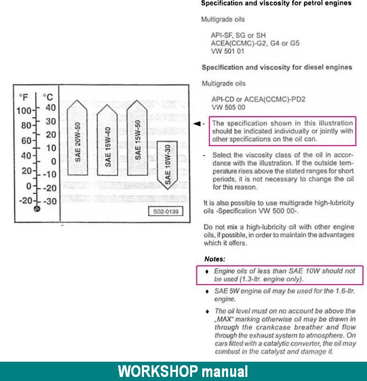

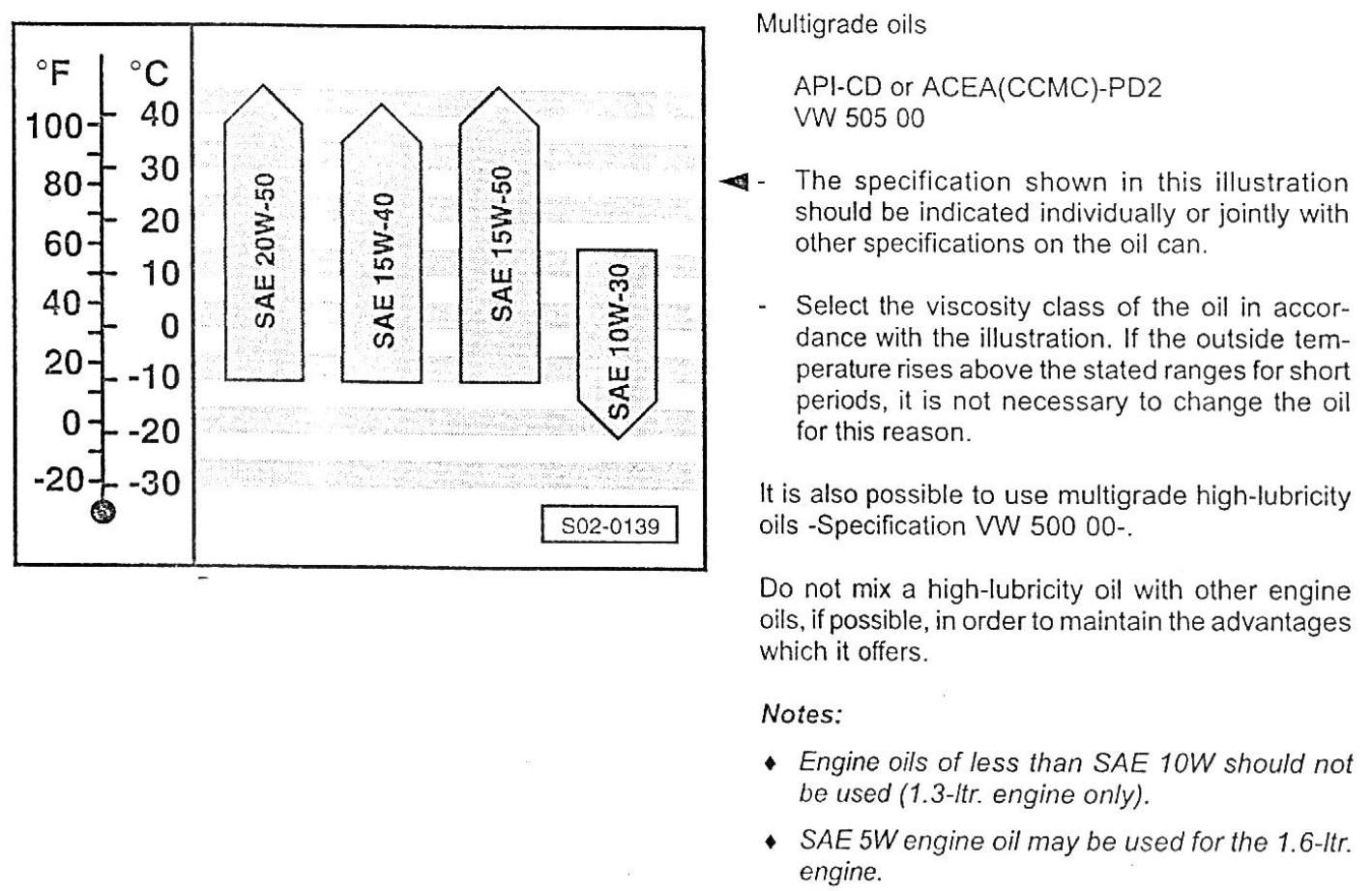

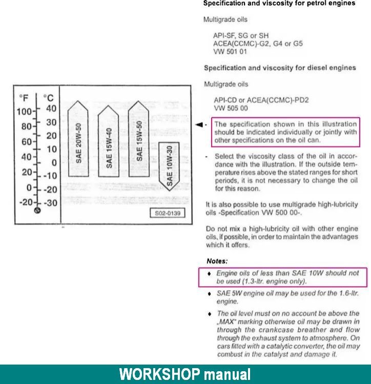

Ricardo I think the service manual is an older revision than the owners manual my manual is 98MY and has the same graph as you posted but the workshop manual I have which has the same graphs as yours is of 94 so maybe they re tested and validated more viscosities?
How look that they have the same behaviour in the same 'C scale?
A is for 1.6
4 hours ago, Thefeliciahacker said:
A is for 1.6
Then B is for 1.3
According to the green colour chart (W.Manual) 10W-30 and 10W-40 have the same characteristics, you believe it?

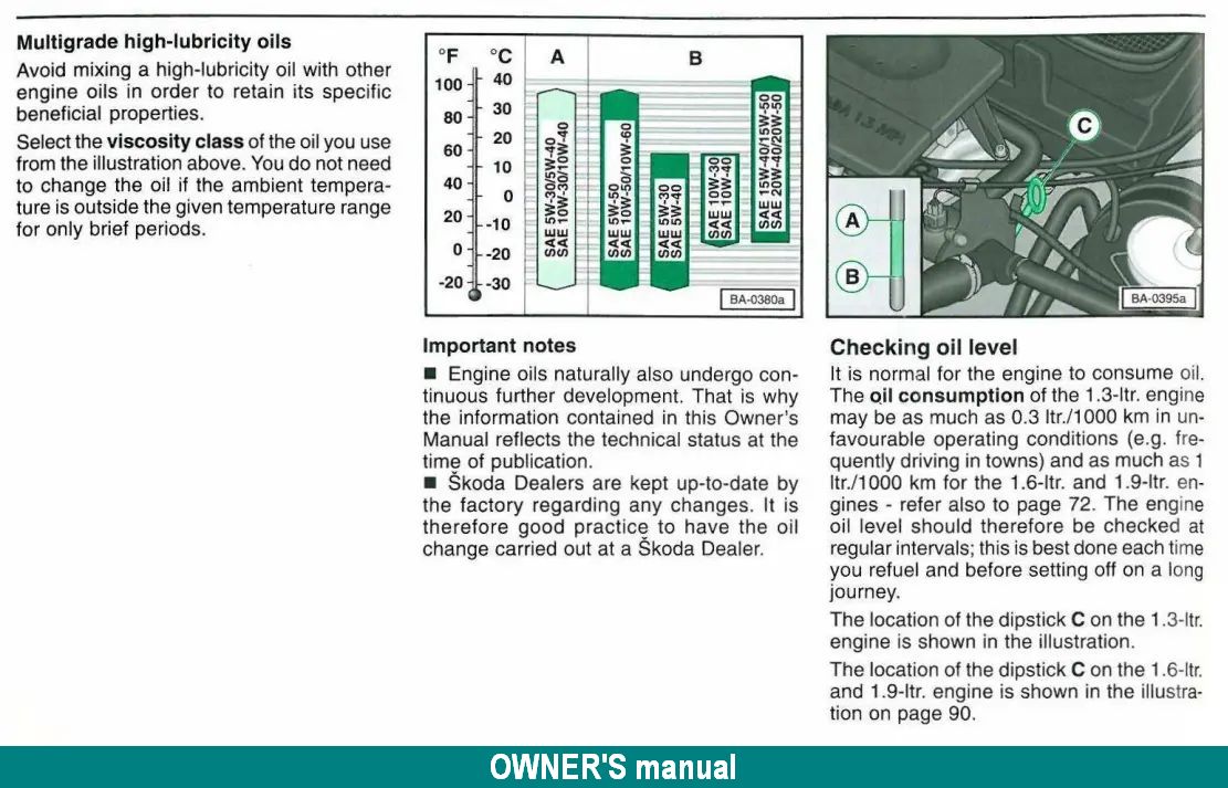

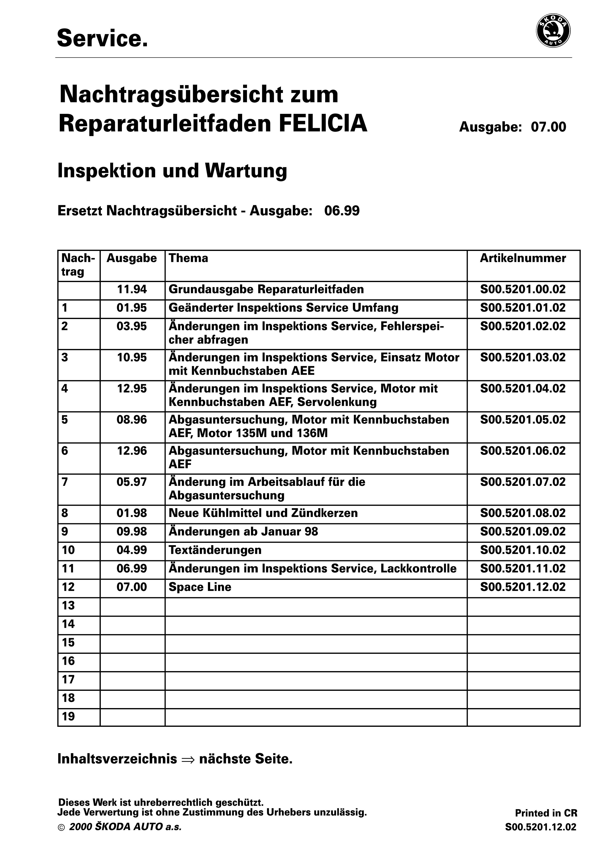

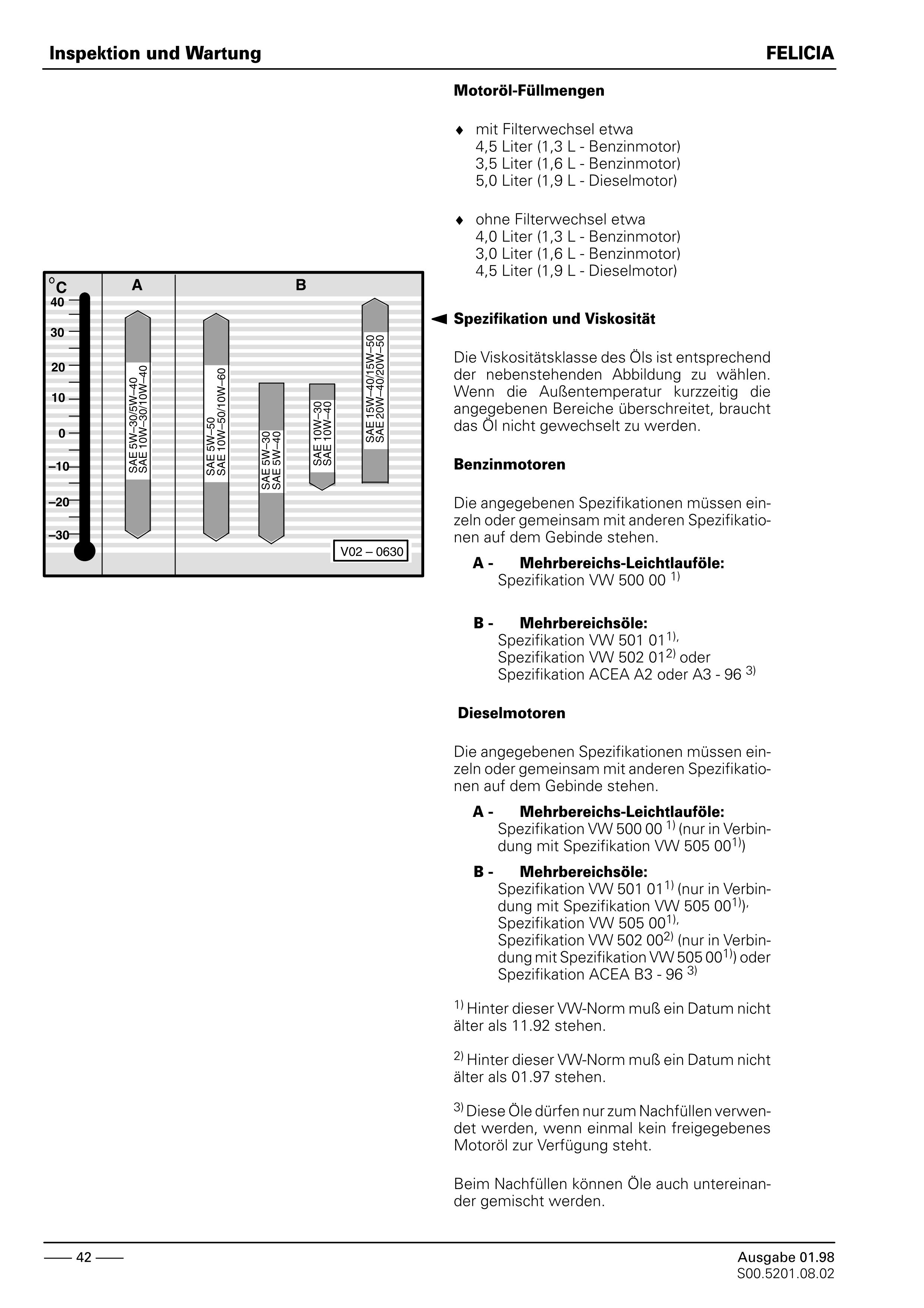

The newest Felicia Workshop Manual is dating from July 2000. It is the German edition.
I have attached the editions update page and also the page about engine oil.
So as I was guessing, the updated tables are the ones found in the owners manual as well.
So it seems that many more oil can be run but 10w40 is a no go for more than 20c environmental temp
