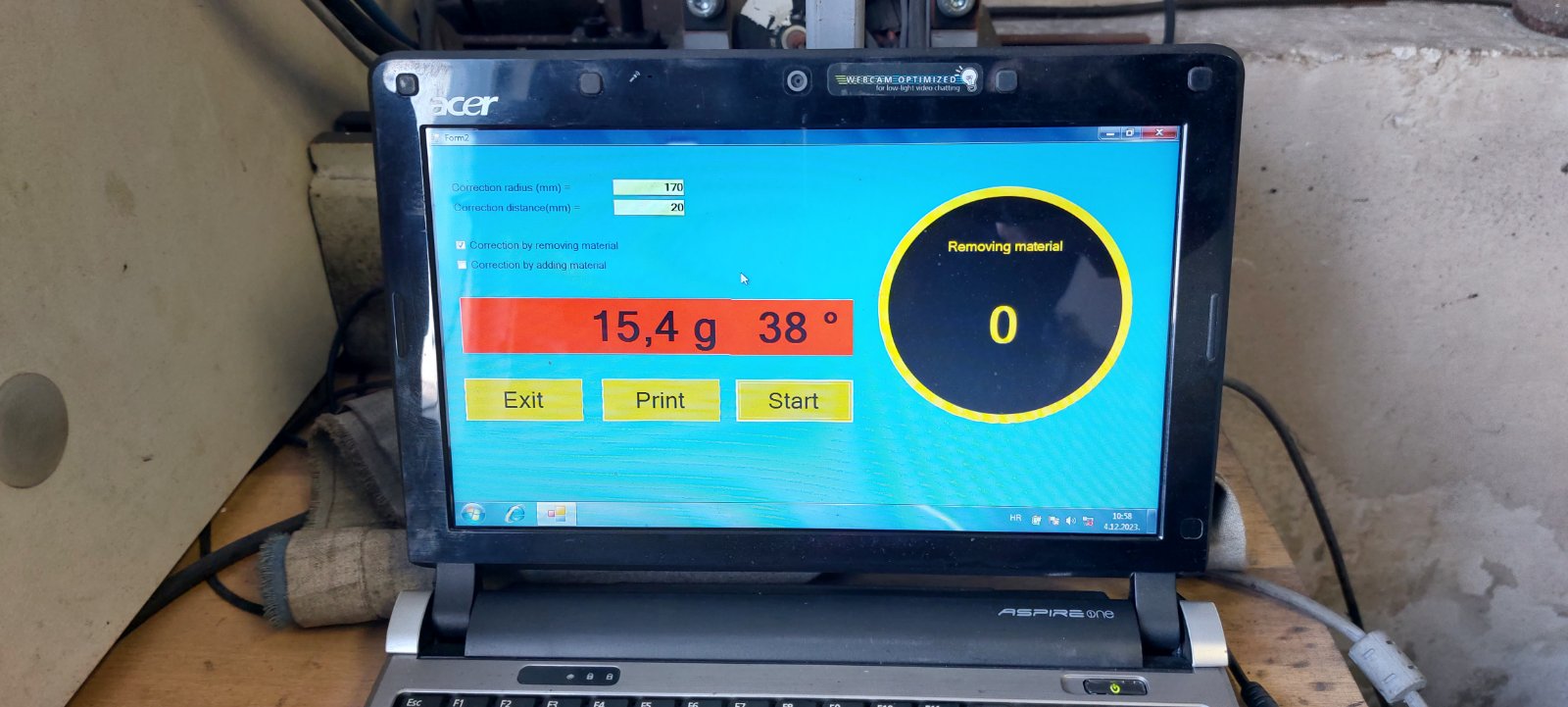

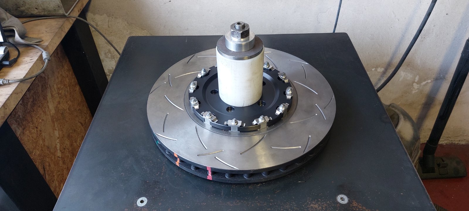

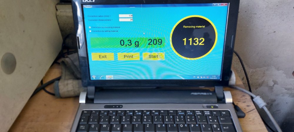

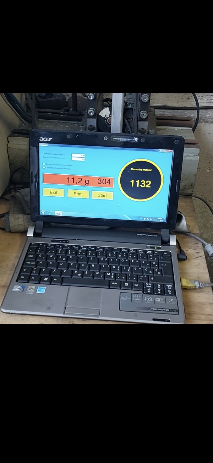

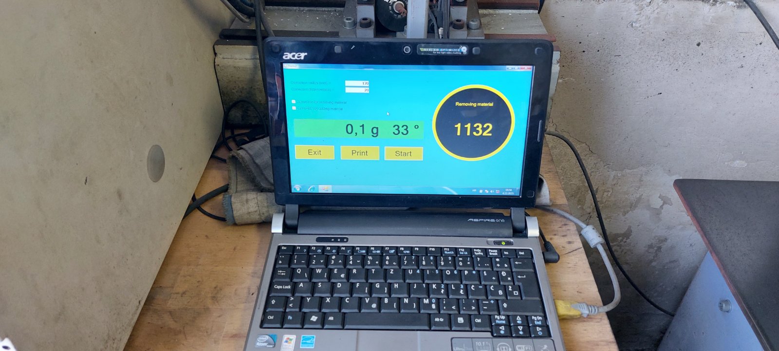

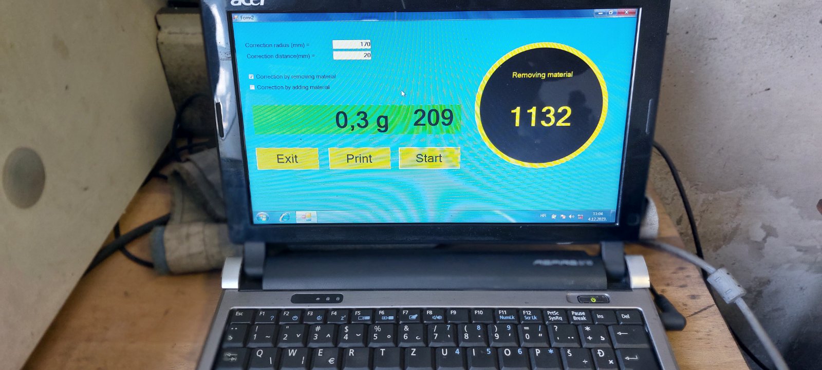

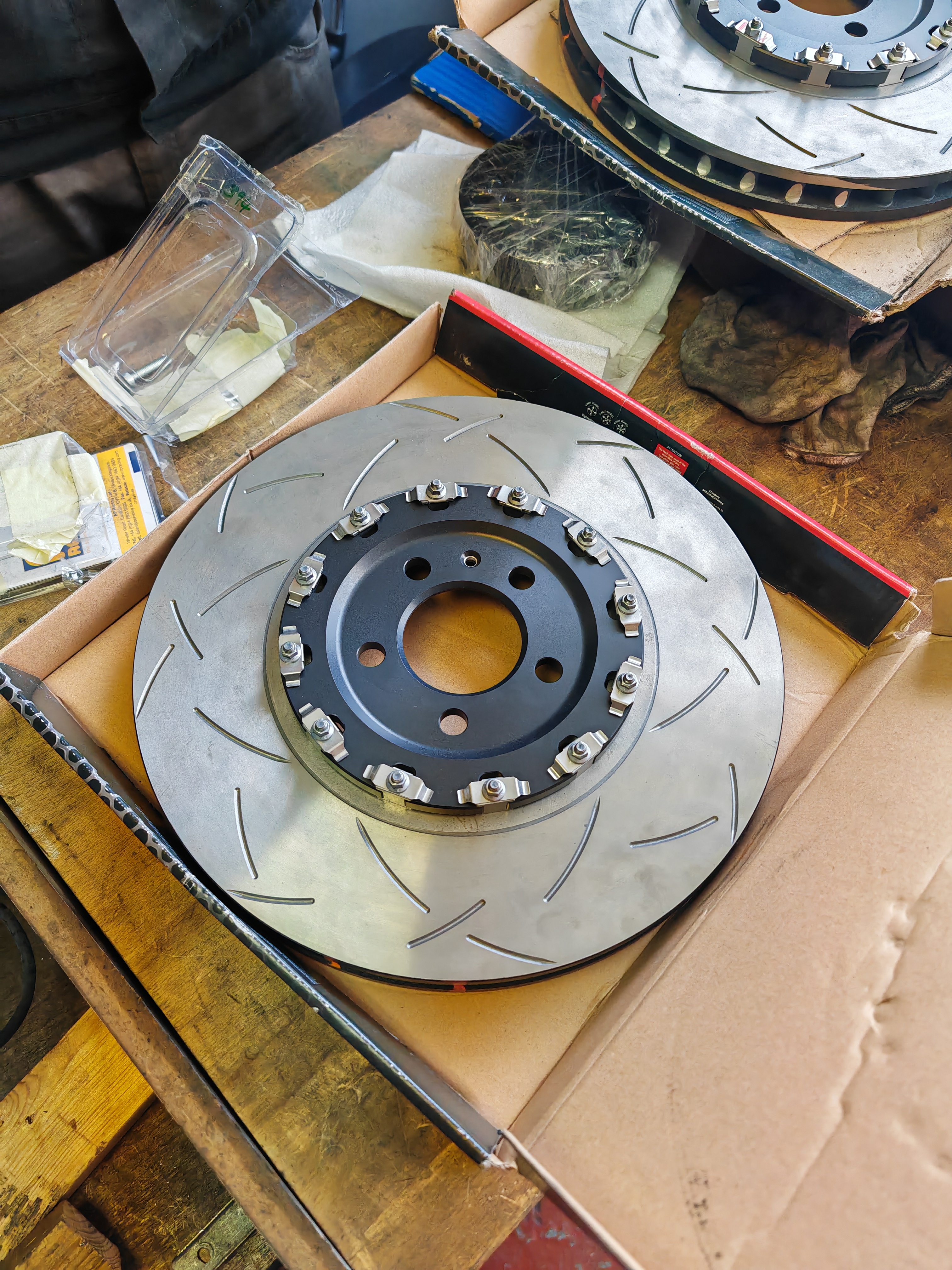

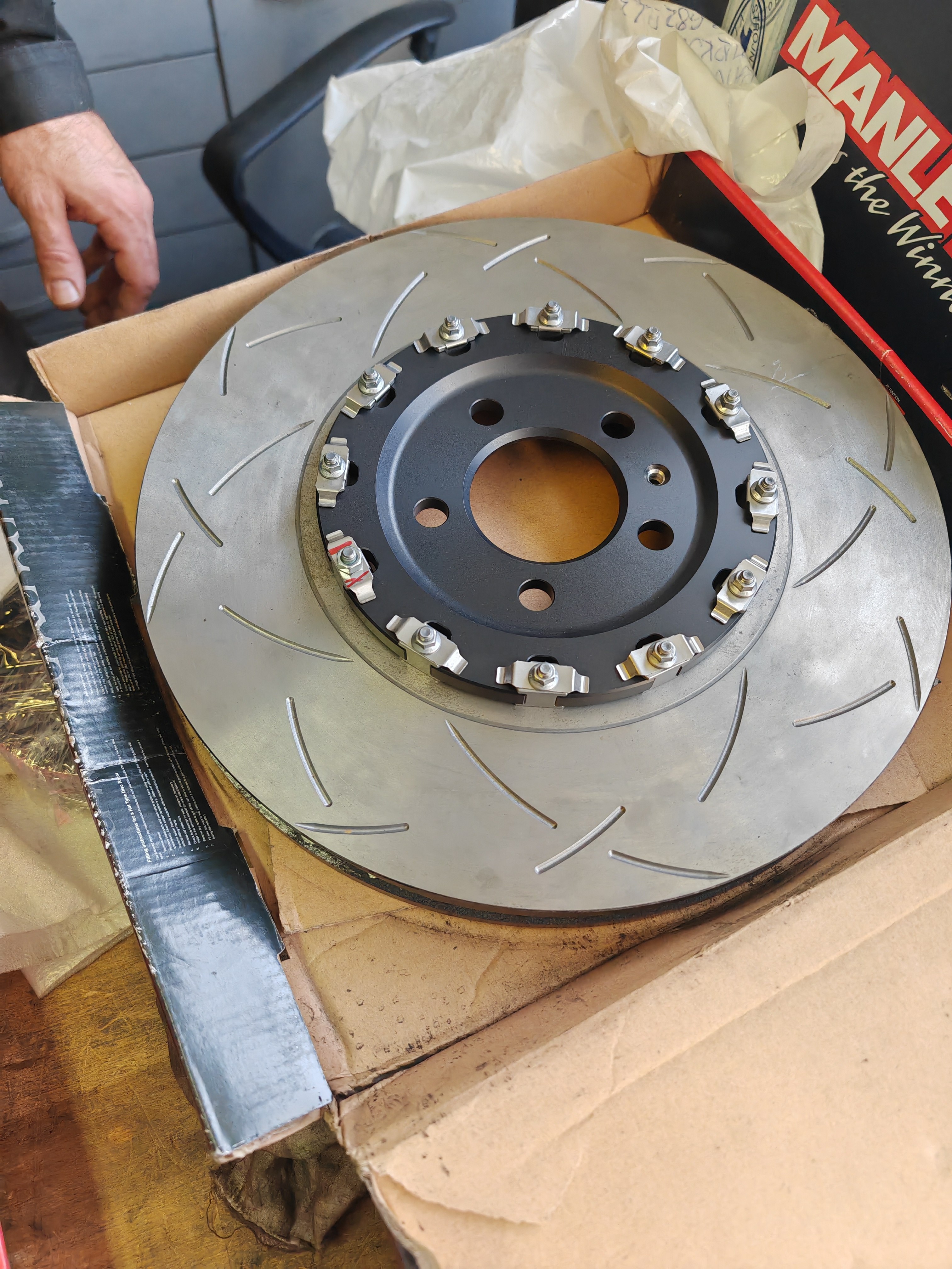

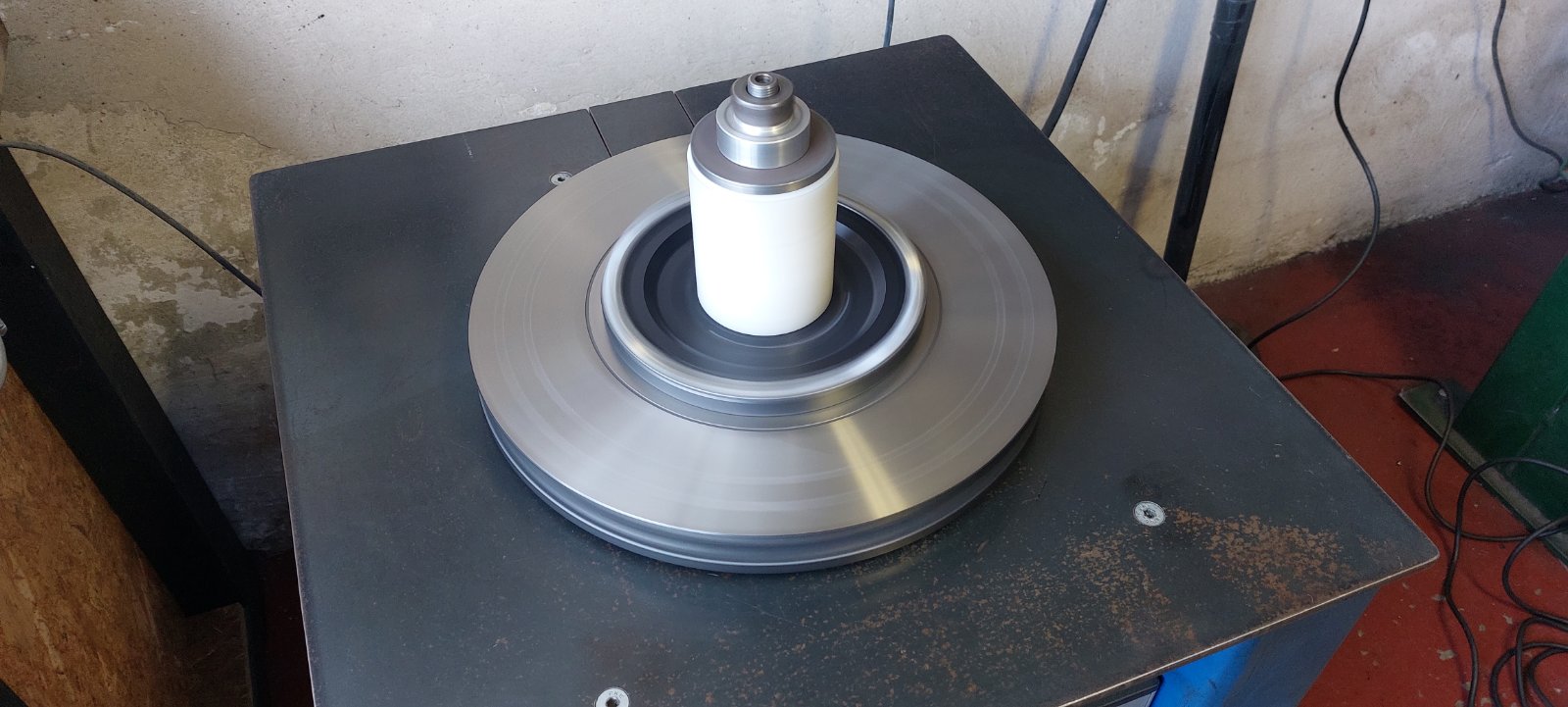

Picked up my custom 2 piece fully floating (axial and radila) discs from balancing. Even factory balanced discs when they are put together with hats they were 13 and 15g out of balance,and now after race balancing 0,1g and 0,3g. Top Job by www.elmet.hr
The balanced part will be protected  with industrial primer and 2k acrylic paint for rust protection

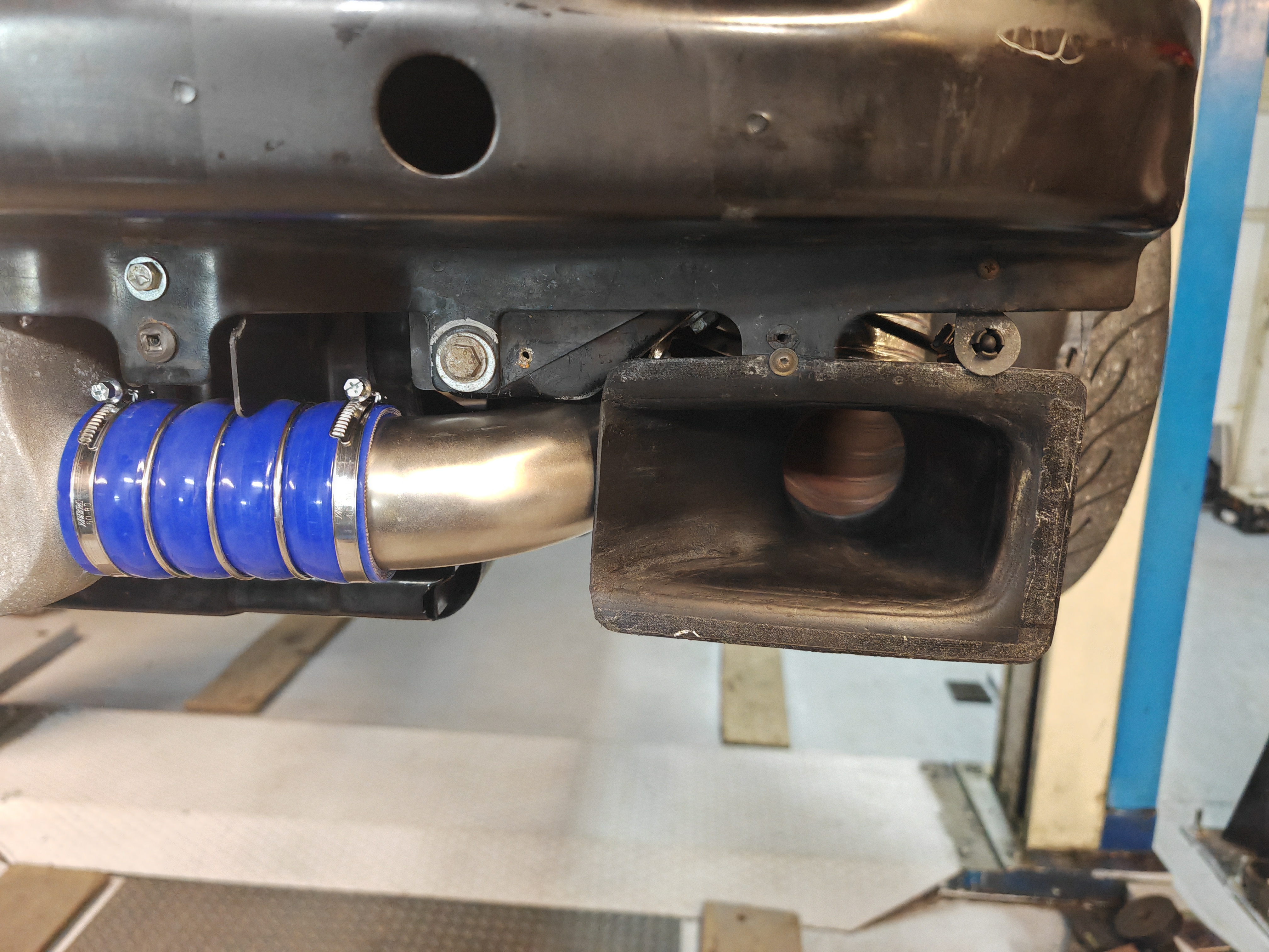

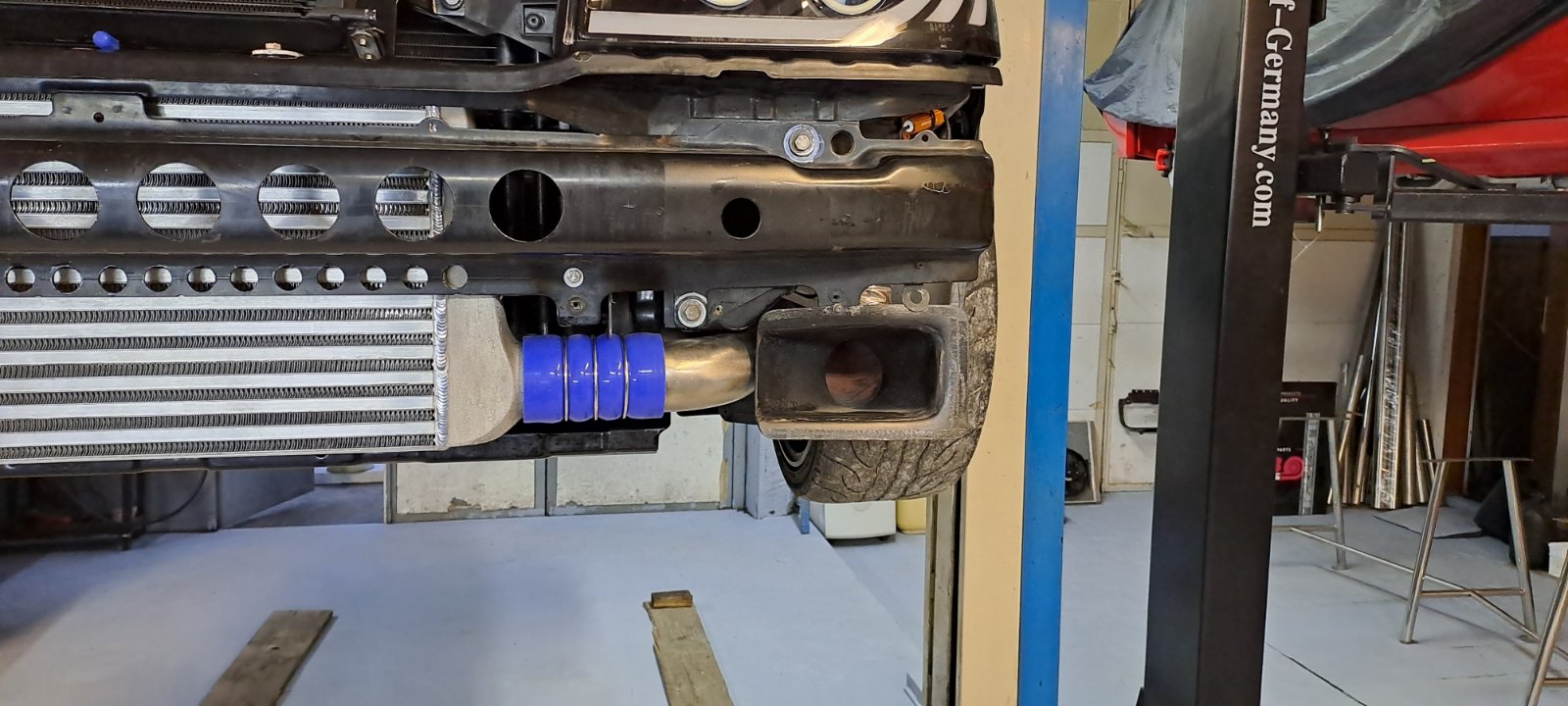

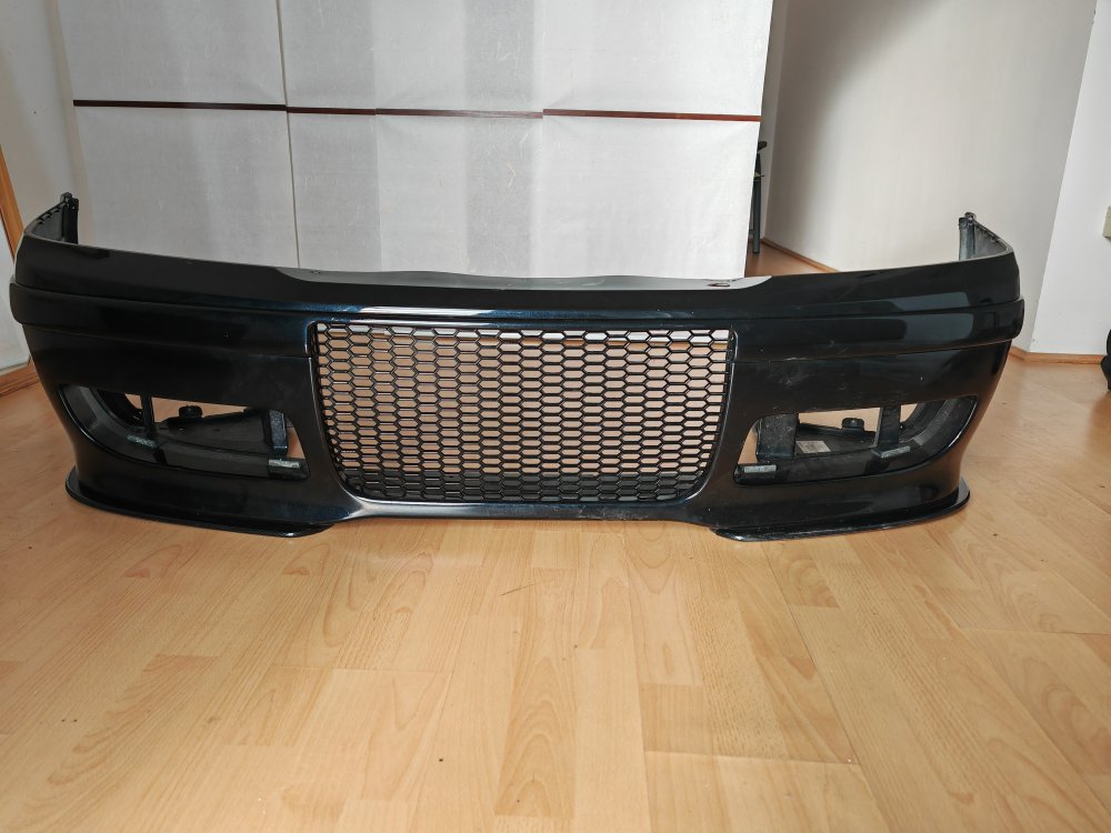

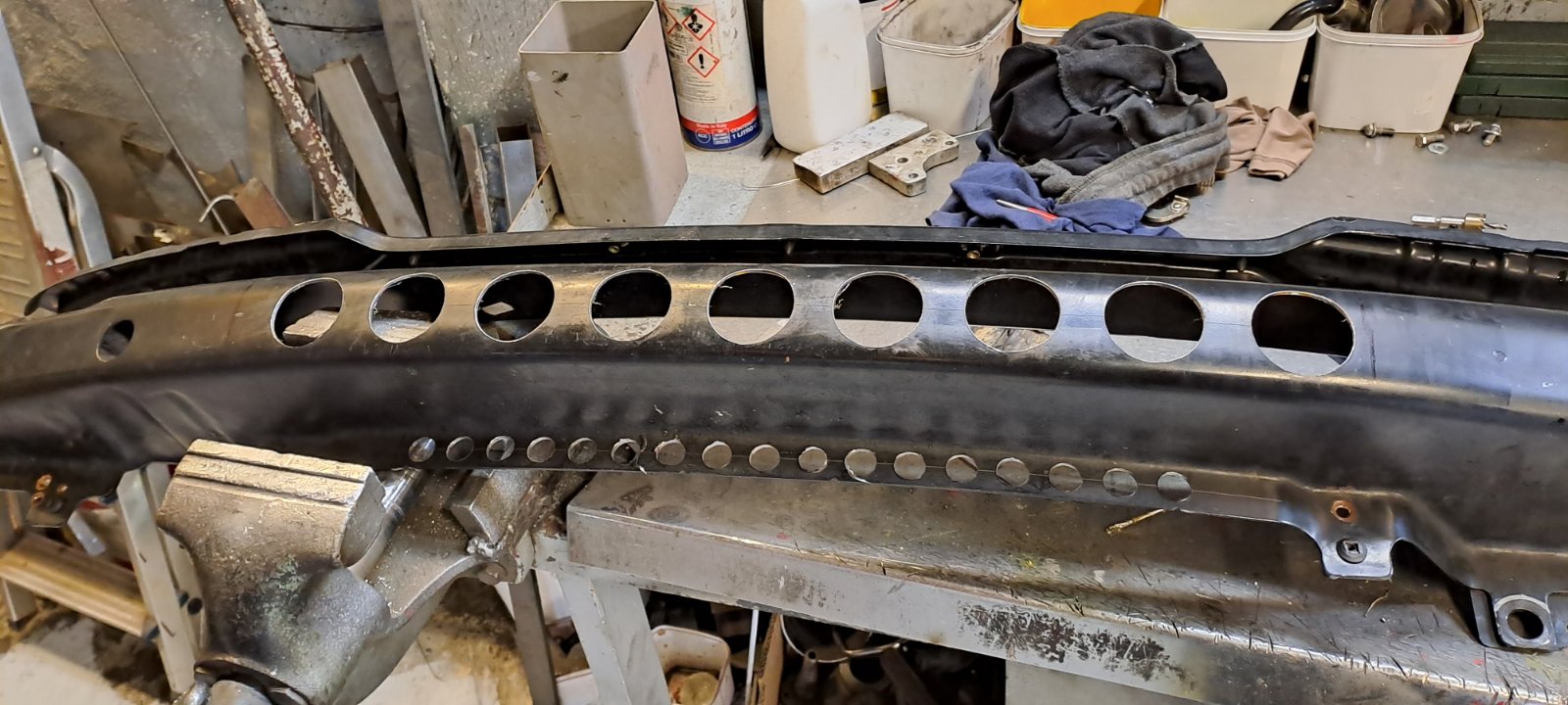

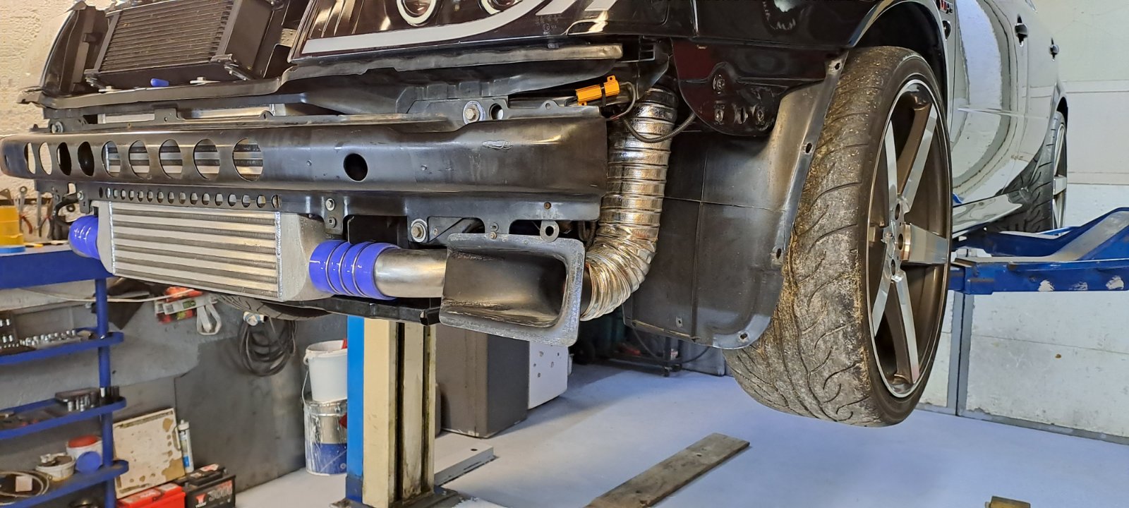

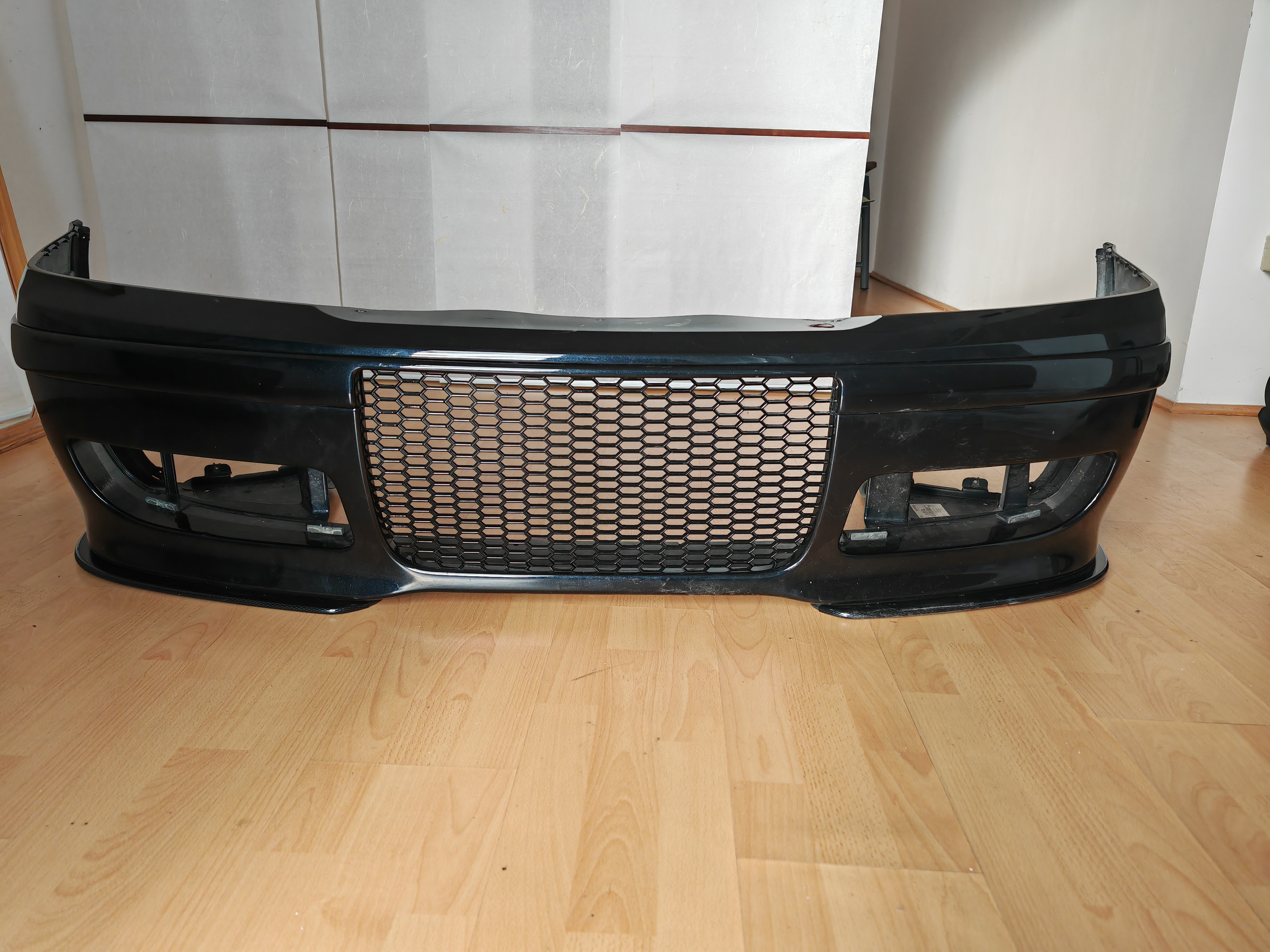

Bumper is cut, and 35x19mm mesh glued in place, looking great💪💪💪
what you doing with the milotec grills?
Side ones will remain, just venter one is removed for obvious reason-replaced with taller one

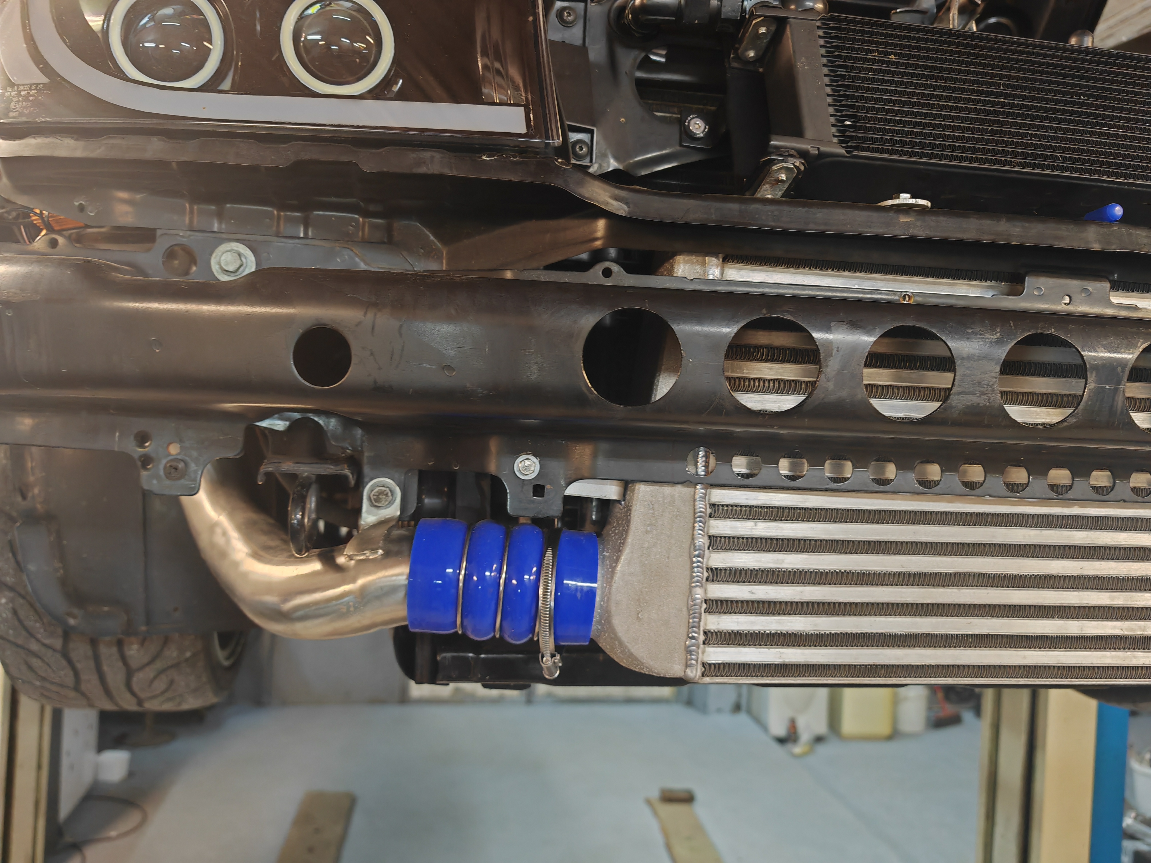

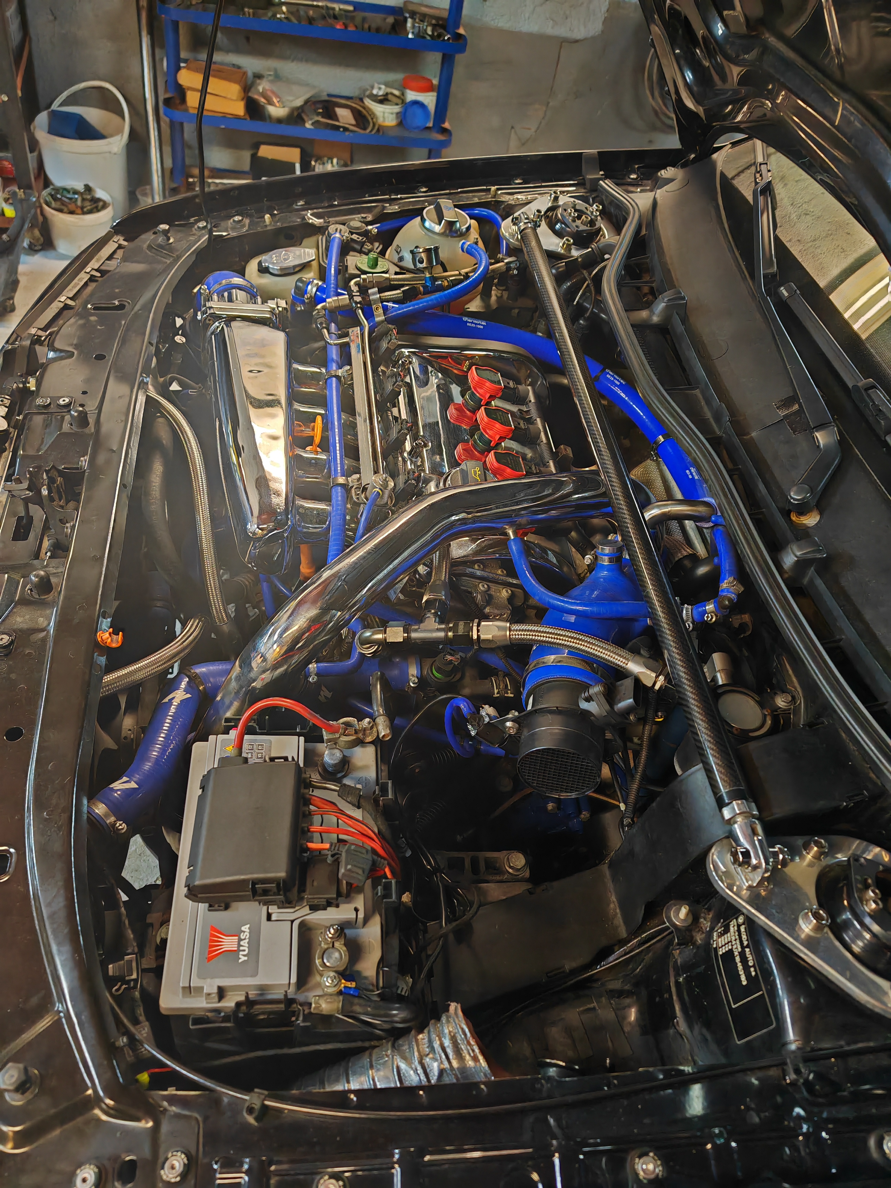

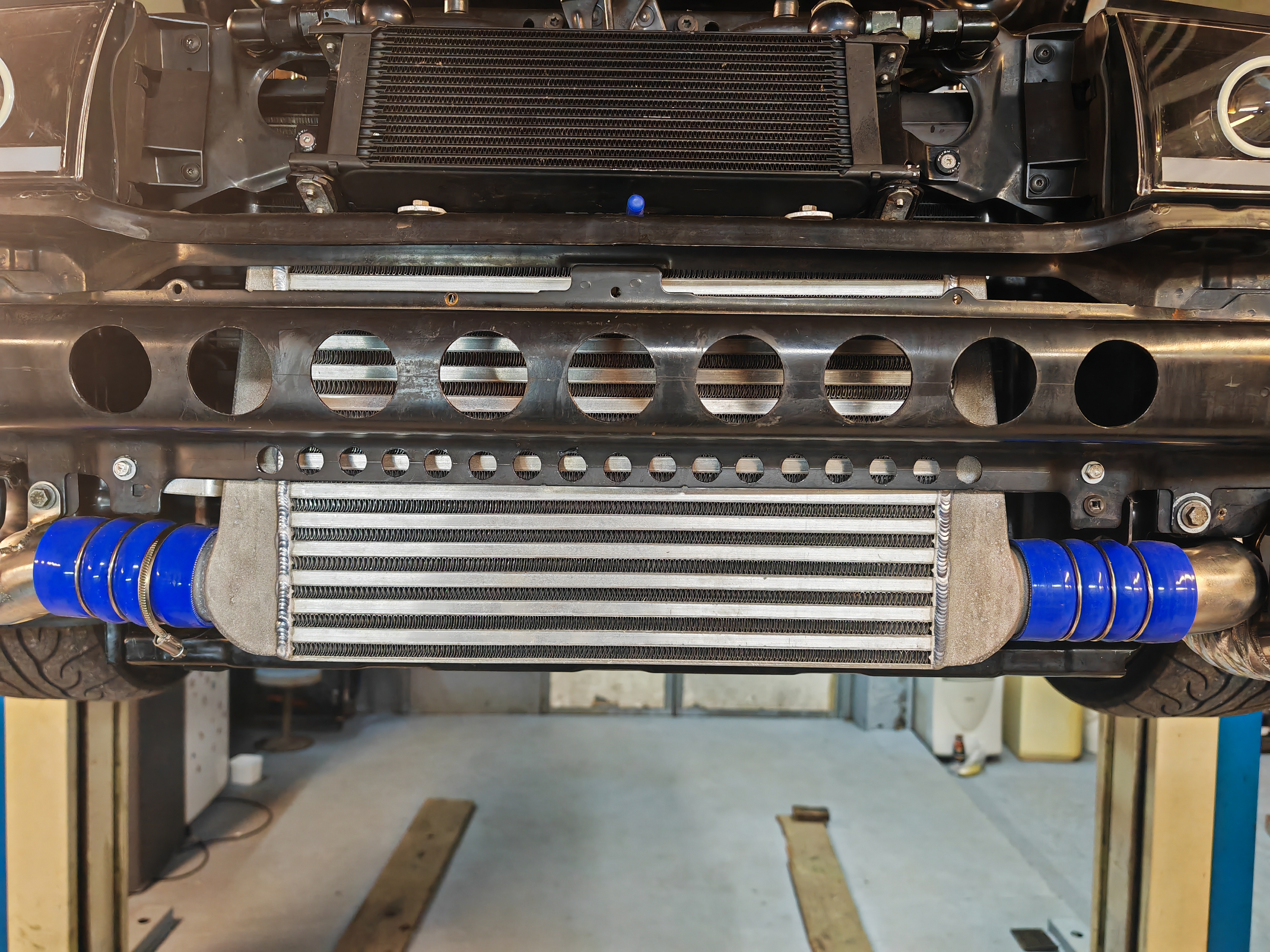

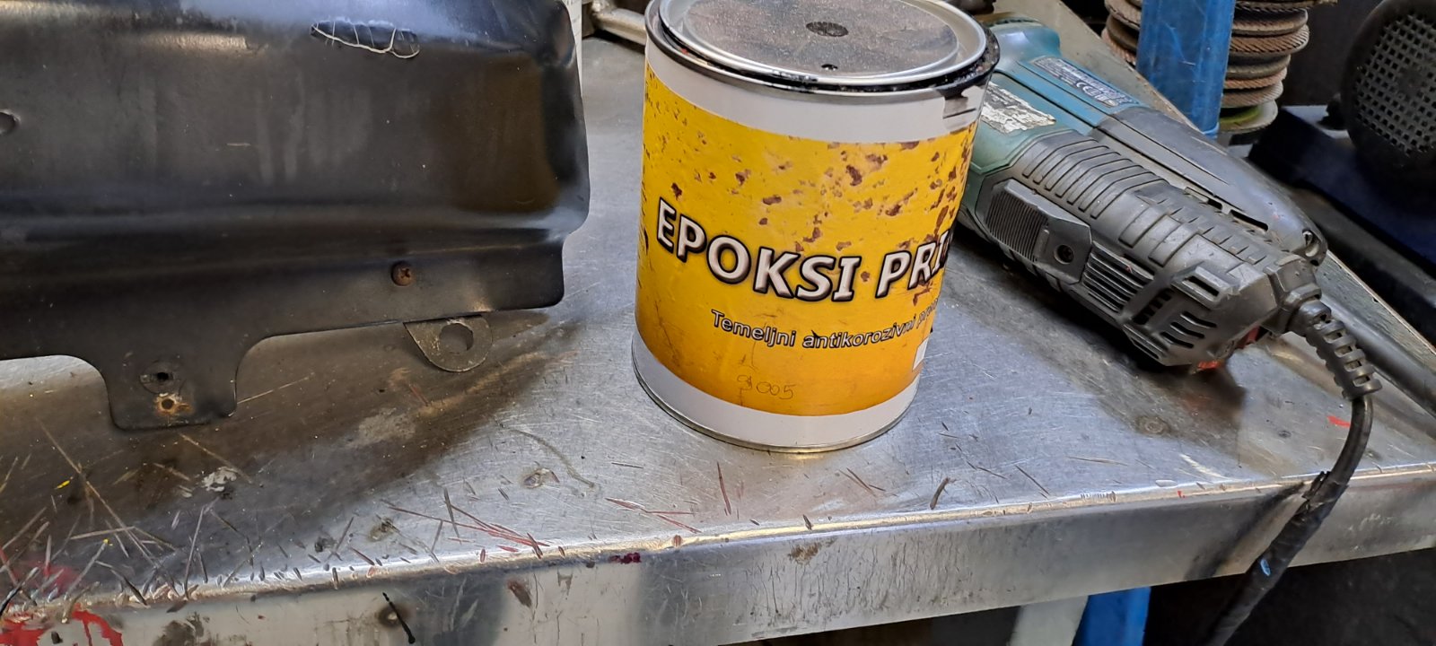

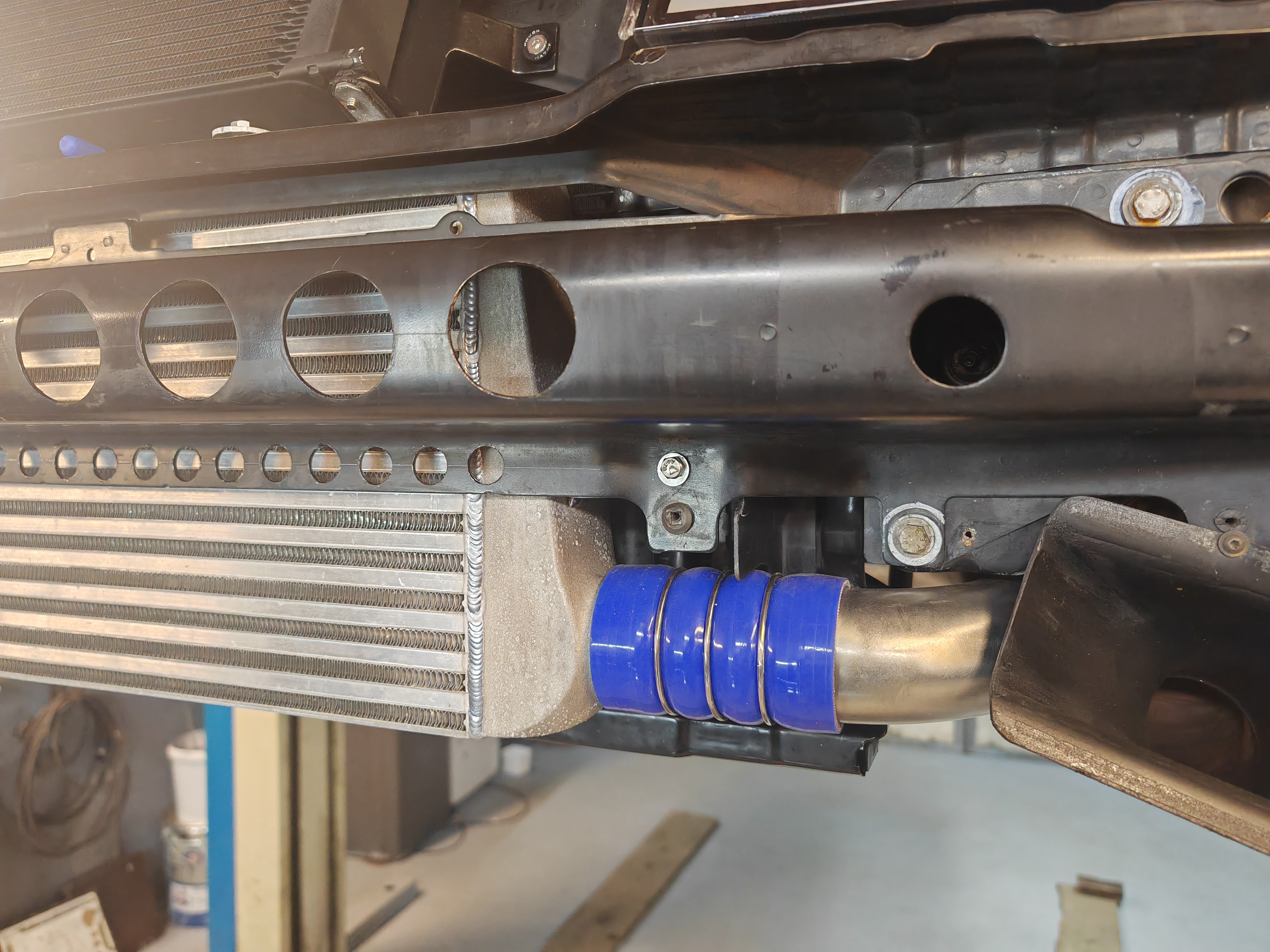

Crash bar completed-51mm holes on wider part and 25mm holes on lower part. Now time for epoxy primer and than 2k acrylic matte black paint for rust protection and OEM look. Me happpyyyy😇😇😇😇
Epoxy surely, not acrylic?
Epoxy primer yes, than acrylic paint
It was the 2K that I was questioning, I did not think there was a 2 pack acrylic paint but I am well out of touch.
Sorry, yes there is, my painter gave me 2 vottles to mix before use

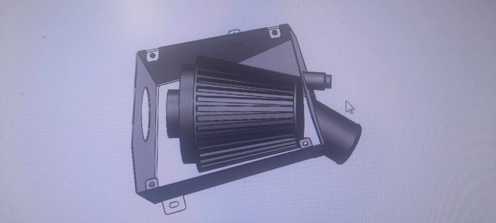

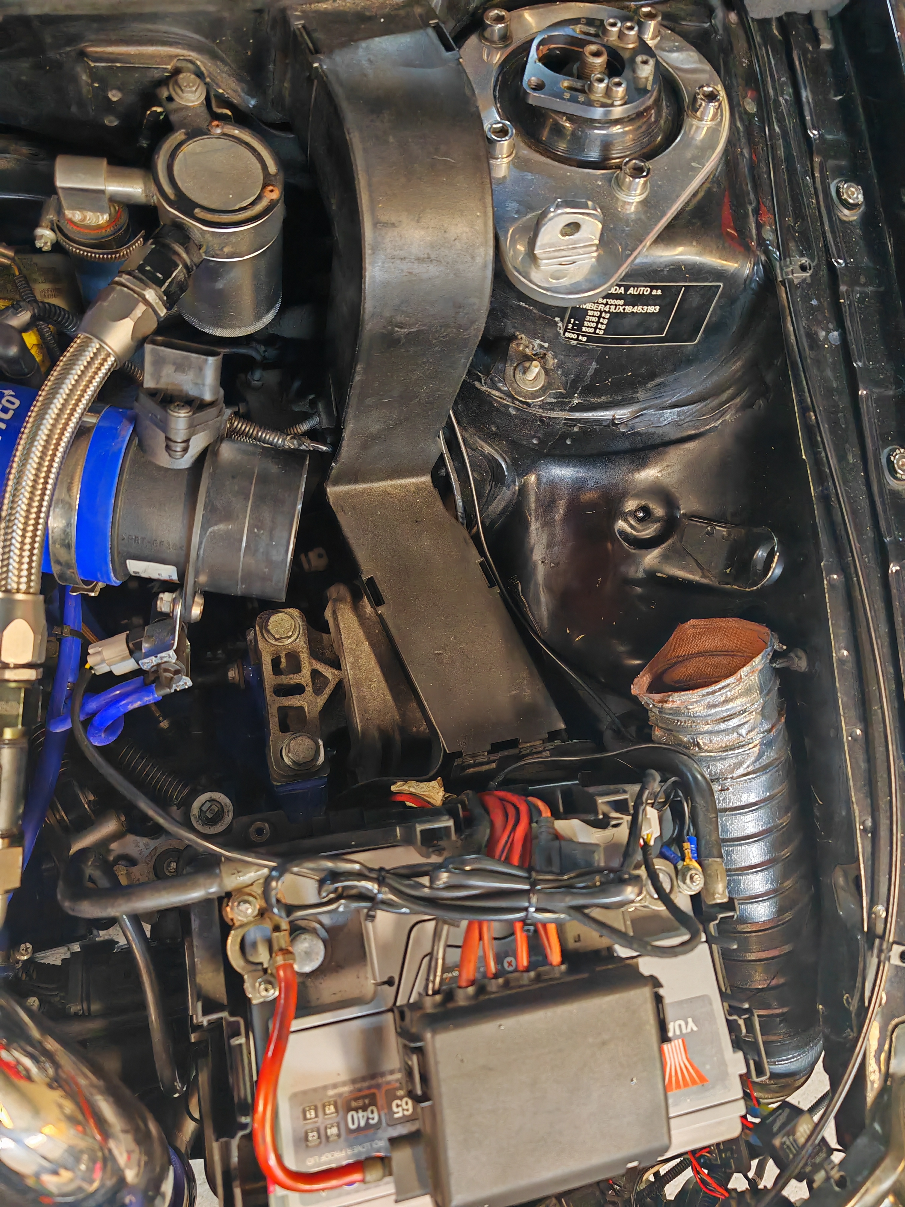

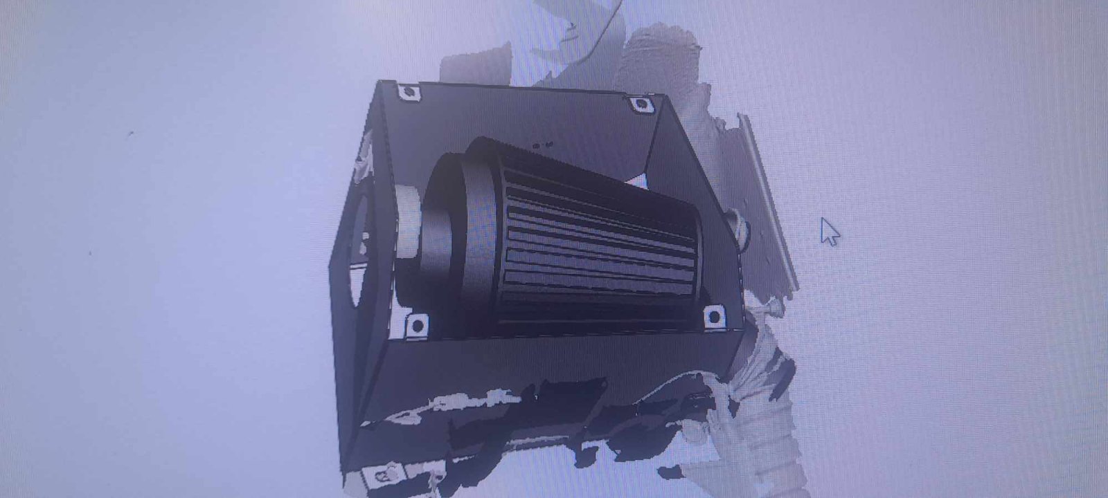

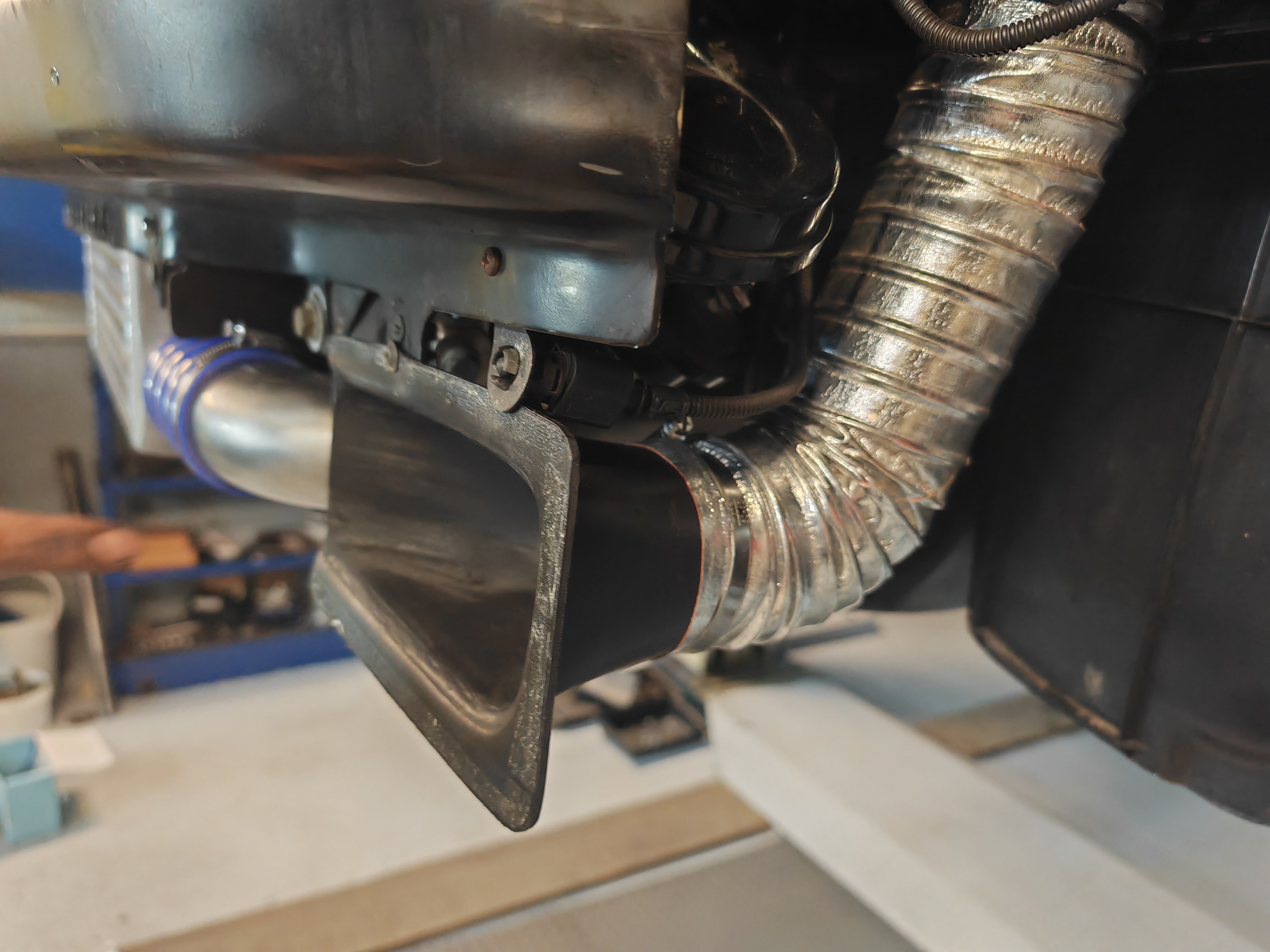

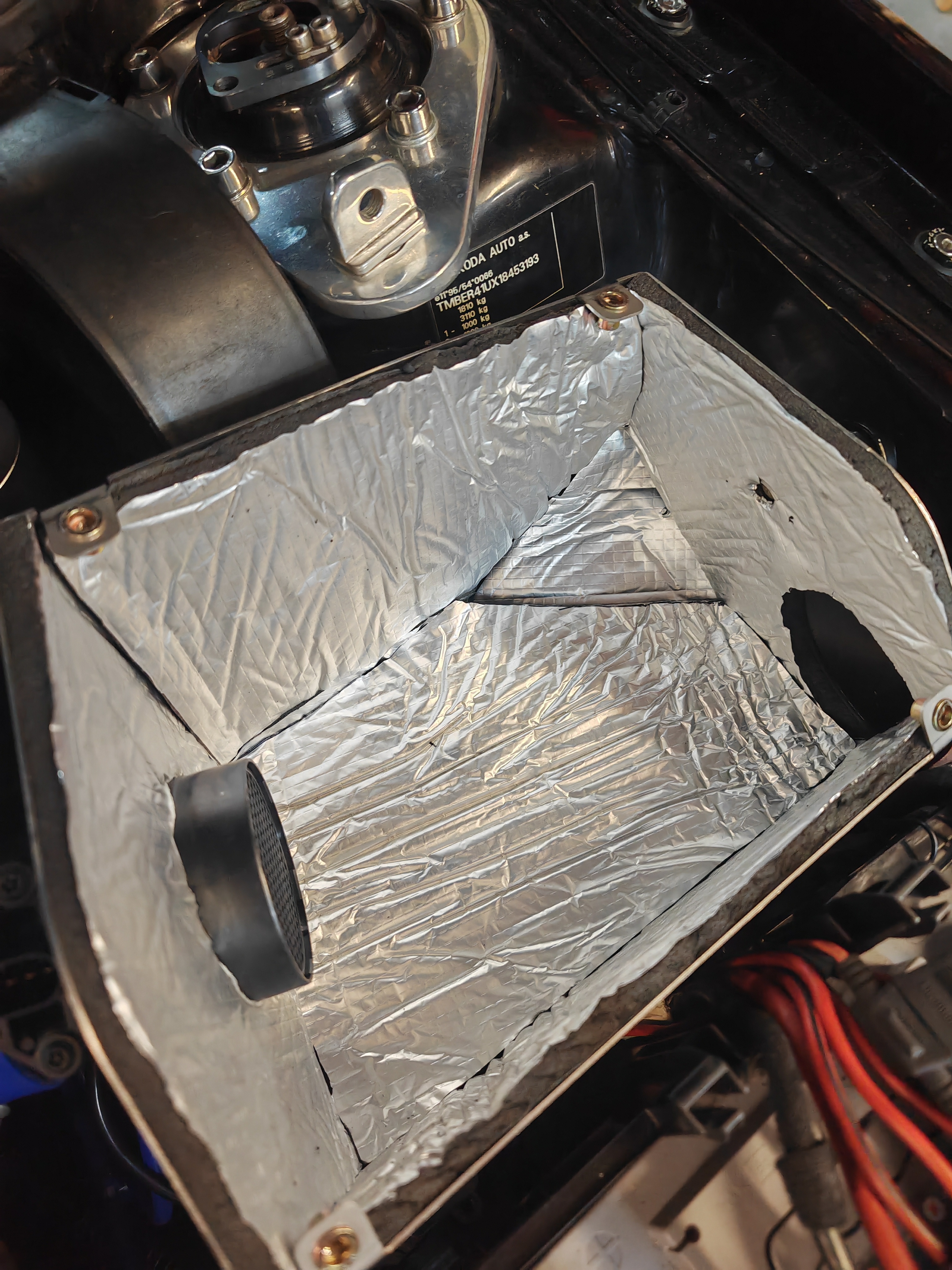

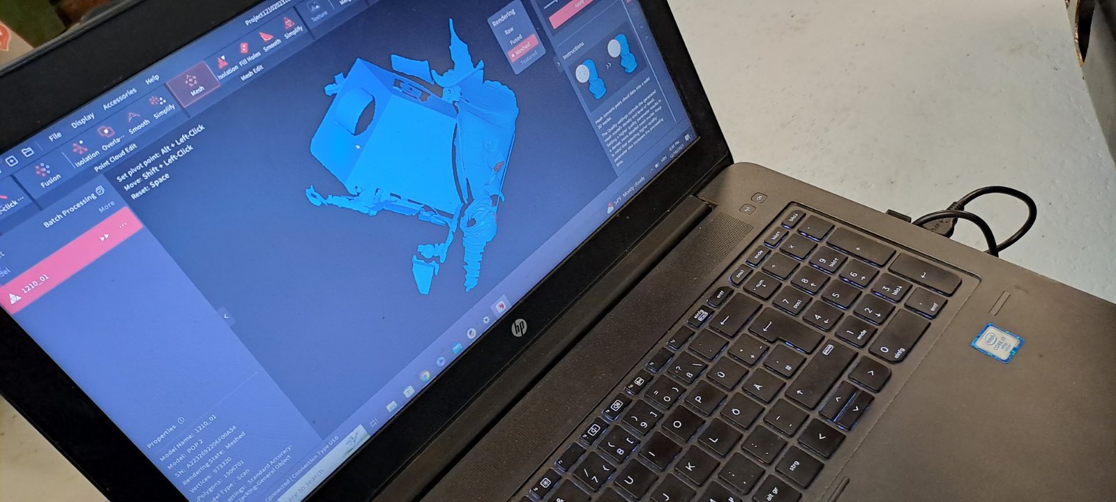

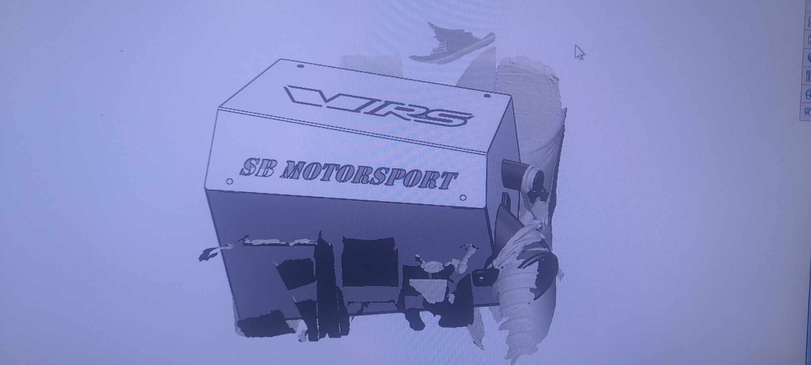

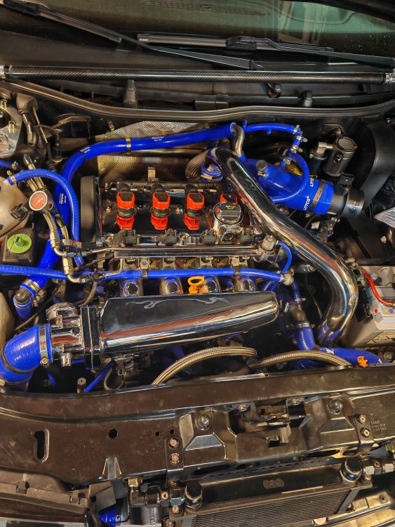

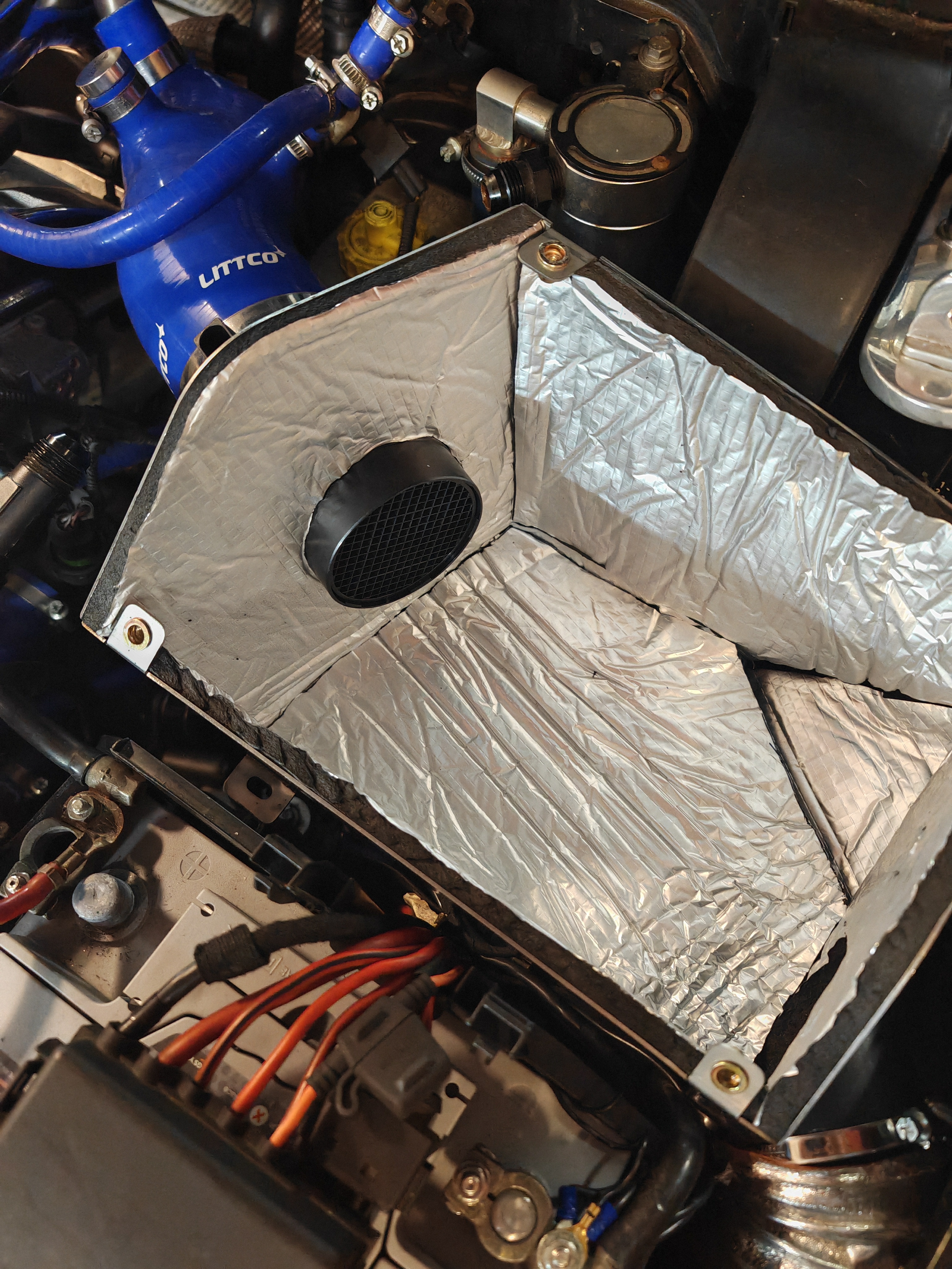

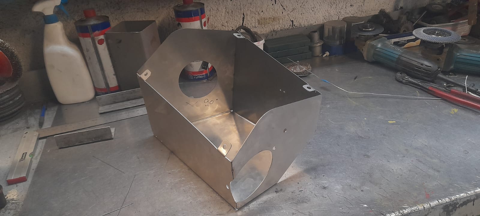

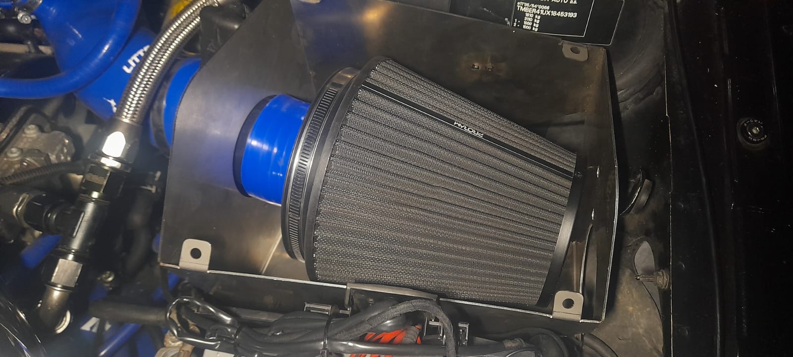

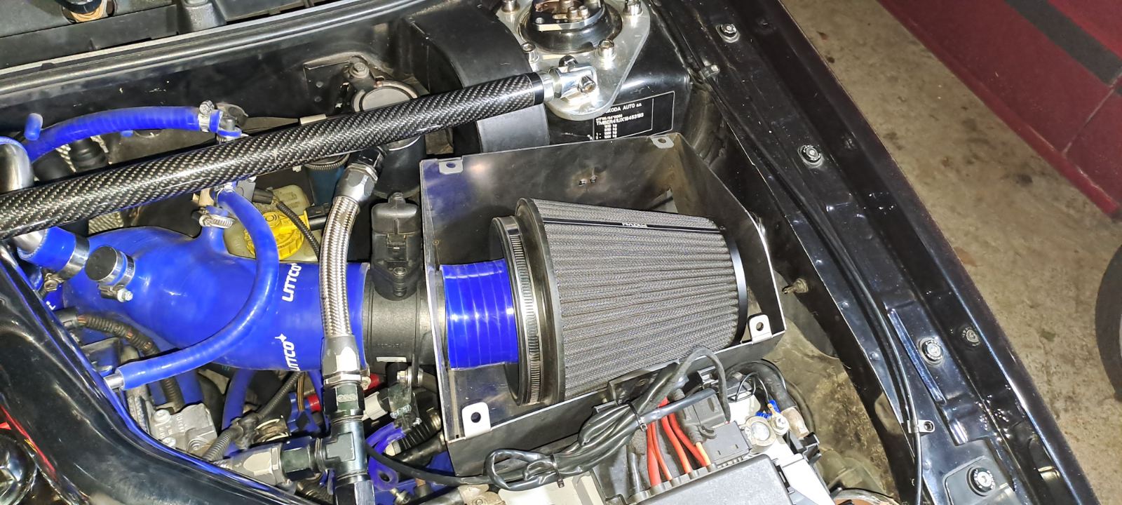

And most Important due to the fact those shields does not prevent hot air to be sucked into the filter, espetially my Cloud 9 customs made for bigger batterry plastic cover 8n TT thus leaving open space on MK4 golf platform so we are developing new custom air box-closed with direct fit for air duct,and thermo insulated with 1cm adhesive sponge and reflective silver film on it according to the laser 3D scan, and most Important still with ProRam Large air filter with big velociry stack!!!!! This was somethimg to start with as a idea, but ours will be completely closed with air duct connection 76mm and MAF hole,nothing else. If turned ok Inwill offer them for sale to-just boxes, no filter or MAF or insulating sponge.
Edited by davojuri
Air diffusor shortened and back in place so as horns are, flawless setup.
Thus time probably without any mosquito mesh over air diffusors because as my friend former cup racer said it decreases m² od airflow surface-take the mesh and put it together and that's the ammount od reduced air flow,so this time I will exchange insect protection and less frequent filter cleaning for more airflow.

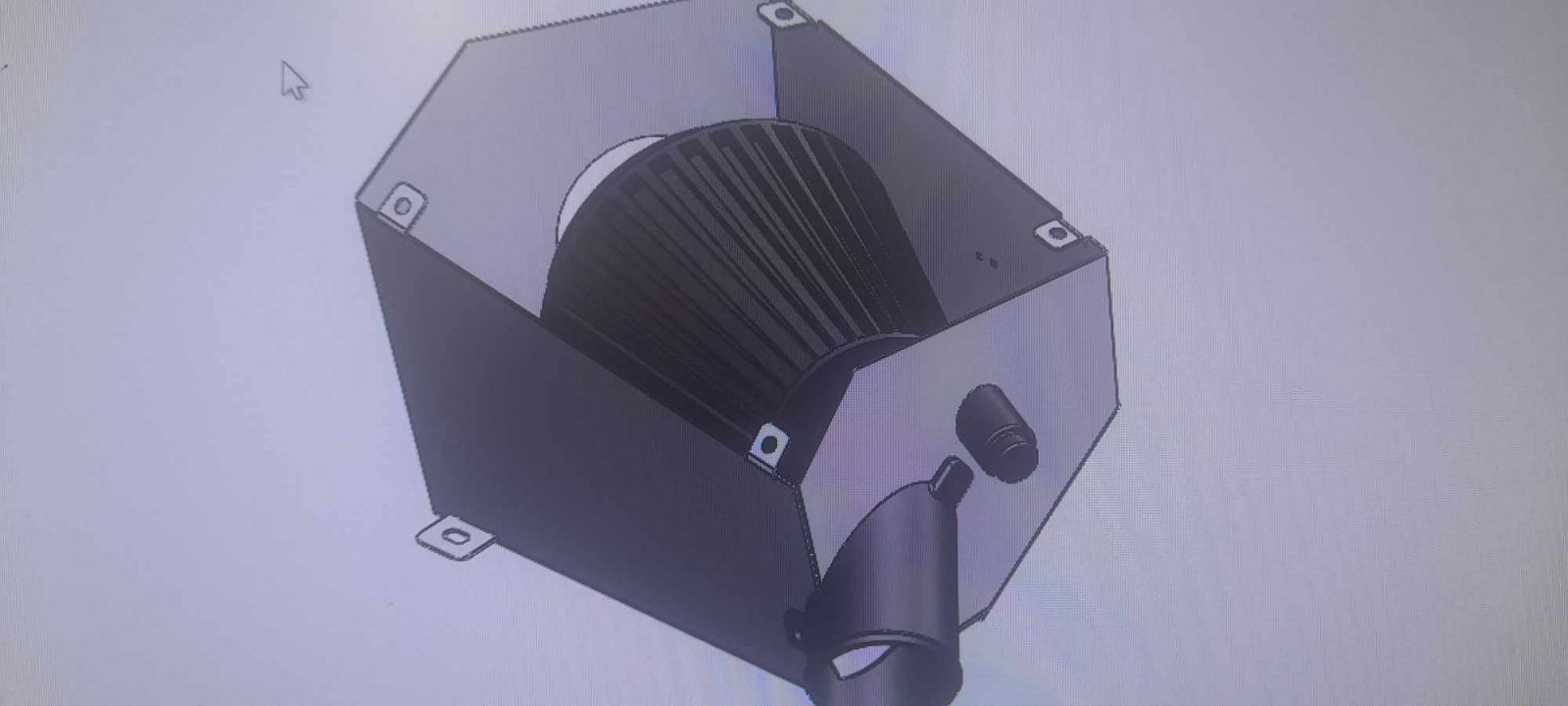

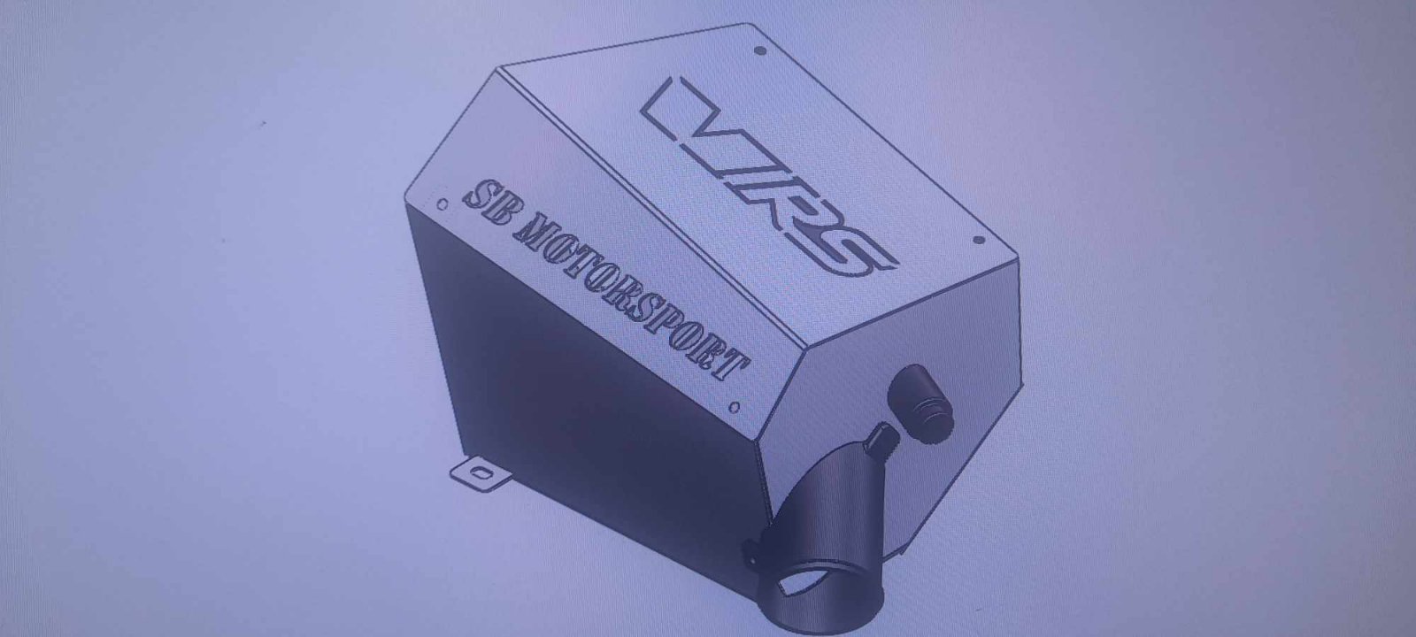

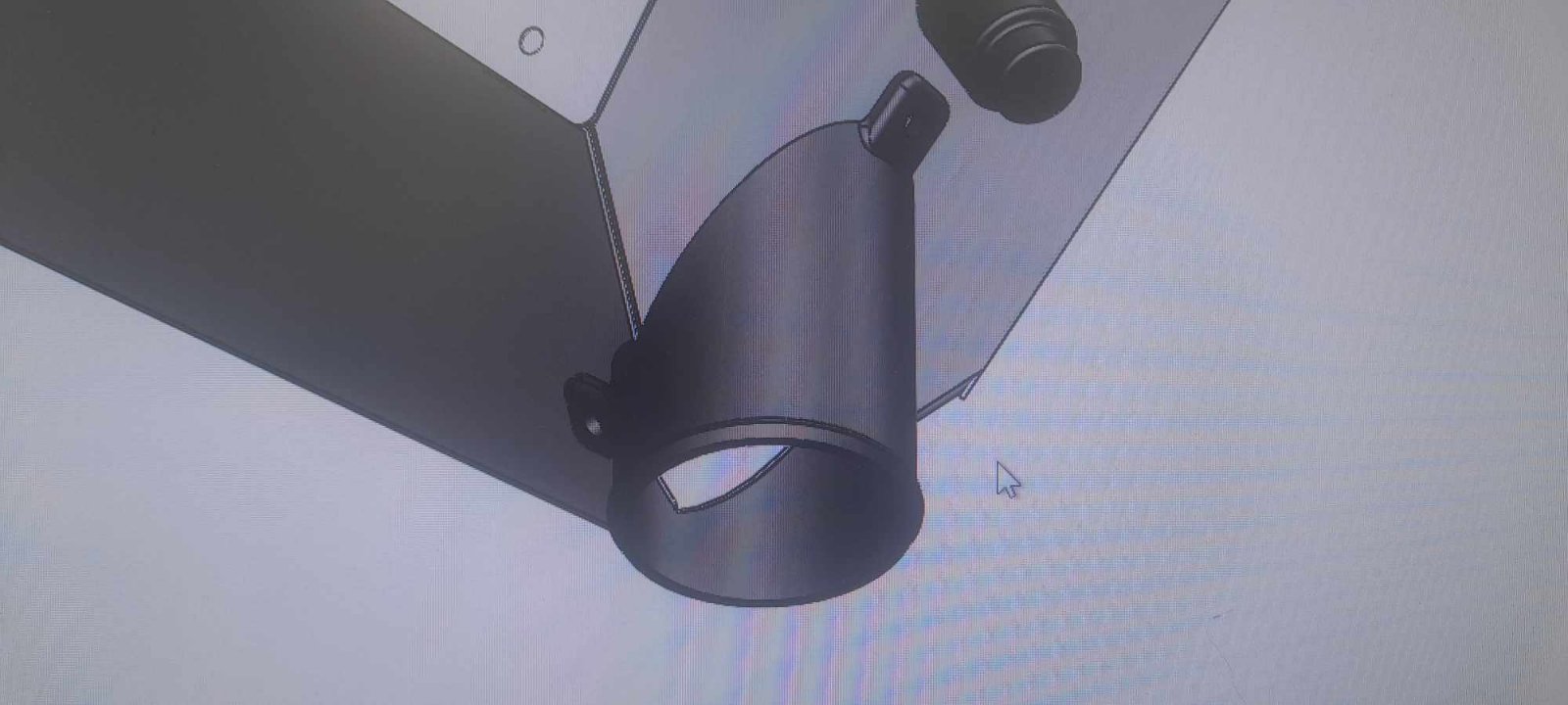

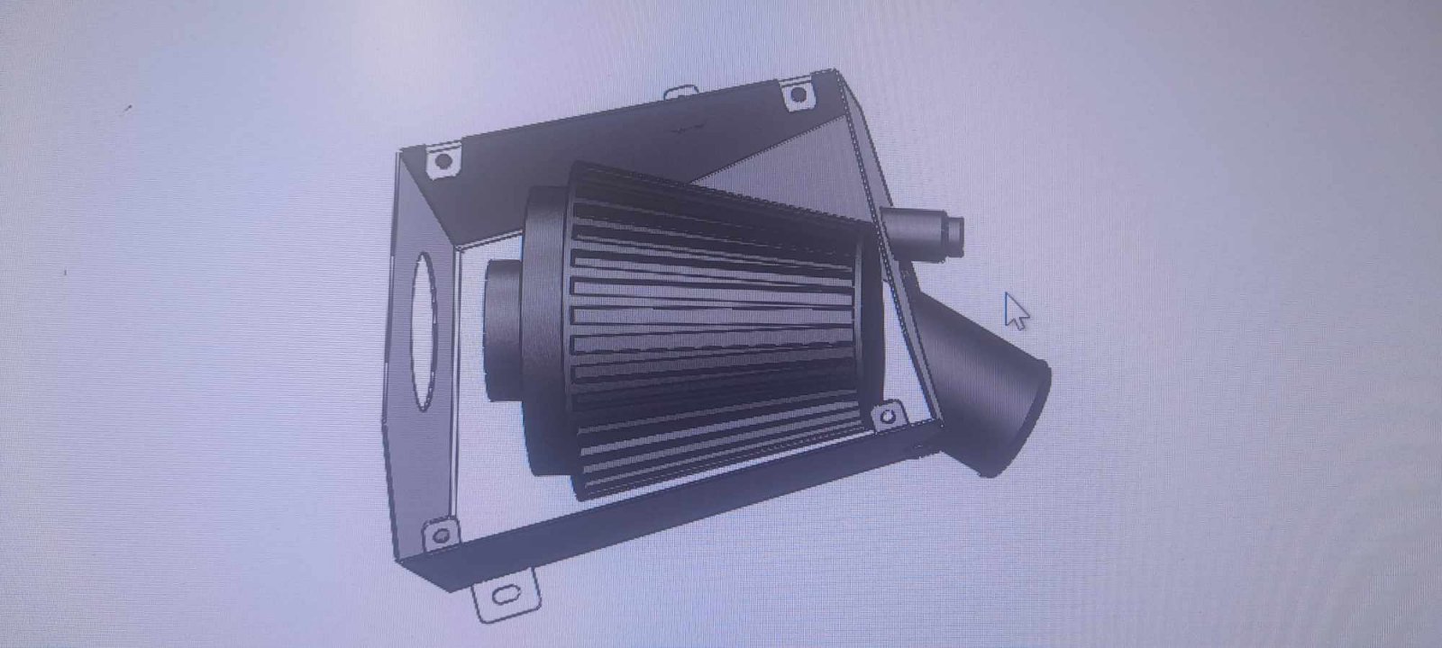

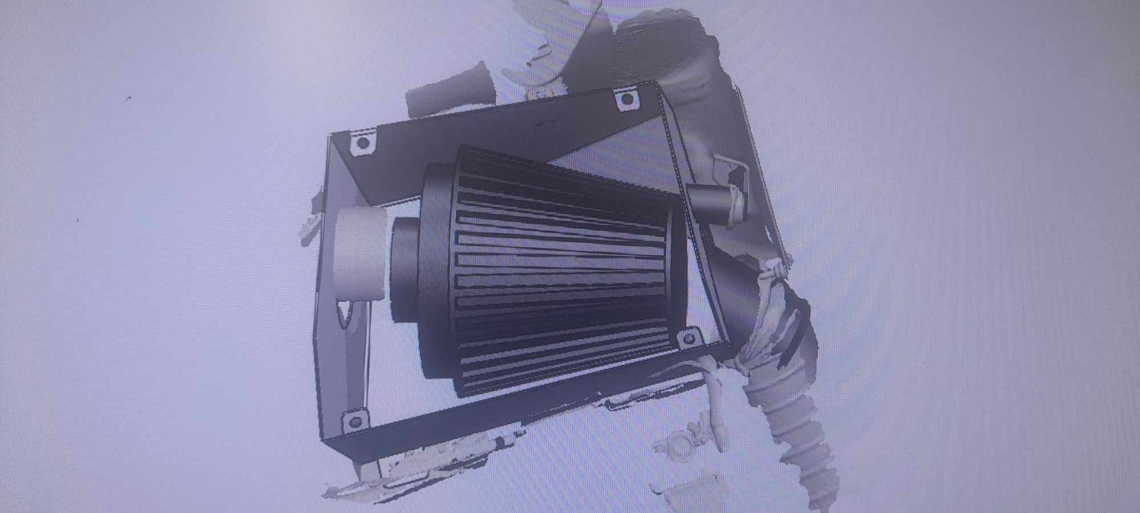

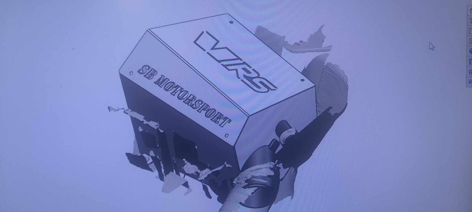

And here is first comp render,and tomorrow is production day. Can't wait to test fit it. It is without small hole for SAI,because I deleted it but can be done, depend on customer preference and direct connection to 76mm air duct-completelly closed system as OEM, with additional adhesive teromoinsularing 1cm thick sponge with silver reflective film-just suggested to my friend to make some temperature measurement before and after if possibble to prove this is the best solution

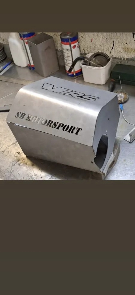

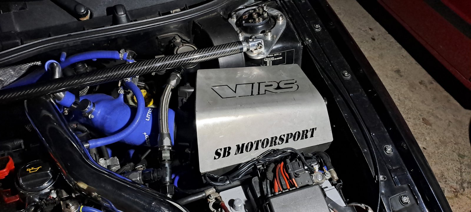

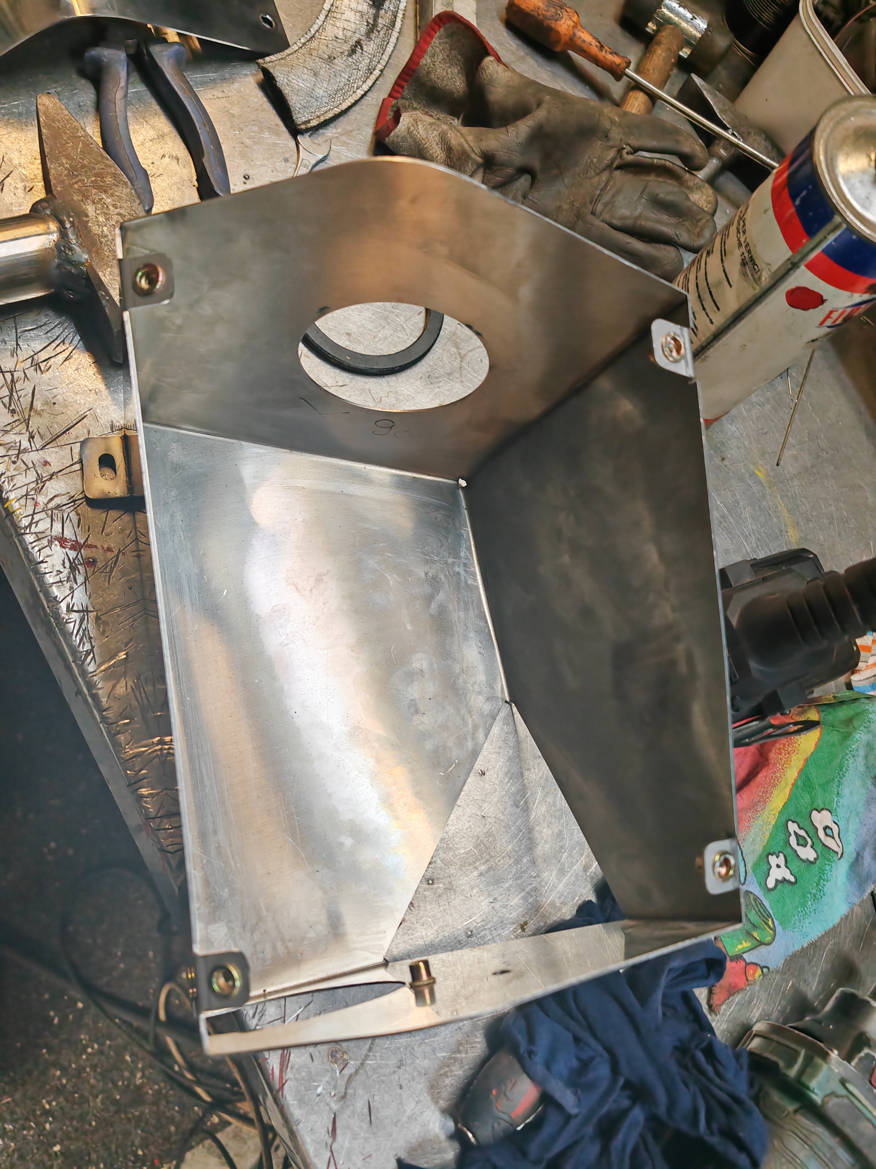

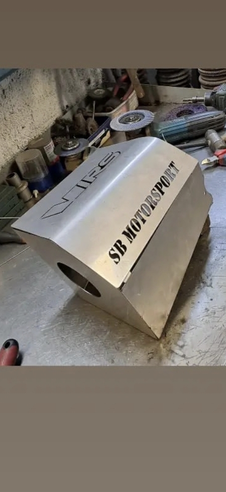

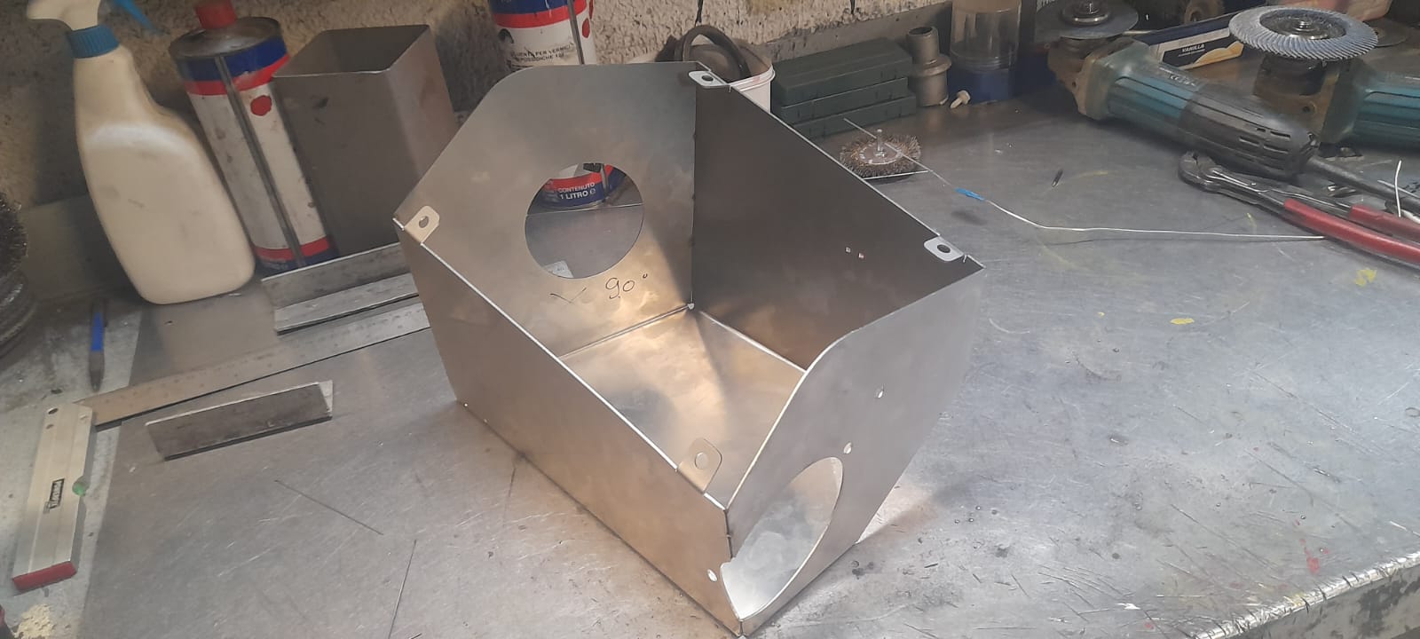

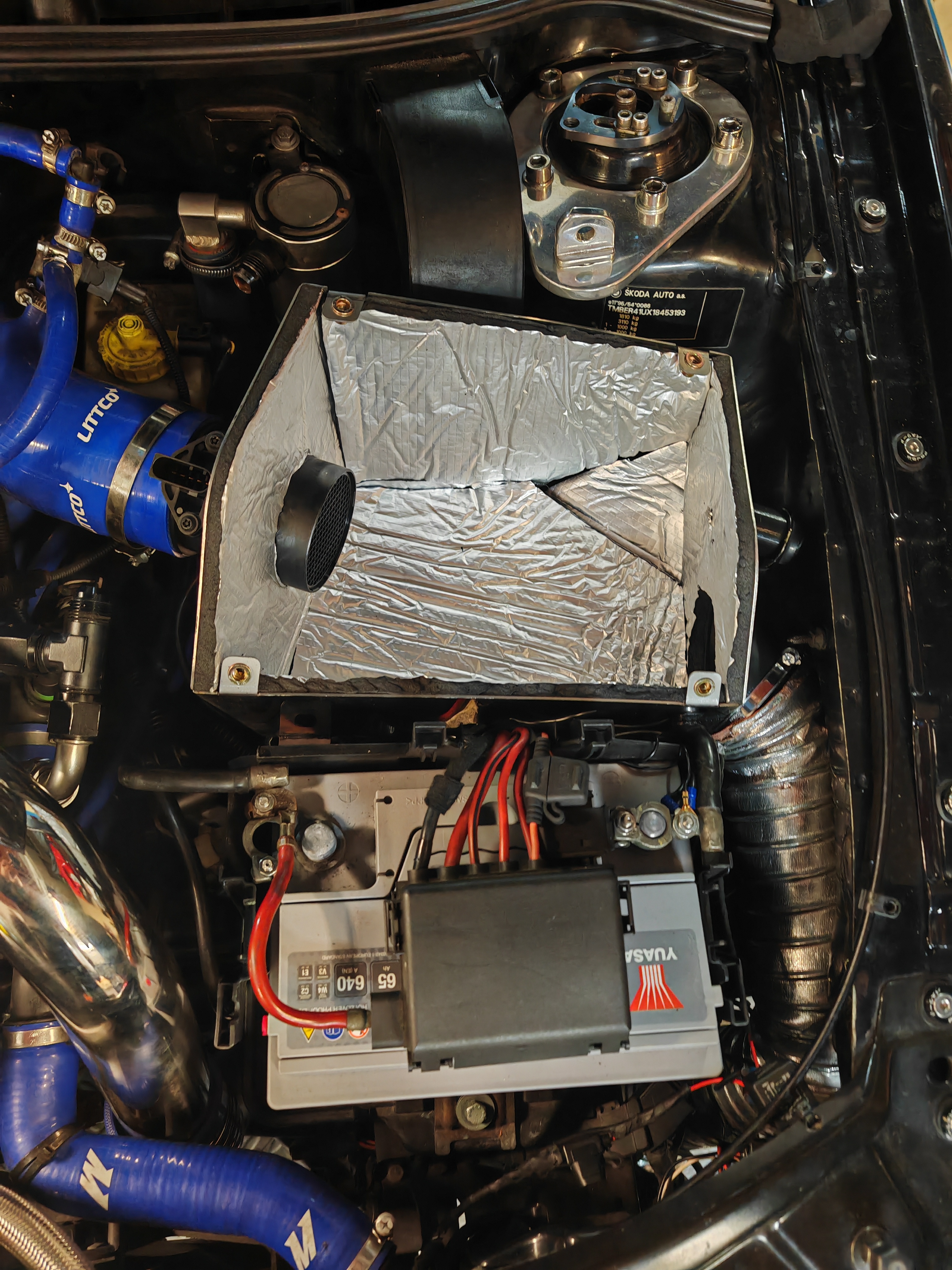

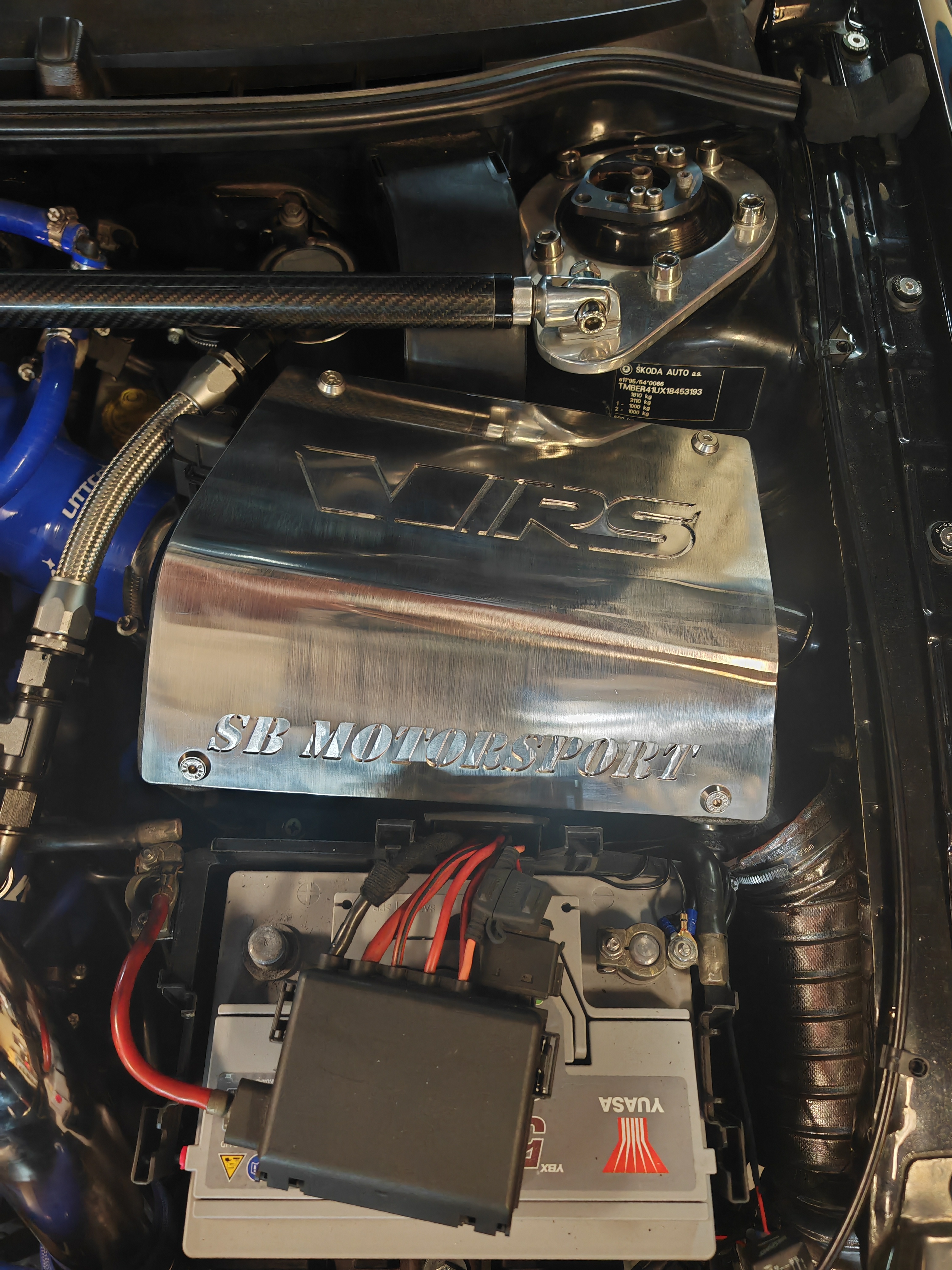

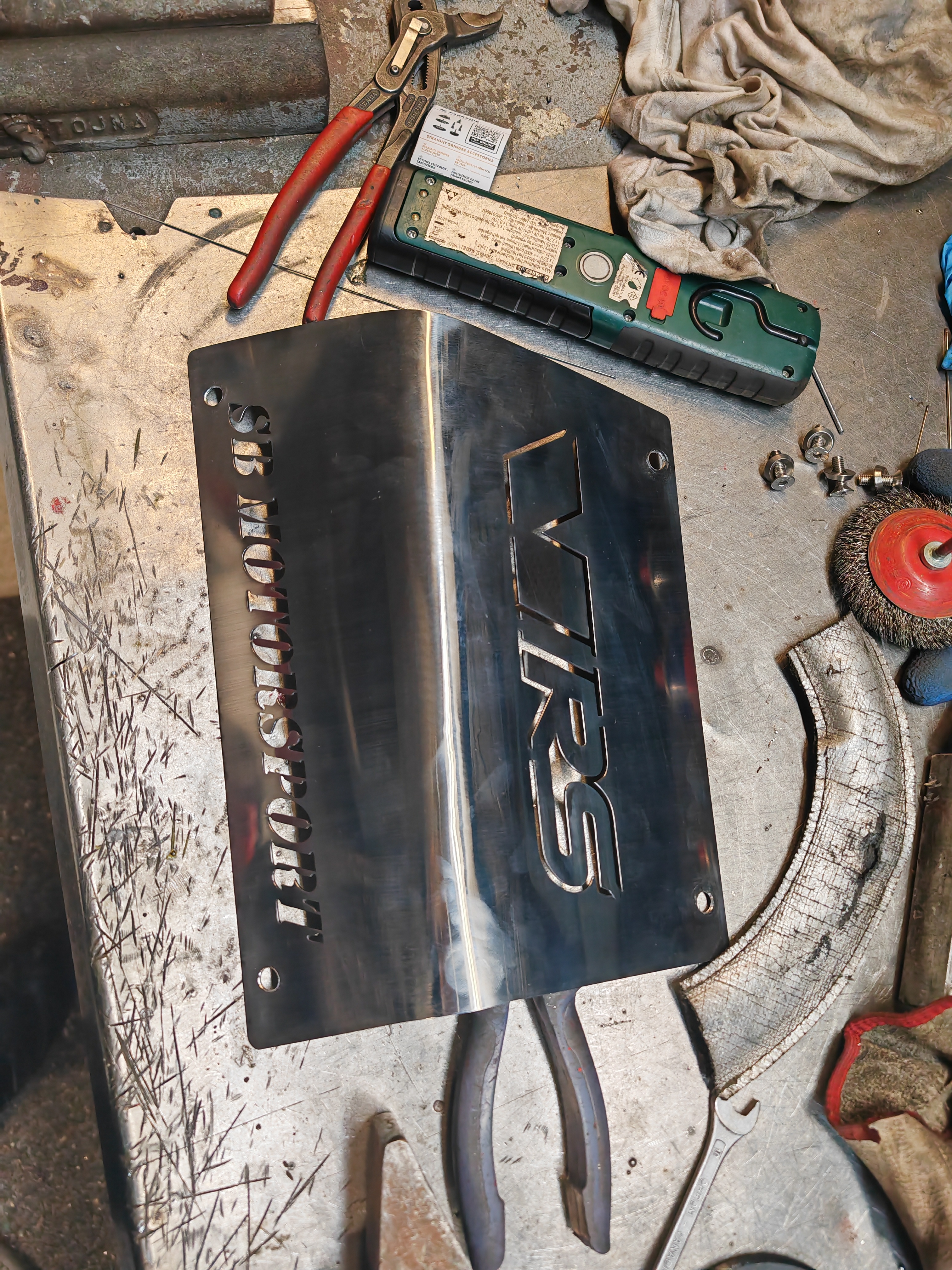

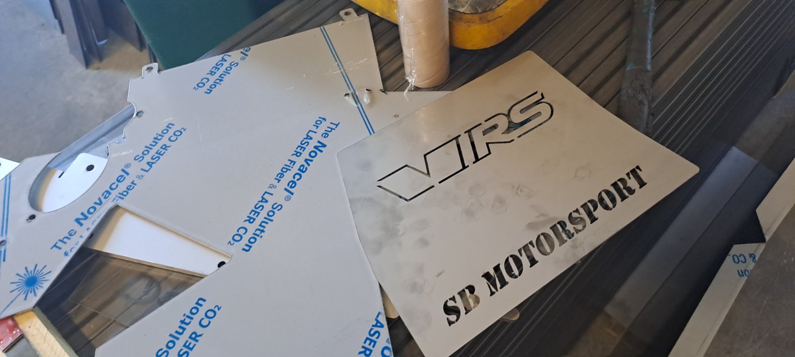

Parts are done-laser cut today. Now welding time

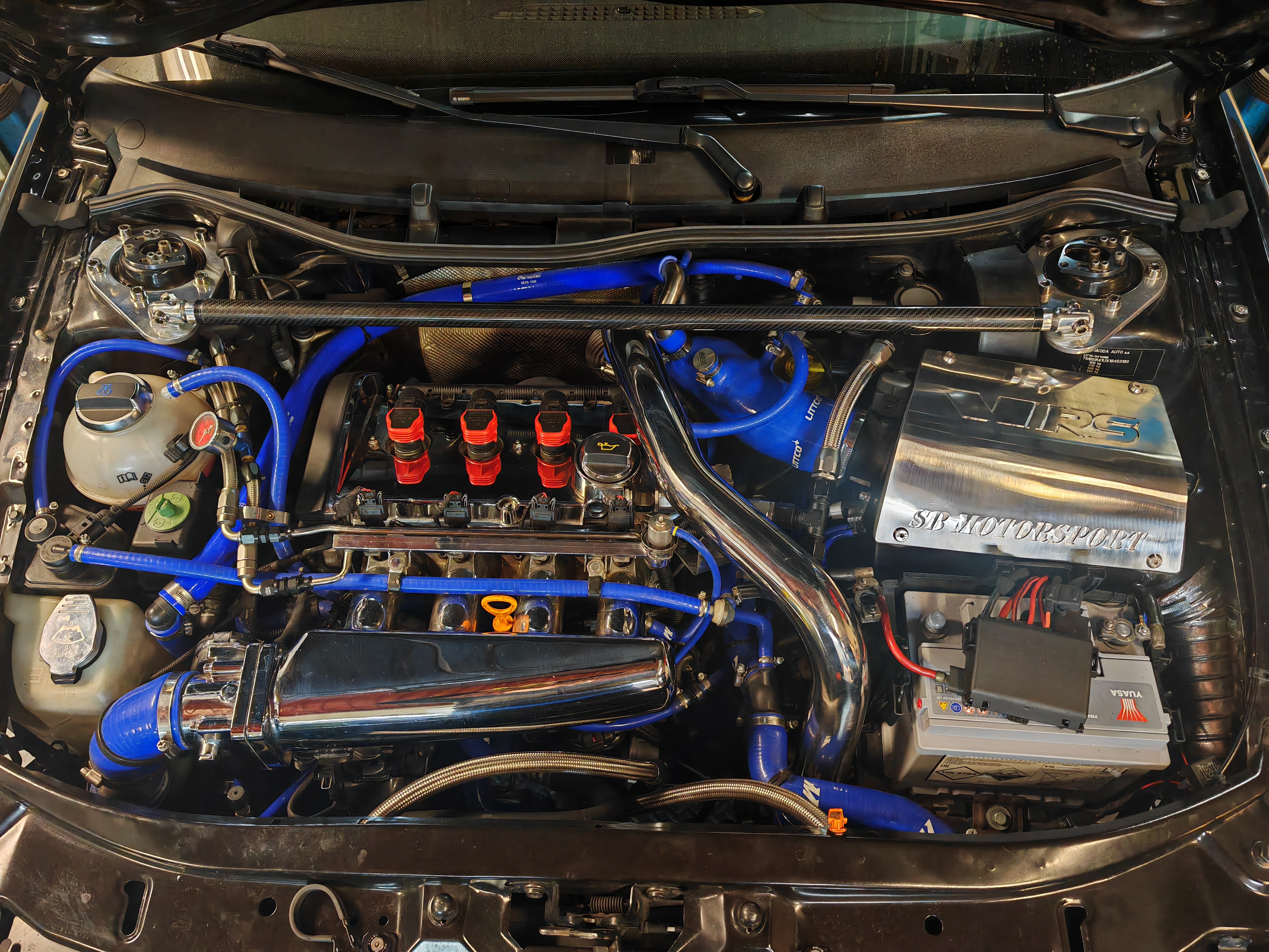

Almost finished,and I must admit much better than I expected. What do you think???

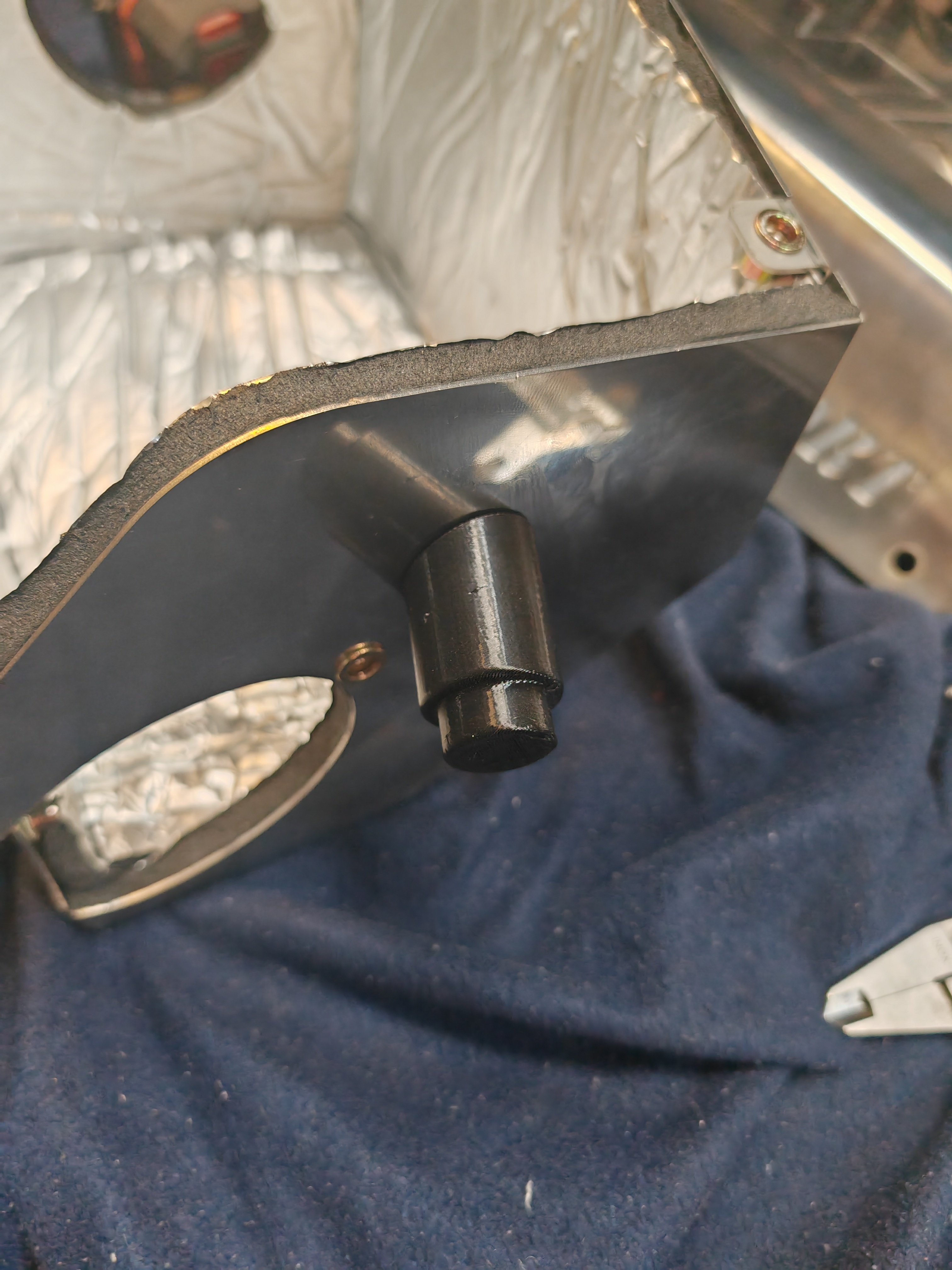

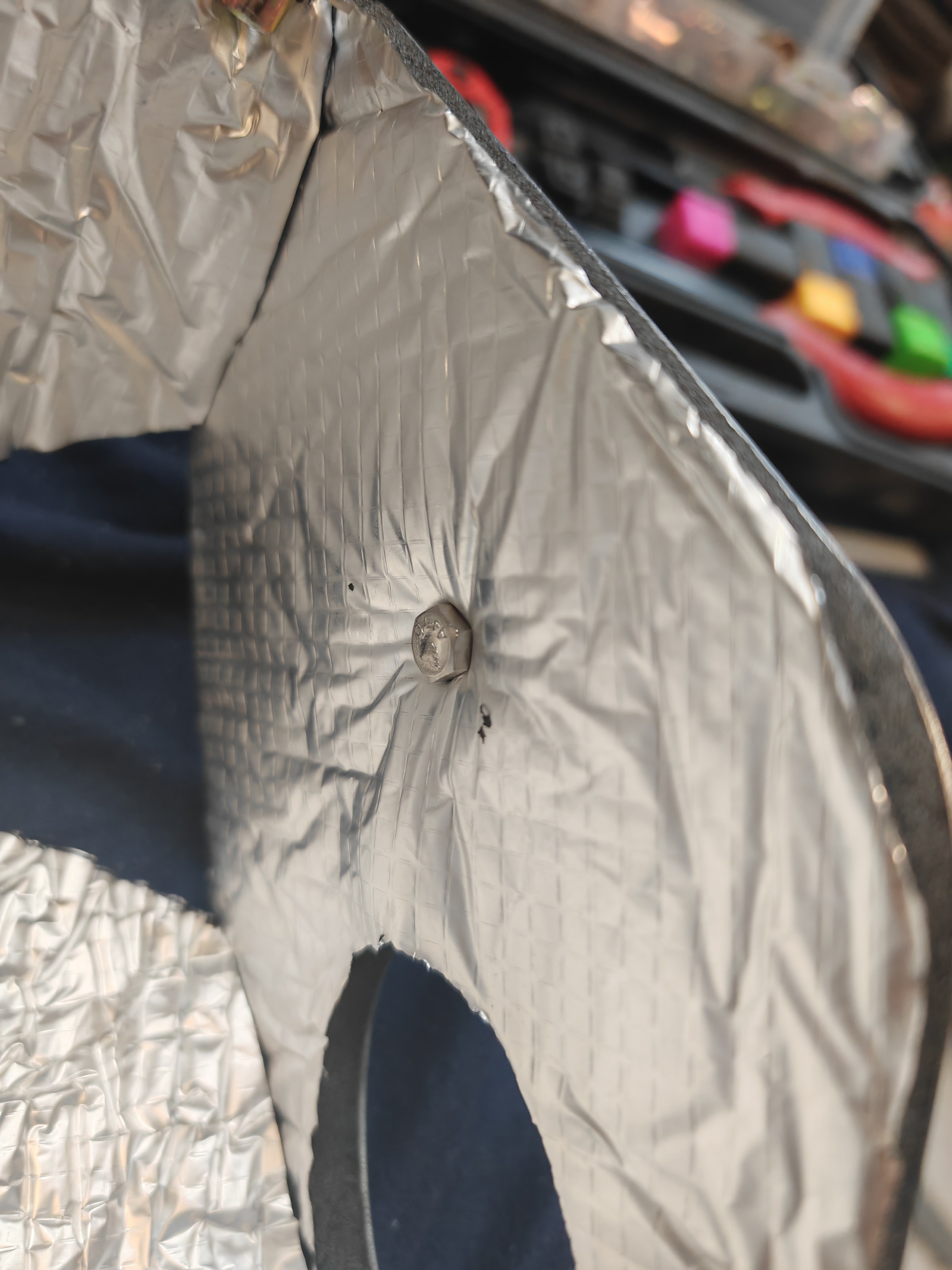

Still to be fully polished and thermoinsulating adhesive 1cm sponge with silver reflective film laid on all surfaces from inside and connector for inlet air duct 76mm to be welded. Updates to come. But for sure worldwide first and onnly fully closed airbox with such a big air filter as ProRam Large air filter with big velocity stack. Only EFE POWER is making similar but not fully enclosed stage 1 box with much smaller air filter without velocity stack. So thumbs up for my friend who made it.
Edited by davojuri

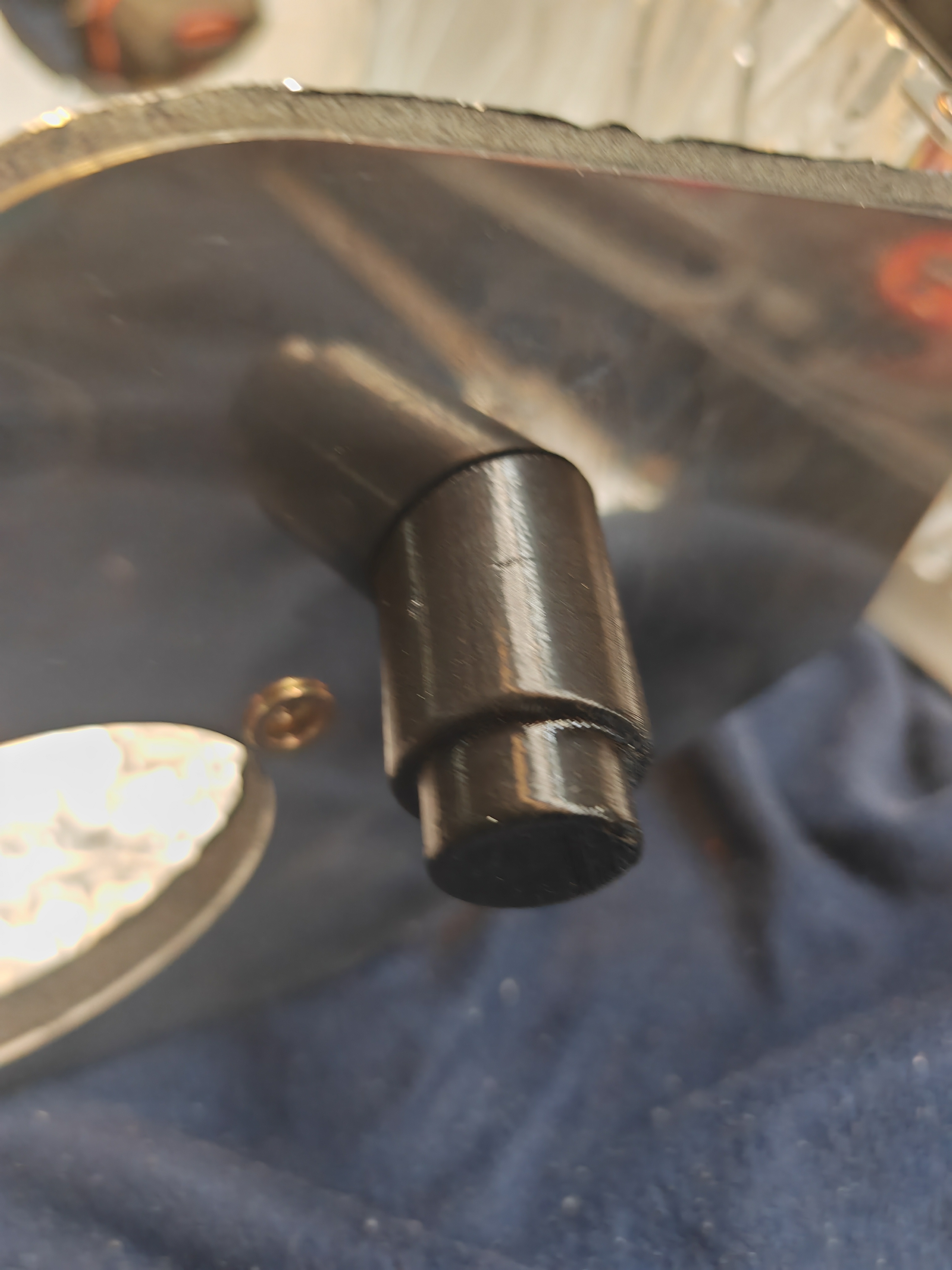

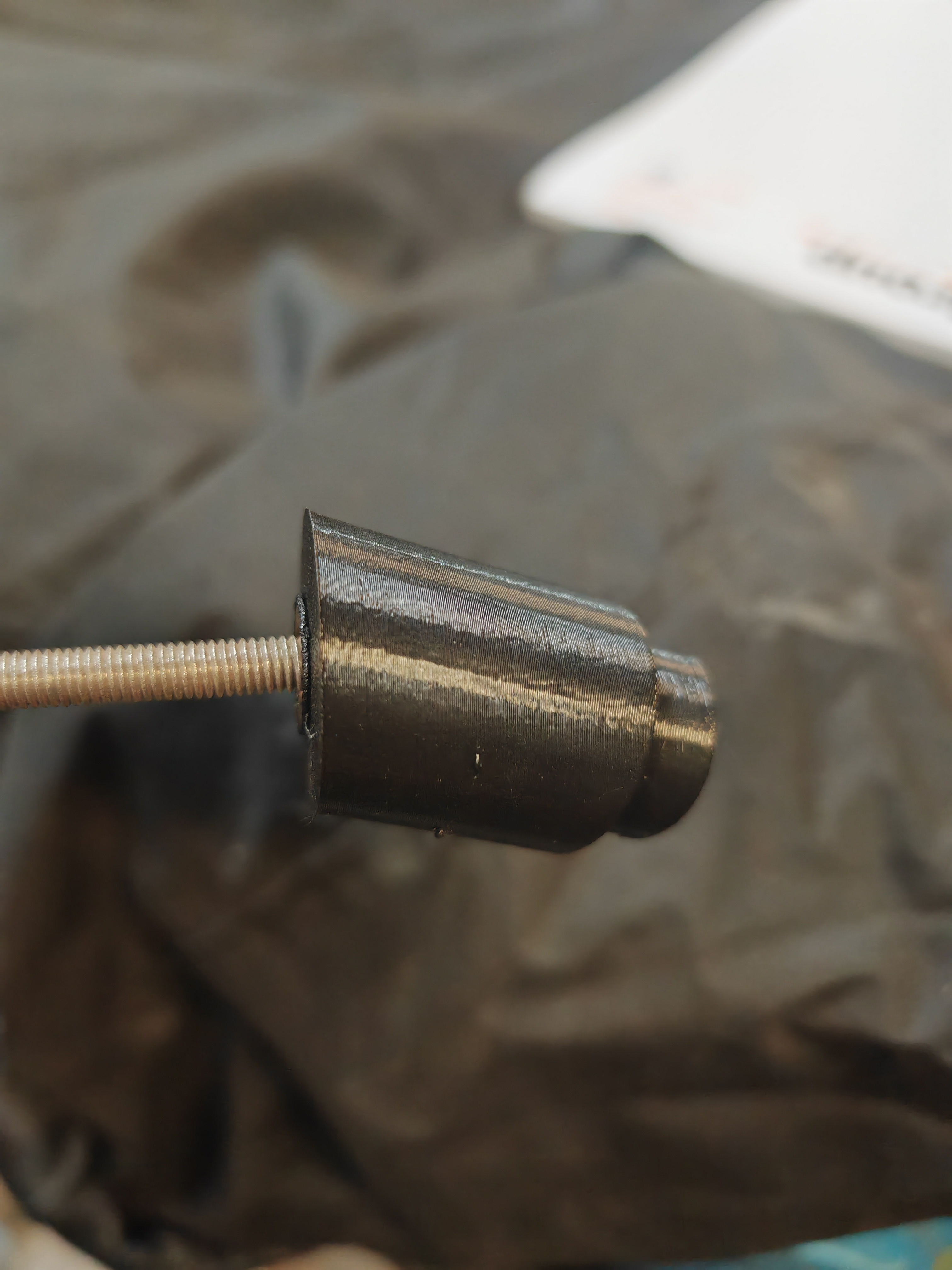

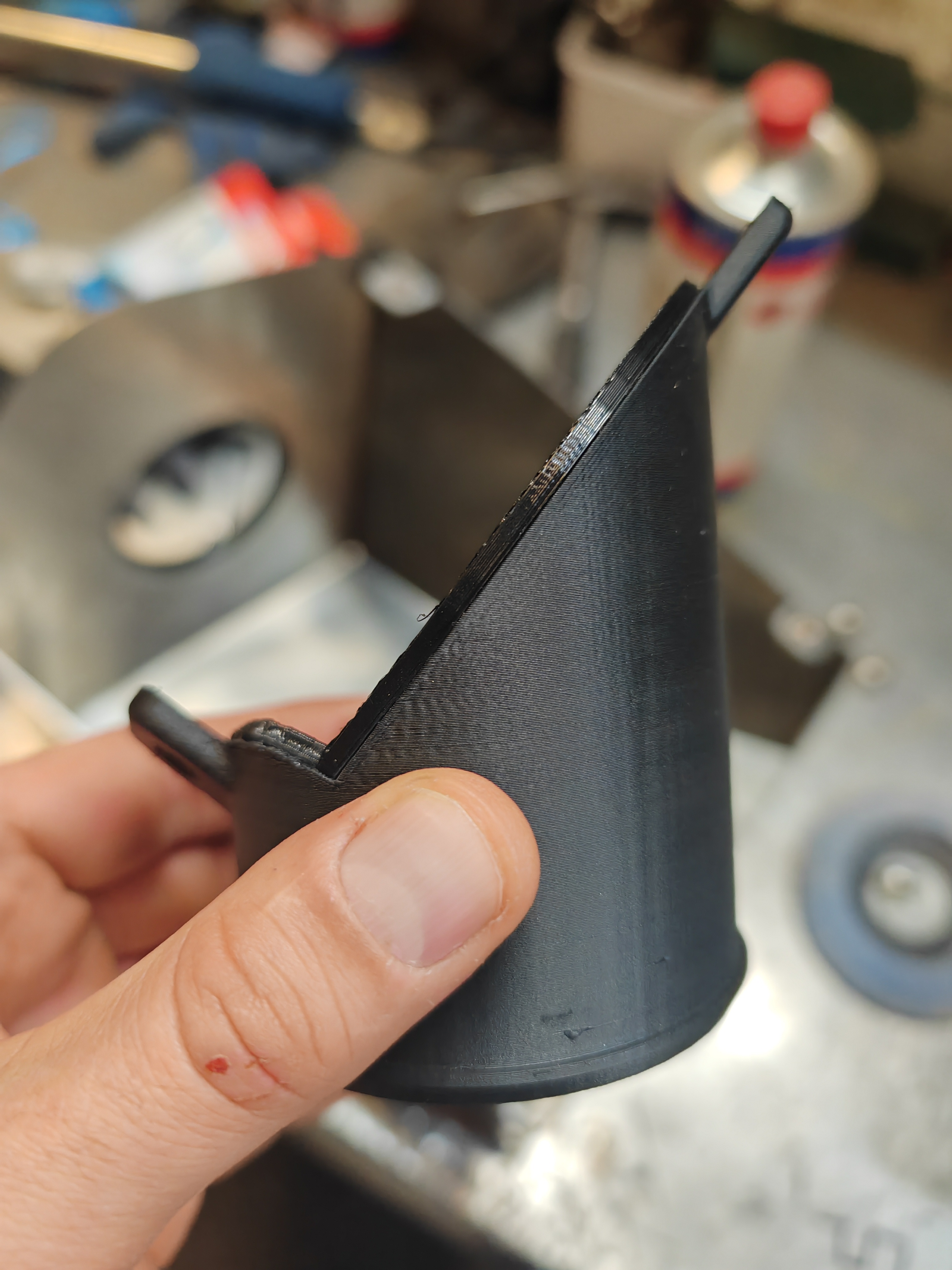

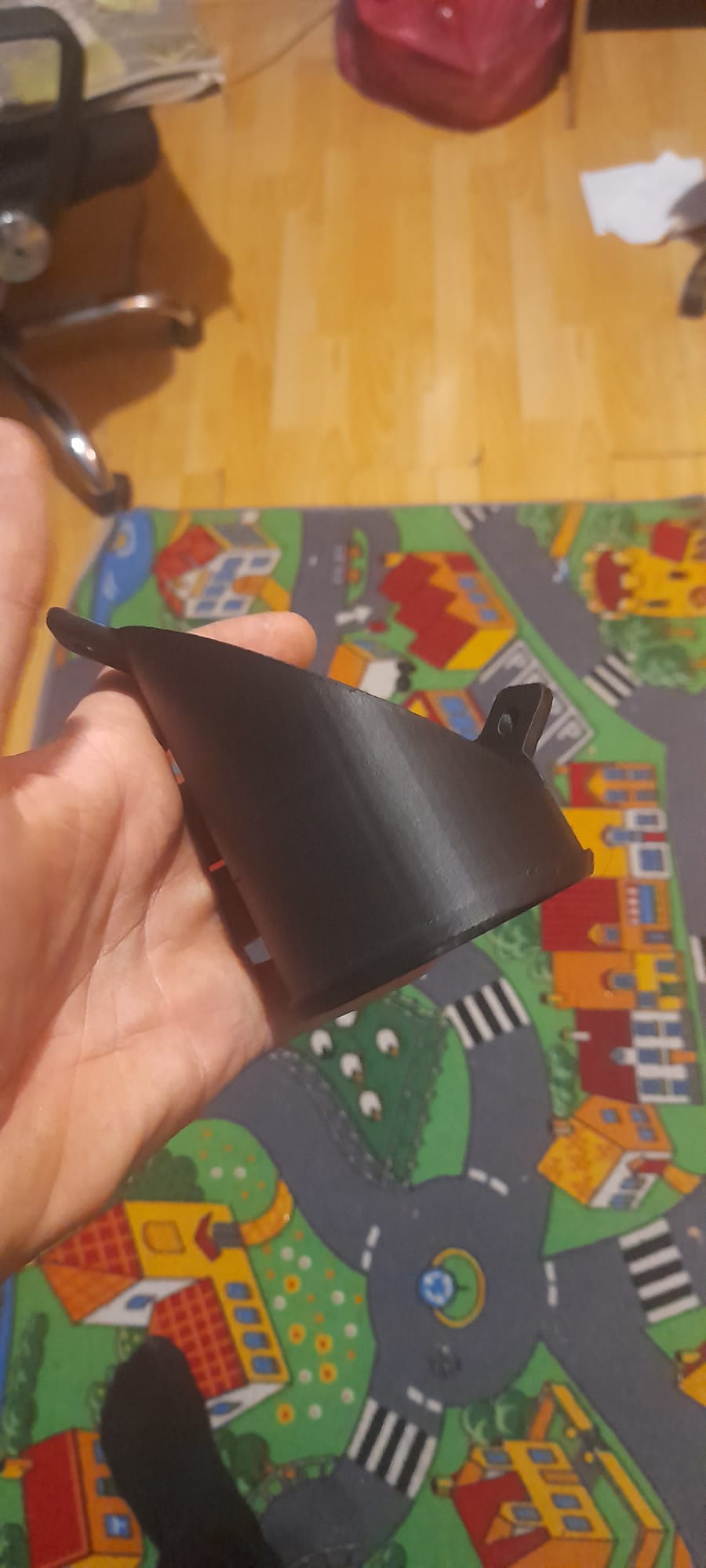

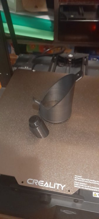

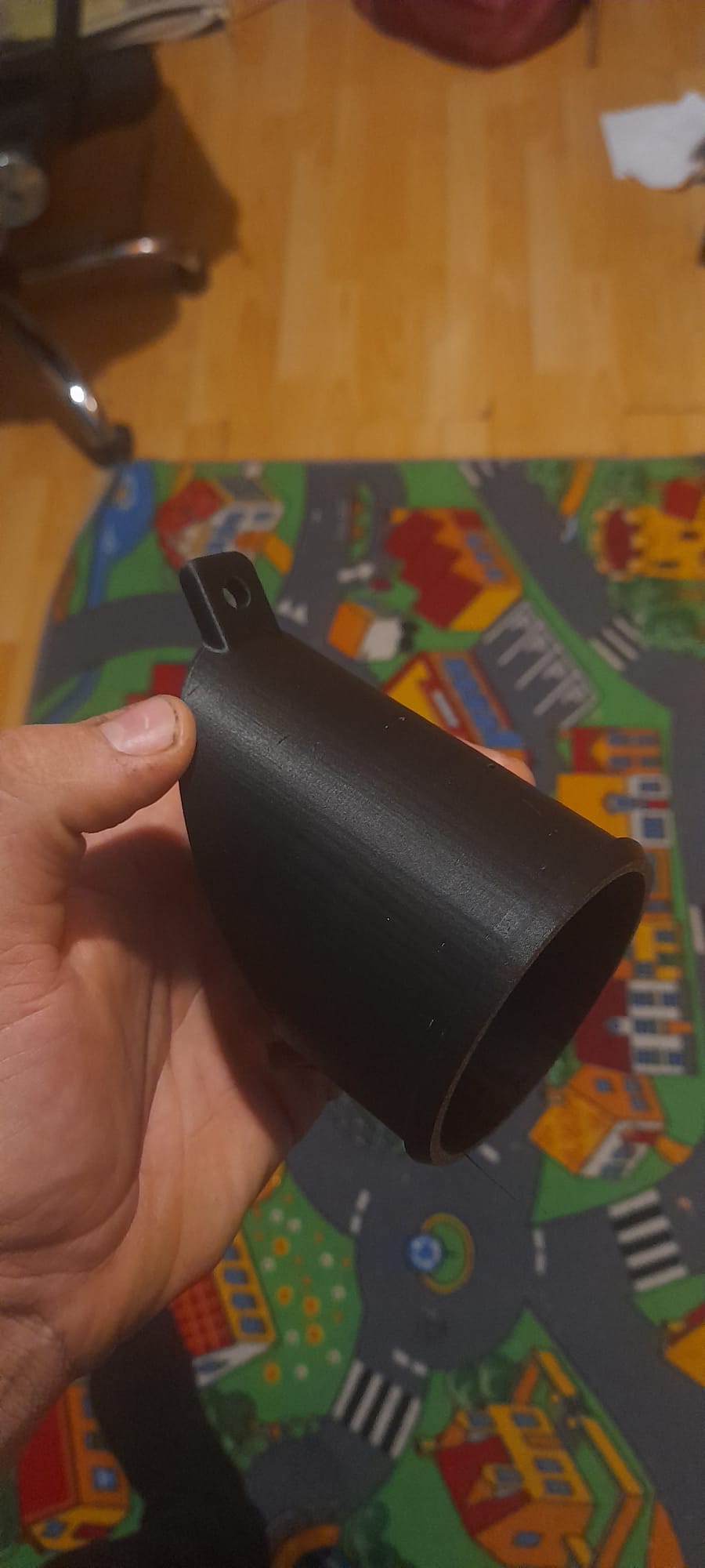

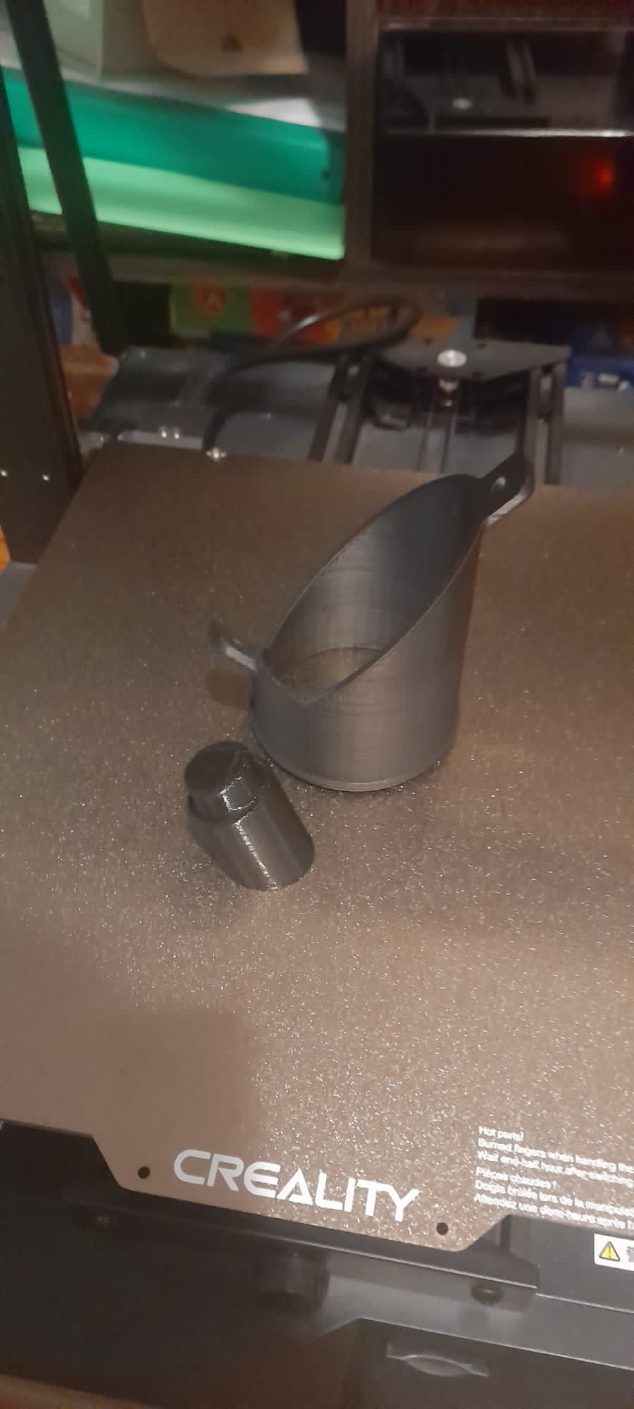

Plastic air inlet and OEM Like shock absorber from rubber are 3D printed, still decidingn weather inlet should also be from rubber for better air tightness or we shall use some silicone Seal???
Edited by davojuri

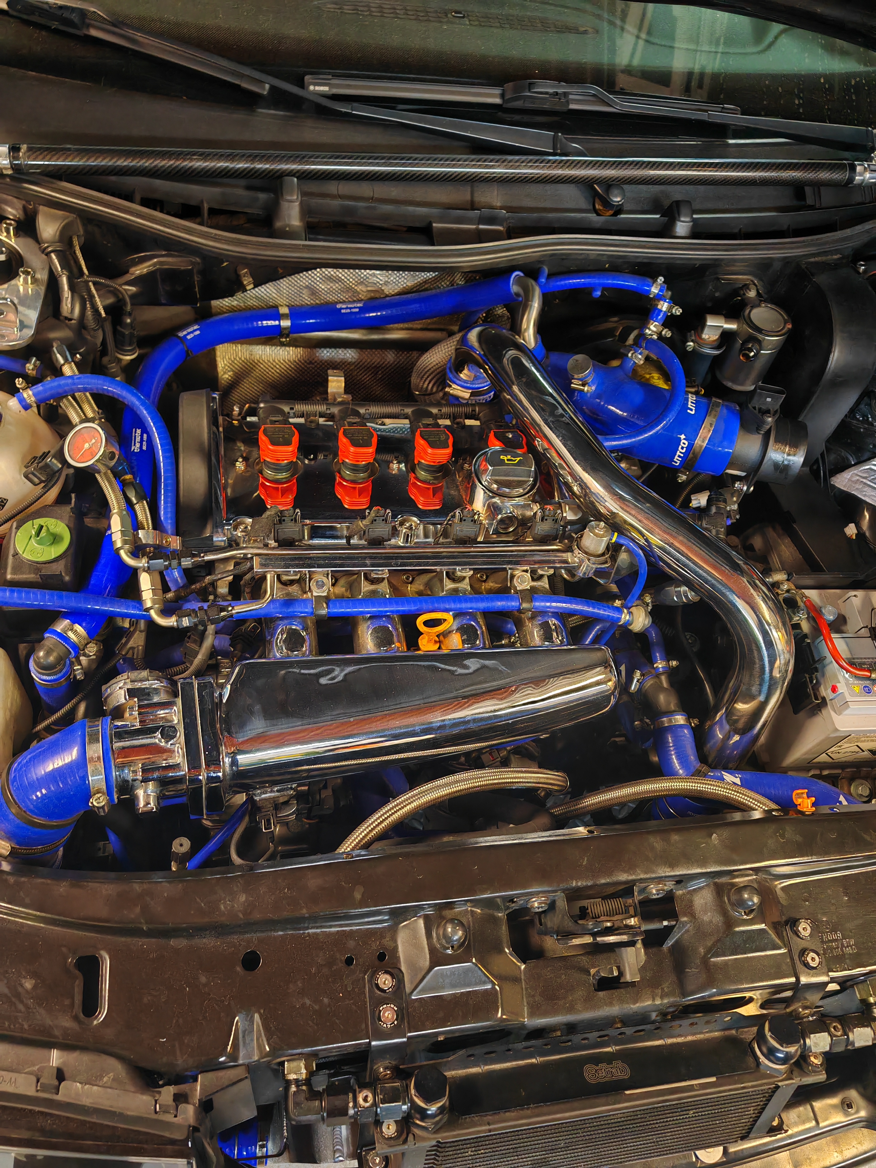

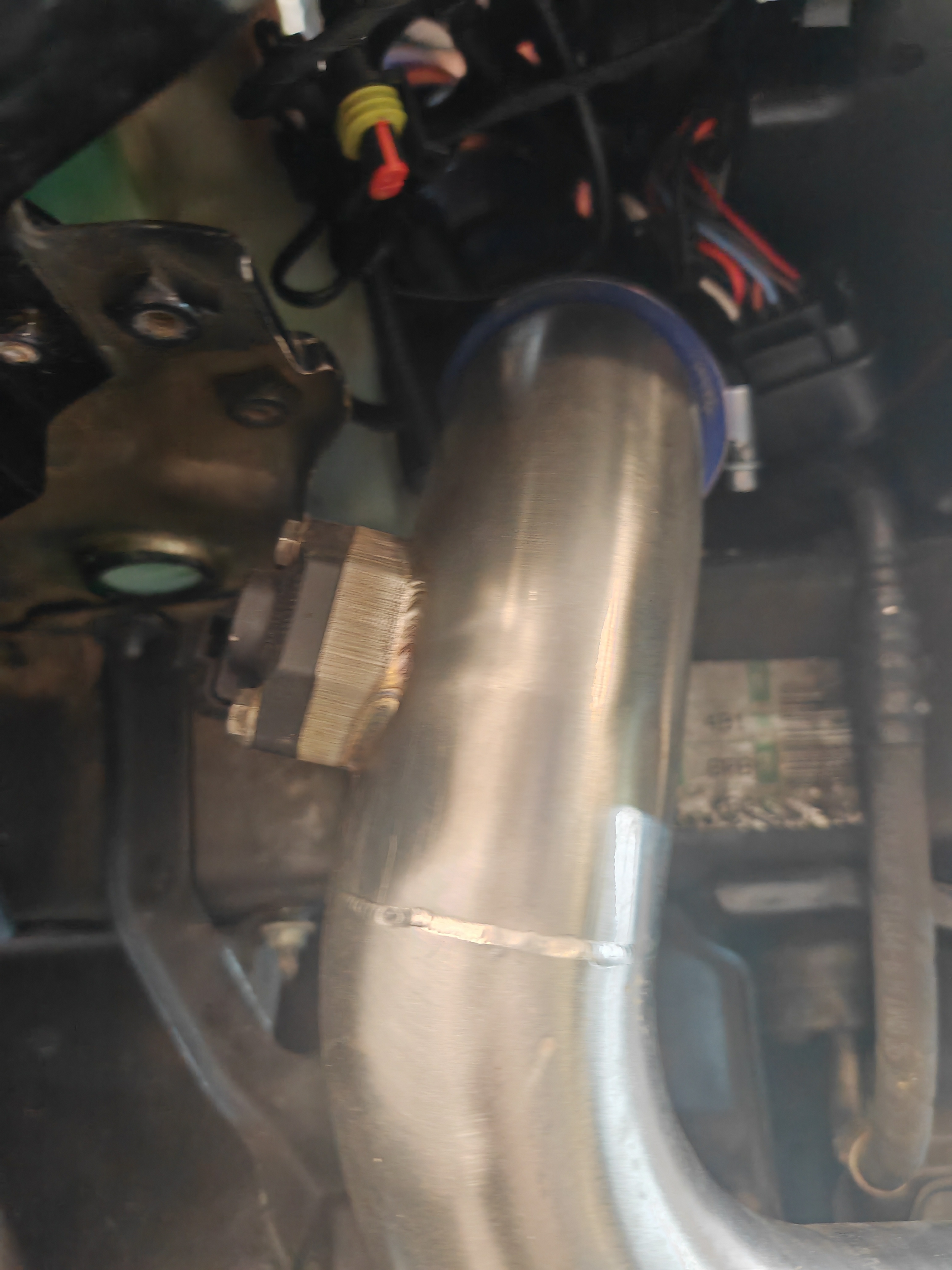

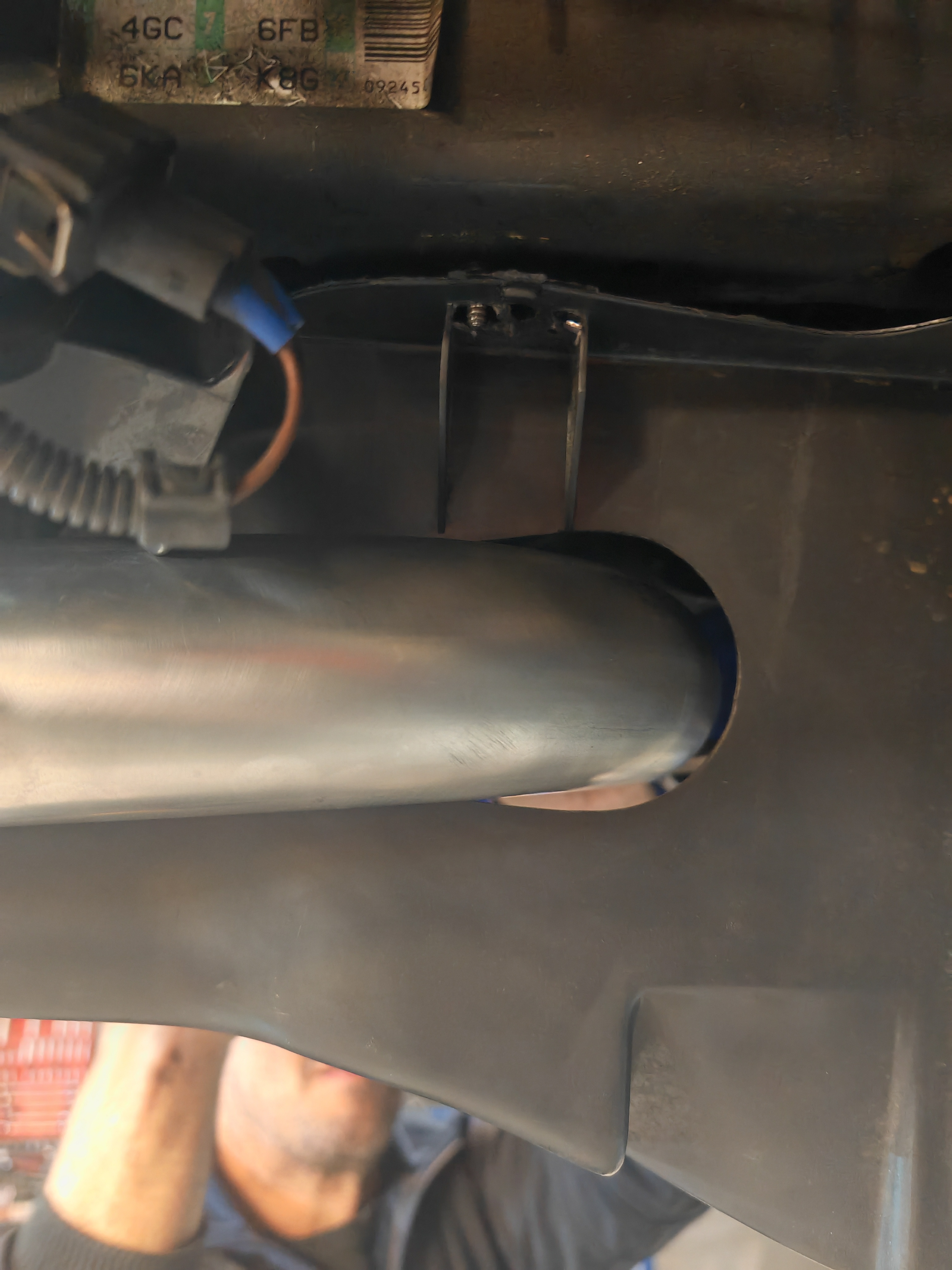

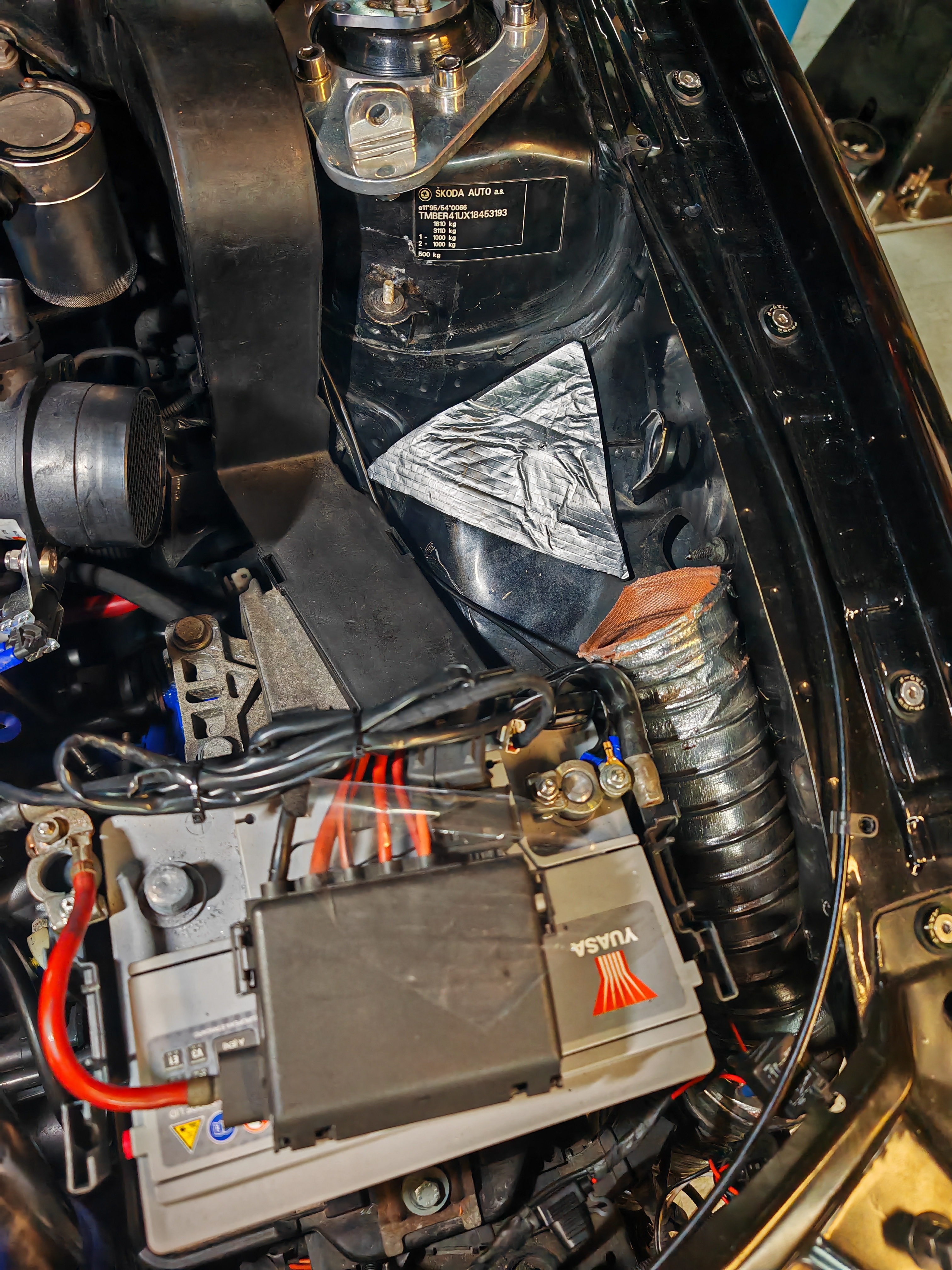

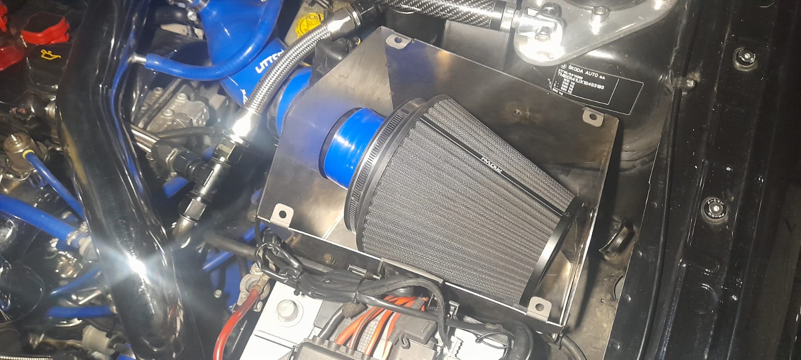

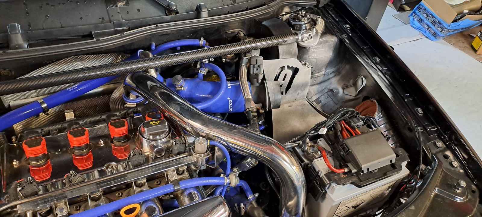

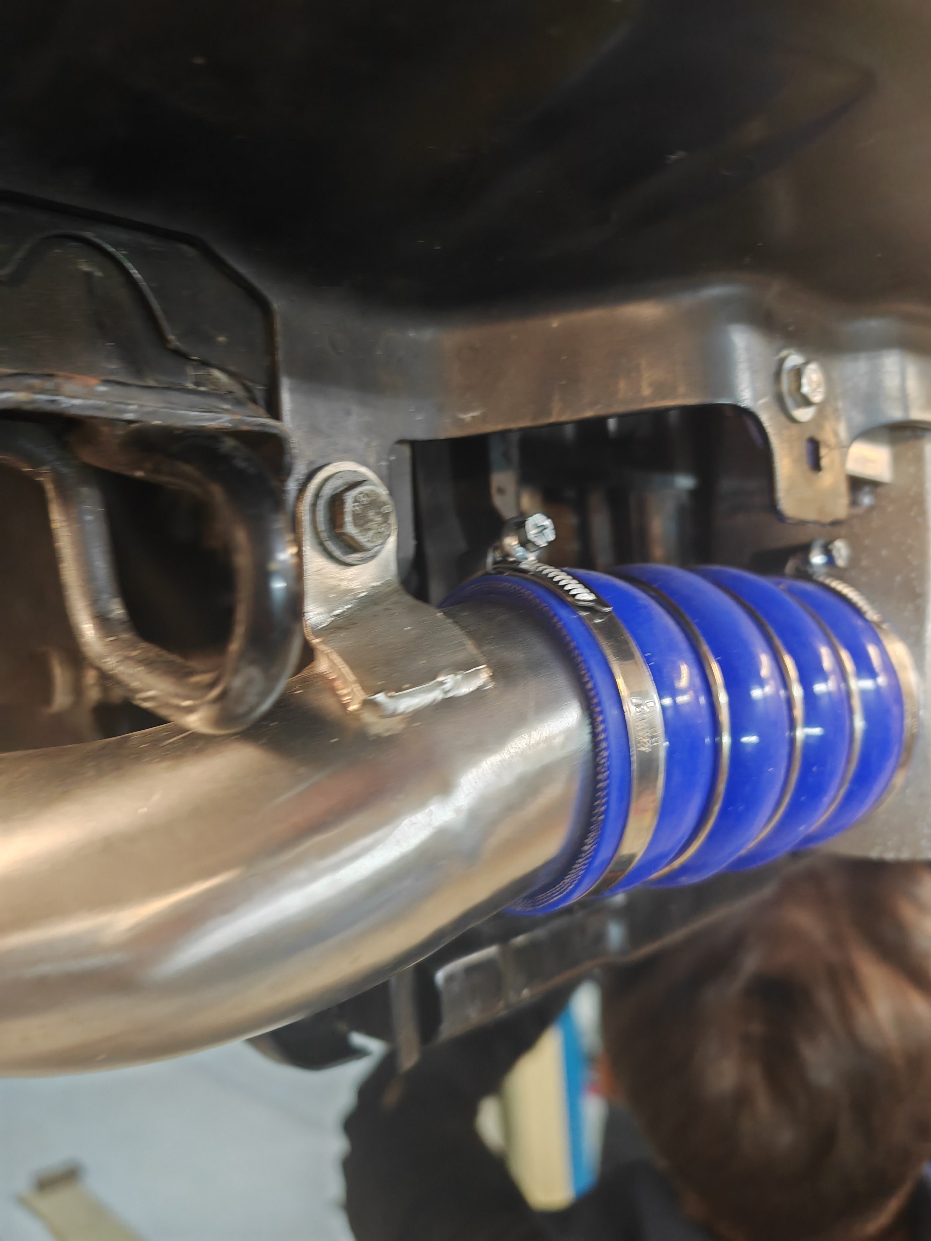

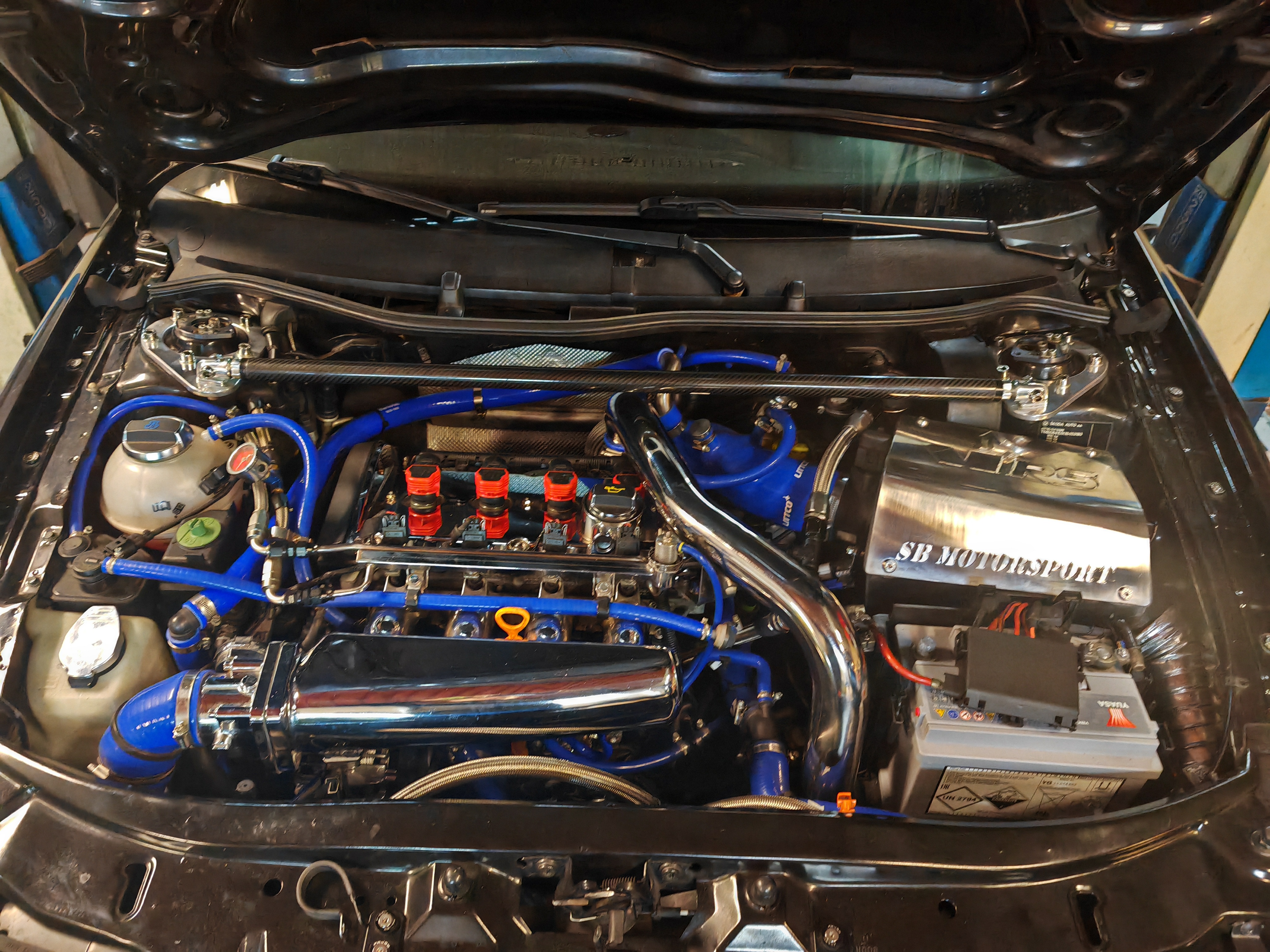

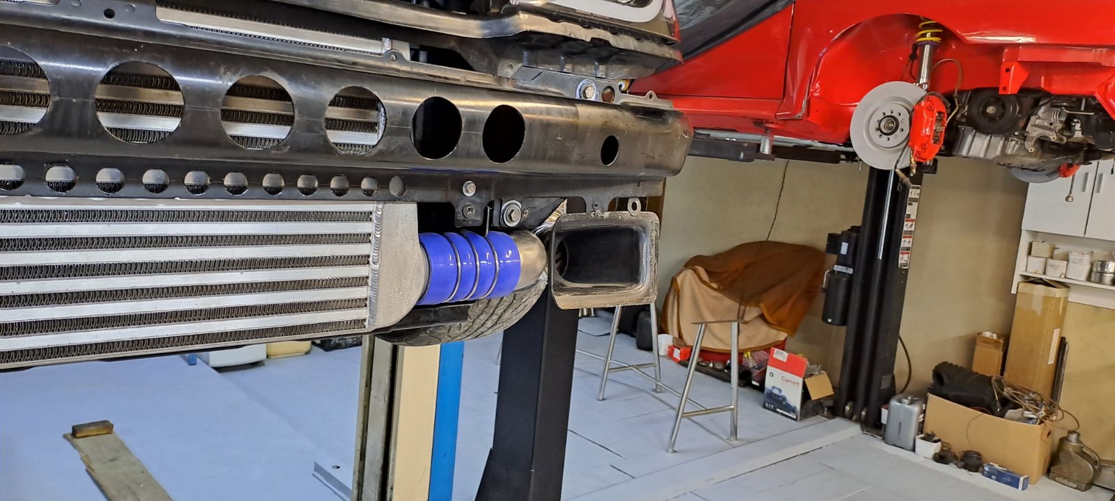

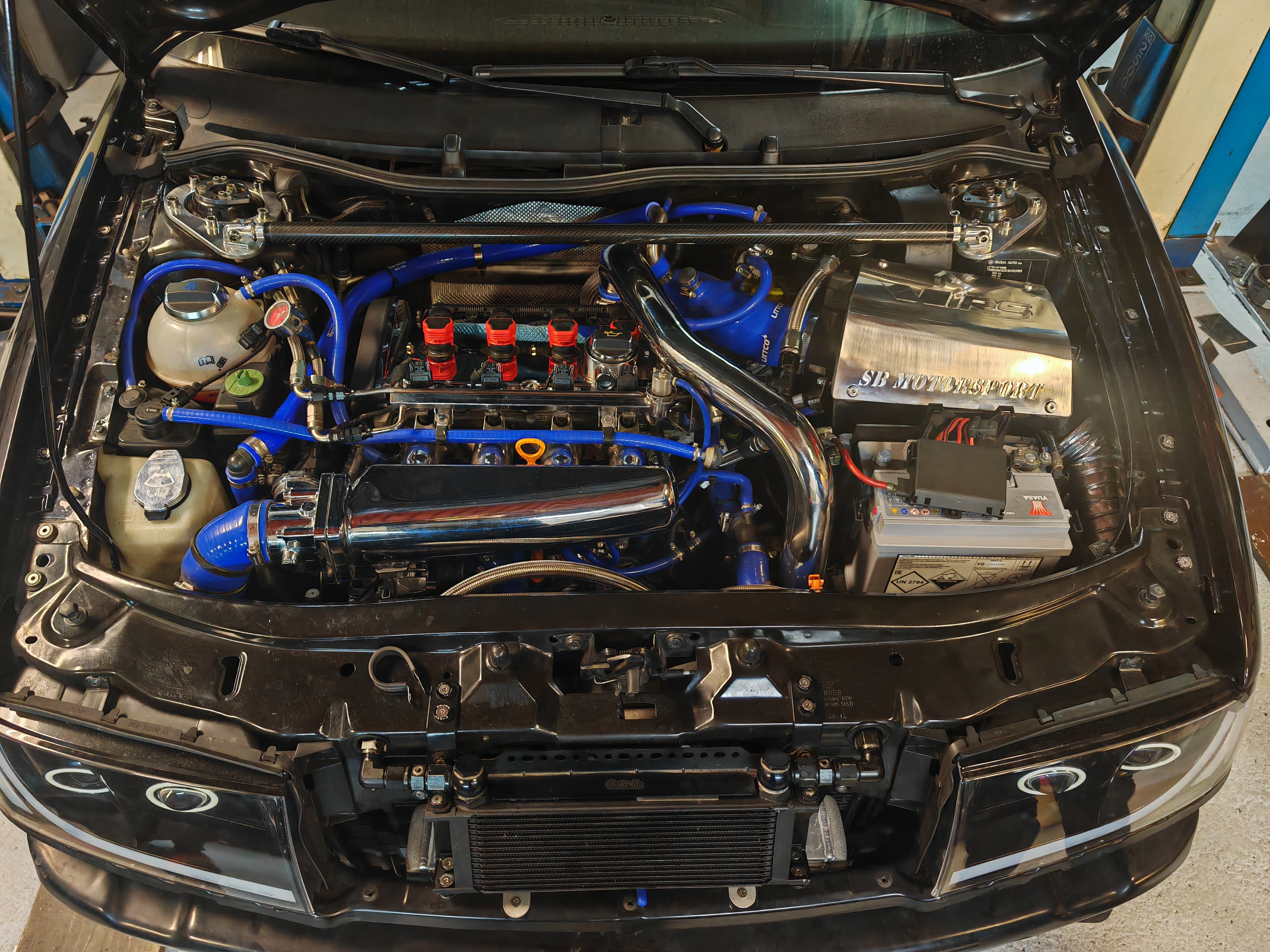

So first imopession in short. What a monster. Garrett core and new 2.5" pipes are not cooling air but freezing according to IAT on my MFD!!!! Perforated crash bar and bumper are doping its Job together as air tanka difussors as HP PERFORMANCE does im Germany.

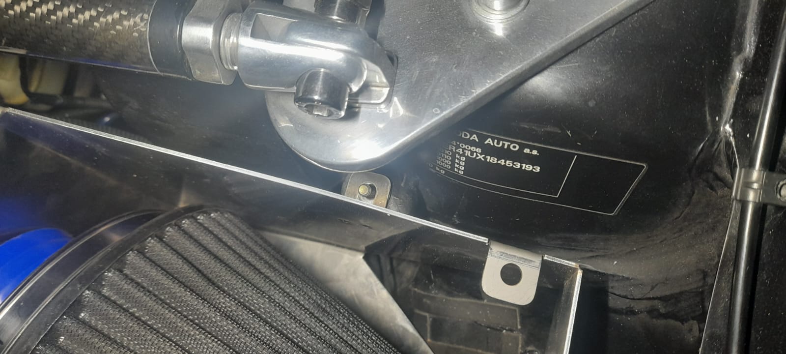

Air box is done perfectly.

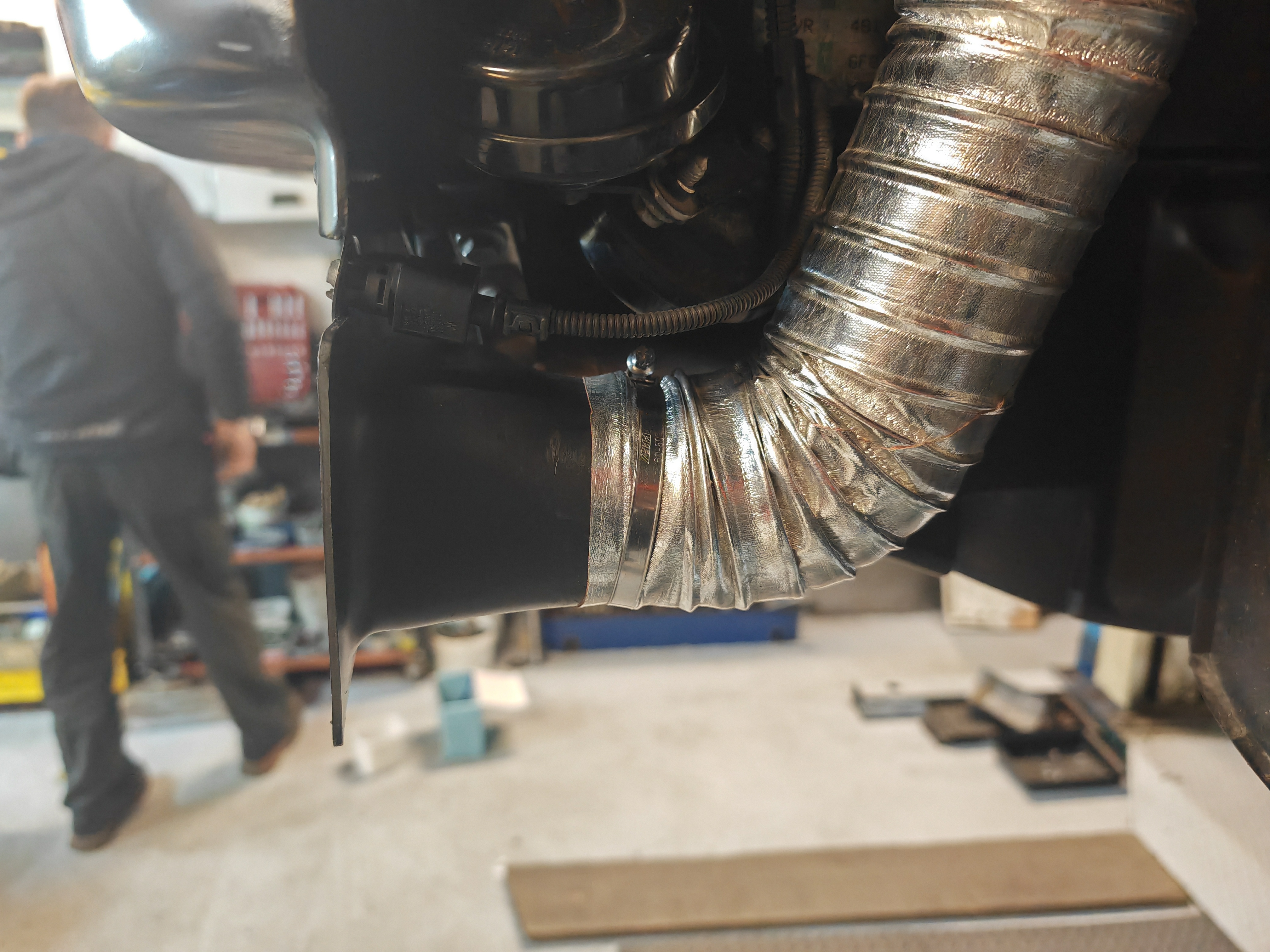

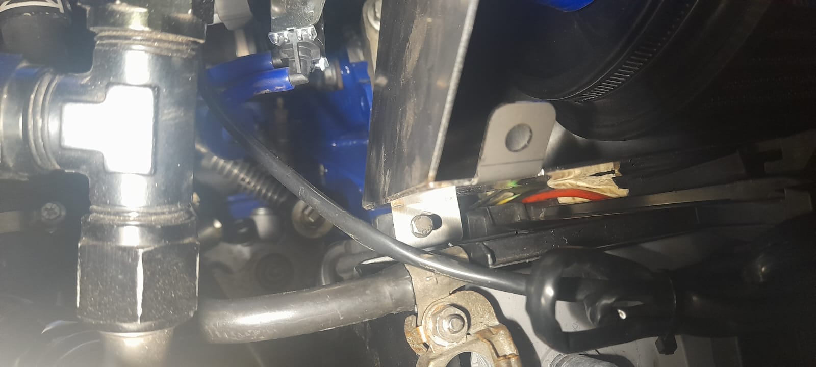

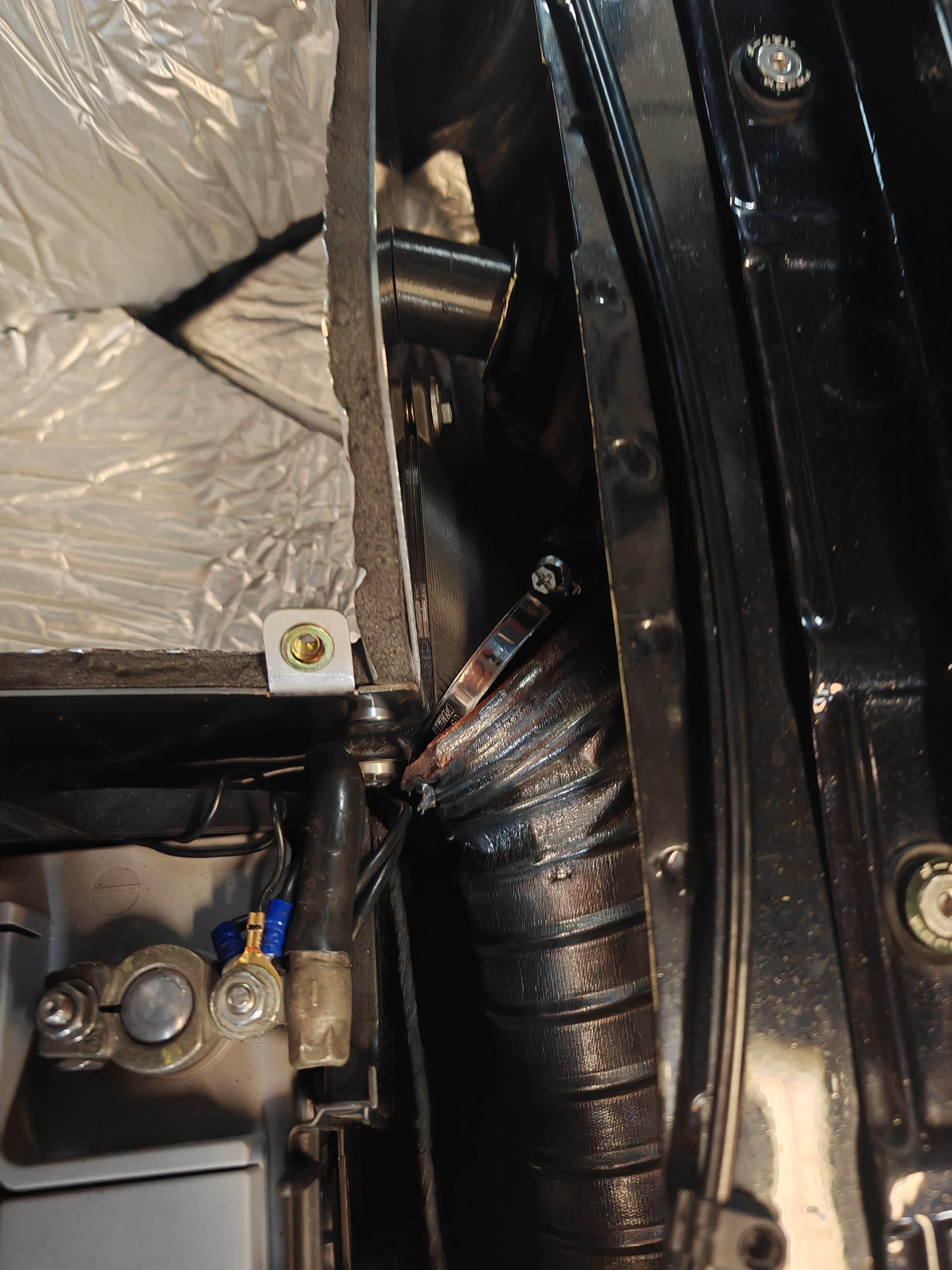

Whole box is thermo insulated from inside, also on chasis small part. 3d printed Rubber shock absorber as OEM one and air inlet-fully closed system. Cover is cut for VRS and motorsport insignia and to avoid black adhesive Rubber to be seen thorugh the cuts we did put silver reflective adhesive film on Rubber and so we have function and aesthetic result. We had to shorten a little velocity stack and angle the cut to retain filter in centered position and removed rubber from the side close to batterry,and Will put it from outside-gaining 1cm od extra space for air flow. Perforated crash bar is Great as newly cut bumper and Audi RS style big mesh.
