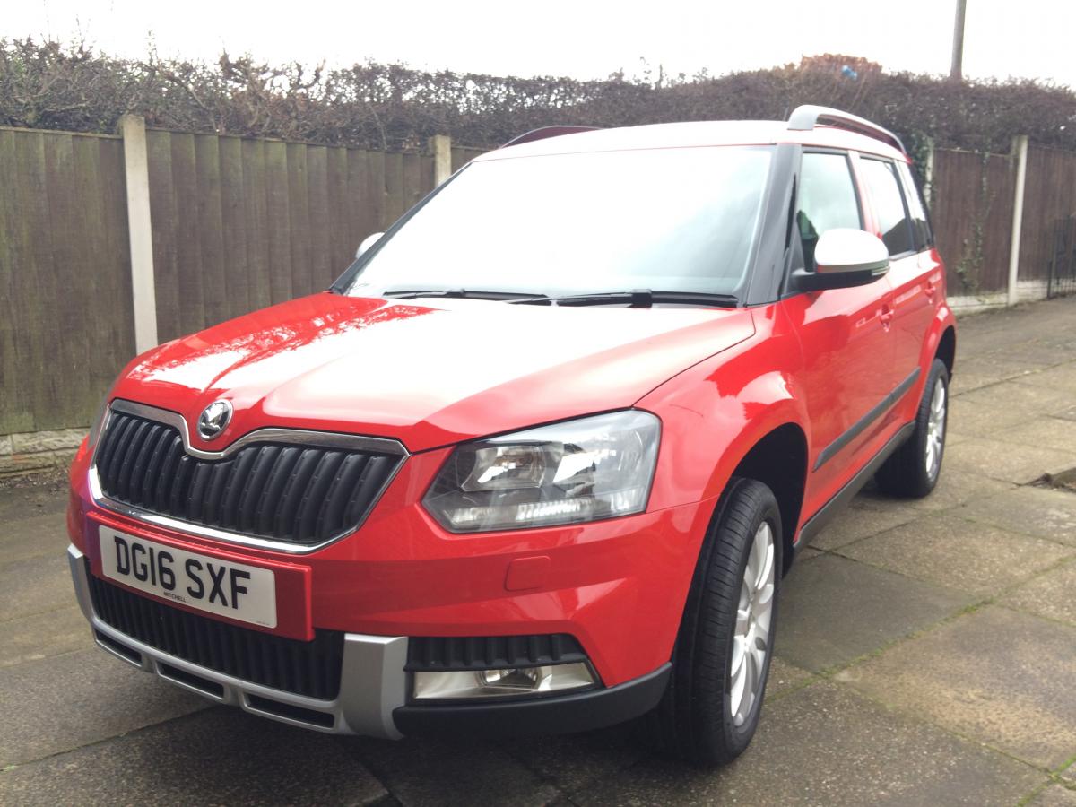

As your Red Yeti leaves, mine arrives  :clap:
Edited by DarrellGB
