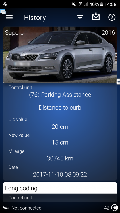

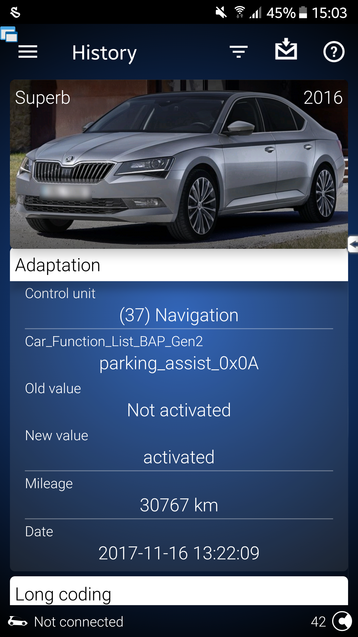

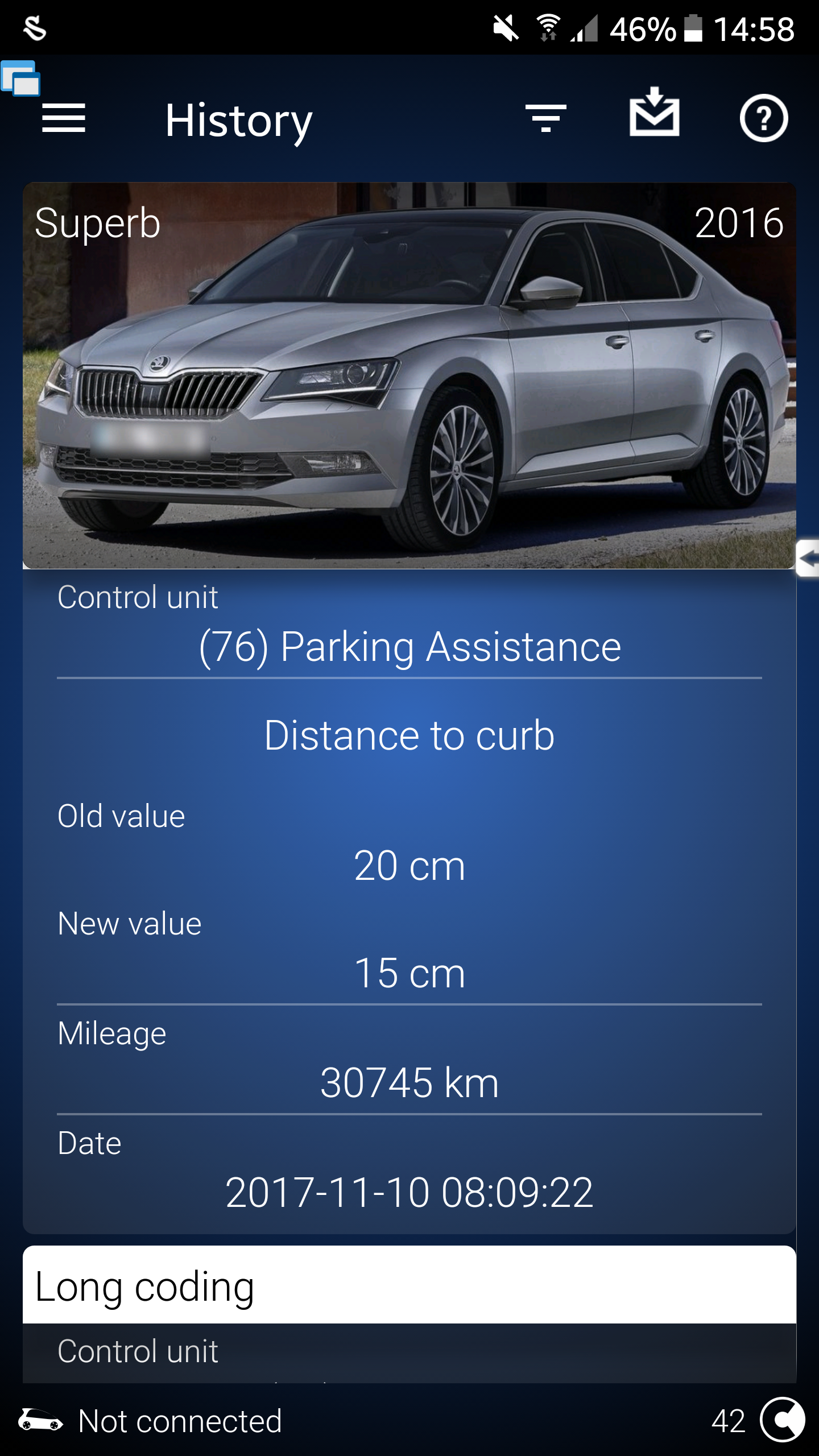

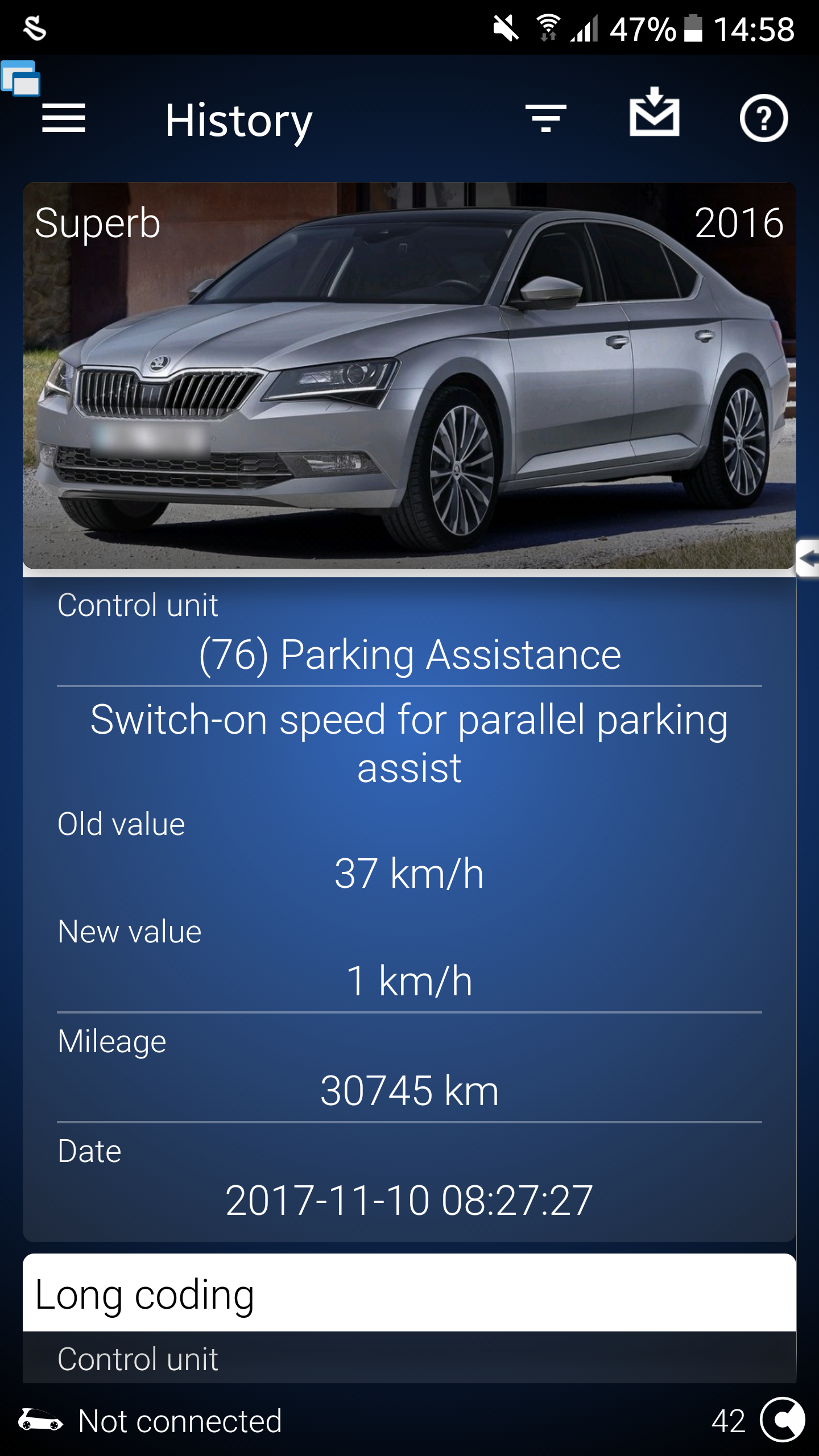

Hi guys
   could somebody help me please , I have Skoda Superb mk3 L&K 190.
I was trying to do some coding with some success but I think I missed something on the others
When car in reverse gear I cant see park assist sensors visuals on my Columbus screen.
I am able to hear them and mirror is folding as well just not visuals. I was trying to put all setting back according history log ons from OBDeleven app but without success.
Another thing is my Park assist is giving me message currently not available, I have checked distance from curb, I put everything back as it used to be and nothing as well.
Did somebody has similar issue.
Please see attached pics and history log ons (old volumes are back) not on pics.
Thank you

What changes have YOU physically changed and what has the app done?
I ask because in the history there are MANY changes that really should not have been touched as they should have been activated (or not able to be coded as there is hardware missing from the car) just one example (of several):

I have UK L&K then if understand correctly it should be std fitted. Something which you can see I was just trying what it does and then I put it back again.
So you physically made every change yourself?
Not sure which other ones do you mean but most of them I guess.  those ones on history. Some of them i just tried and then changed them back straight away
