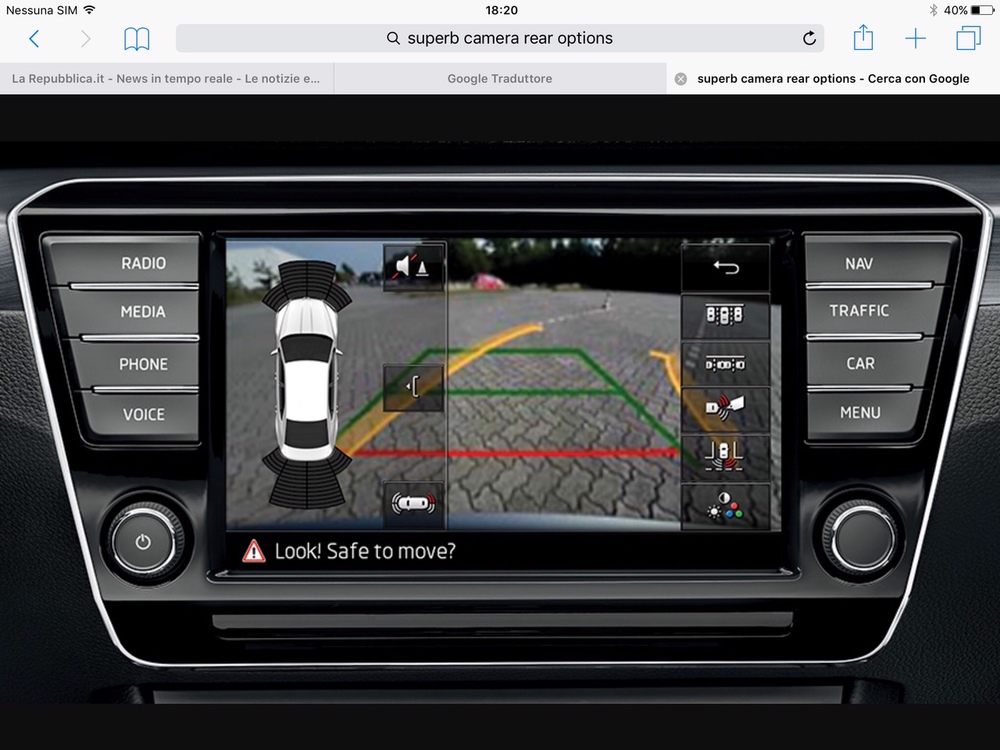

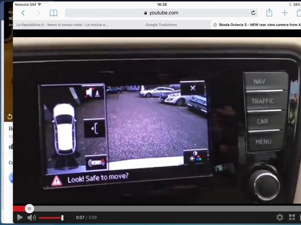

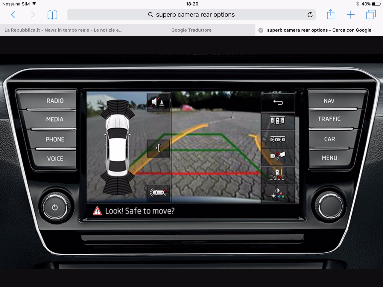

Hi everybody!
I was wondering, by comparing the RVC (rear view camera) images as seen in Octavia III (my2015) and Superb III (my2016), if we may have any way to mod the actual car configuration (by using VCDS and/or obd11, I have both) in order to add to OCtavia the "alternative view modes" (see attached images, there are 3 buttons on the right side of the camera image) that are available on the Superb.
Does anybody know anything, or has somehow tried to code this modification? Any input/feedback is welcome!
