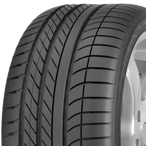

A directional tyre should be marked along these lines:
And might look like this (note the typical 'V' pattern):
I have never bought directioanl tyres, but I would assume that if you purchased a set of four, you would need to purchase two 'left' ones and two 'right' ones in order to ensure they were all running the right direction (the ones on the left rotate anti-clockwise while the ones on the right rotate clockwise).
Non-directional , asymetrical tyres might look like this (note the change in tread pattern across the width of the tyre):
And should be marked like this:

Care to show us a picture of your brand and model of tyre? The "outside" marking usually means they are not directional. Outside to outside has them rotating in different directions on each side of the car.

'Outside' visible on all four of my 17" Dunlop SP01, and the treads all face the same direction. If you fitted the tyres the other way around, with the 'outside' marking facing inwards, then the treads would not match!
In simple terms, these are 'directional' tyres then?

But if you swap them from side to side, they still have the 'Outside' outwards and still have the tread pattern consistent from the outer edge to the inner edge but they will be rotating in the opposite direction therefore making them not directional. Directional tyres are designed to rotate in just one direction.
Tyres marked with 'Outside' (and no arrow indicating rotational direction) are designed to rotate in either direction on either side of the vehicle. No one has yet posted any authoritive links to whether it is 'good' or 'bad' to swap non-directional tyres from side to side (referring back to the OP - mistake noted in later post) or indeed from front to back.
Directional tyres frequently (but not always) have an obvious 'V' pattern designed (among other things) to move the water from under the tyre to the outer edges and away from the tyre thus reducing the likleyhood of aquaplaning. For a brief and non-technical explanation from a reasonably decent source read this.

people are getting very confused here - a prime example of a directional tyre are those fitted to tractors they have a simple <<< pattern with the <<< facing the same way on each end of the axle.
The only way you could take a wheel from the right side of the axle and place it on the left (and retain the correct directional tread pattern) would be by placing the outside face on the right against the hub on the left.
We have asymmetric tyres on our cars where the tread pattern is not the same across the full width of the tread - hence the marking on the outside of the tyre which says "outside" - it doesn't say leftside or rightside.
Just imagine what happens at the tyre fitters, they take all the wheels off and regardless of where they are going to go back on the car they ensure that the outside of the tyre is on the same side as the pretty bit - and not on the hub side.
Now if you take a wheel off the right side and place it on the left the outside of the wheel is still on the outside, but rotating in the opposite direction.
This is perfectly acceptable.

Dunlop SP01 are asymetrical tyres, they are not directional.
