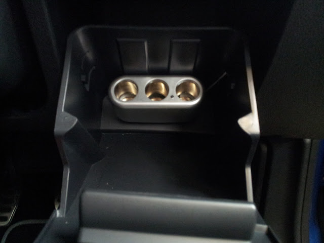

First here is the driver side storage compartment (before)
12V Multi female 12V socket adaptor (with brightest LED known to man)

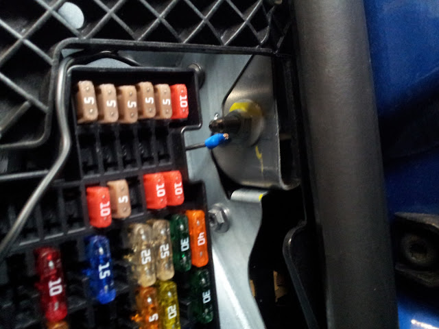

Remove fuse box cover (slot for ignition key at bottom to release cover)

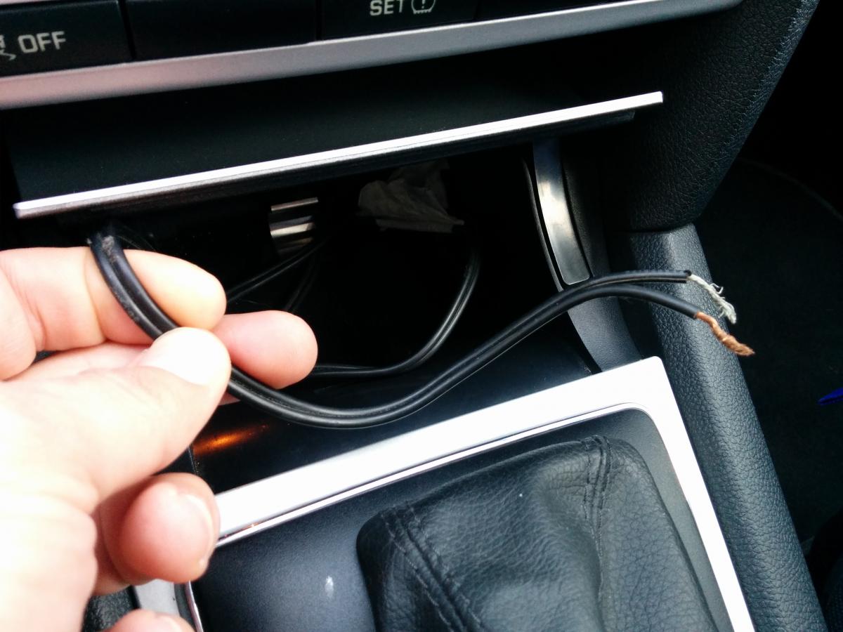

Cut cable of 12V adaptor near male plug end
Feed cable through hole in side of storage compartment
Feed wire through gap in side of inner dash towards fuse box
Pull wire through fuse box compartment
Cut off and attach a piece of double sided 3M self adhesive foam to back of 12V multi adaptor
Mount 12V adaptor to lower back of storage compartment
Split 12V adaptors cable, strip and crimp a fork crimp to negative cable
Loosen metal nut on bulkhead with 13mm spanner
Insert negative cable with fork crimp and tighten nut
Strip positive cable and insert into in line crimp on blade fuse piggyback adaptor and crimp it securely in place
Remove rear wiper 15amp fuse (ignition switched live) and insert in rear slot of blade fuse adaptor and a 5amp fuse in front (fuse info below) ***To be sure on which position for fuse in blade fuse adaptor: Remove fuse for position to be used and test in each position whichever one it works in will be the primary fuse slot and the other can be used for the new fuse being added.***
Insert blade fuse adaptor back into rear wiper socket in fuse box
Ignition off (visual check)
Ignition on (visual check)

There ends the first stage of installation and now I routed the cable for my current camera (soon to be replaced)
Camera mounted on windscreen having fed plug through top of driver storage compartment, through fuse box
Cable fed into head lining at top of windscreen (only visible wire)
Cable fed behind trim on front pillar to right of windscreen emerging at top of fuse box
Slack of cable stowed in cavity and final view of fusebox before replacing cover

***EDIT***
As the fuse box layout in my manual is utterly incorrect by sequence and allocations I have rearranged the original fuse layout card in a rather pikey fashion (MS Paint cut and past each one, took forever). Assumption is card supplied refers to LHD cars not RHD so all lines are back to front. Numbers are irrelevant as they do not correspond with the owners manual regardless of which order but symbols to locations are correct for my car now.
The following is correct for my 2011 Octavia II FL CR TDi anyway (yet I have some extra unlisted fuses in car): I am printing it out to keep in car.
Before
After (This now corresponds to my fuse box as I look at it holding card upright)

The purpose of any fuse is to protect the wiring and not to protect the unit it serves. Fire risk.
Most of the installations I have seen on this and other forums use a 5A fuse. The cable is usually a small computer cable with a mini USB connector. The cable is rated at around one Ampere.
So if your cable is cut on a sharp edge somewhere or damaged by over bending, the cable will overheat before the fuse blows.
The Möbius camera I will be installing shortly takes a maximum current of 530mA when charging and recording simultaneously. The worst case efficiency of the 12V to 5V converter is 80% so I will be using a 1A in-line fuse immediatly after the 5A fuse in the tap connection.
I urge you not to use any fuse that is larger than the cable rating. Some car fires have identified this as a possible cause.
One solution worth considering if you are using a cigarette type socket is to use a plug that has a built in fuse. This can be changed to say 1A.

Good morning,
I lesten to your advise and ran new wires from fuse box (didn't connect yet) to my new location.you can see my cable thickness (picture attached).
And this is what i want to order http://www.amazon.com/AVANTEK-3-Socket-Cigarette-Dual-Port-Computers/dp/B00F474DVG
And like you did, cut of the plug that go to the cigarette socet and connect the plus to the red wire and to the fuse tap holder and the black wire to the ground.
I don't know if there enough amper for my needs ,the kinivo and only the usb splitter is 4.2 a.
Your cables look like they are good for at least 5A.
The Amazon link to the Chinese product has misleading text. They say it is good for 120W which is presumably at 24V (so 60W or 5A at 12V) but the fuse in the plug is 2A.
I assume they had to fit a 2A fuse to protect their cable, which looks smaller than 5A rated cable in their picture, or to protect the circuits that produce the 5V for the USB power outlets.

Work out how much current draw you have & select wire gauge, fuses and other hardware accordingly.  Watts = amps x volts  Here's a calculator
I run a garmin Nuvi GPS & a yumcha dashcam off the same circuit and only use a 2 amp fuse.  Even if I plugged my phone in it would only draw 7w which is about 0.6 amp (or I've got my calcs totally wrong)
