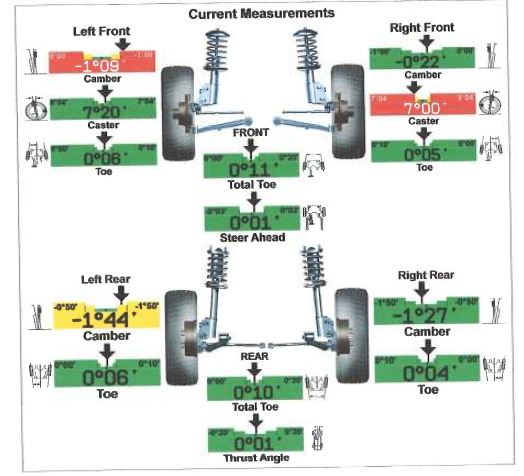

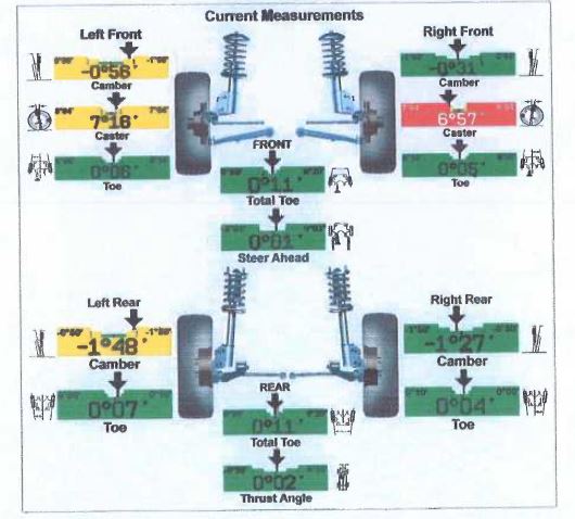

I have alignment pictures, but to me the latest ones look worse than the befores.
Pic one was just a check and before and after (pic 2) the steering wheel was perfectly straight.
Pics 3 was straight after new tyres and pic 4 is how the car is now, with the steering wheel not perfectly straight on a straight road.
They have checked it another 2 times since and still the issue remains. Something they are missing? Perhaps these tires are just more prone to camber?
Cheers for any advice!
They have totally mucked it up. all readings should be green. Get your money back and go to somewhere that knows whay there doing.
Completely agree with the above. Either go back and get them to do it "properly" or demand your money back. That said I personally wouldn't trust them to do it right now if that is what they have let you leave the workshop with
Edited by Berniebloke
As others have said,get your money back & go elsewhere as that final print out shows,all is not well with the alignment & they should not of sent the car out like that.
Looks like the only thing they've adjusted is the front toe. The rest is out. As above, money back, go elsewhere.
That must be the worst alignment on a Hunter rig ever!
Just goes to show that having the correct equipment means nothing if an idiot is operating it.
Get your money back and go somewhere else that knows what they are doing.
Sent from my HTC One X using Tapatalk 2
Not only should all the readings be green, you want equal toe and camber each side on the same axle, with the readings as close to the centre of the range as possible.
You should have readings of 0.00 for steer ahead and thrust angles.
