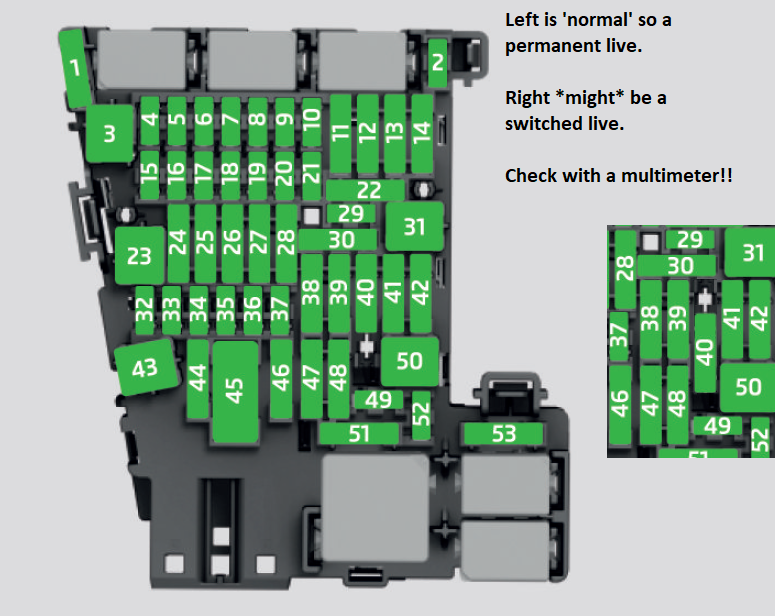

I've just checked the wiring diagrams for pre-FL and FL cars, both 12v sockets are powered directly from the car battery via fuse SA1 then SC40. It's impossible for the car to turn the sockets off when the battery gets low :)
I can only guess that PetrolDave's coolbox had some internal smarts to stop it flattening the battery...?
Oh man thanks @langers2k
relay project box going in for that based on the ignition being on for these!
Does the diagram show they both flow from the same cable? or do I need to sort two of them?
I think that SC40 might be a slightly special fuse as there are two positions for it...

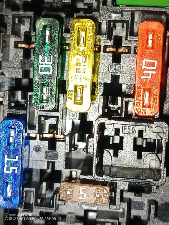

Damnn, will check and report back....
Whoever wired up mine didnt bother with that power 15 terminal on the backside.. but does seem to be the correct fuse. May see if I can add the recepticle and wire it in :)#
Youtube clip for a MK7 Golf which is similar electronically:
There have been many posts on here asking about making the 12V sockets ignition switched and the outcome seems to be that the 2 positions for SC40 are wired in non-UK cars but on UK cars the ignition switched position is not wired at the factory.
So the solution seems to be a piggyback fuse into a switch ignition position with SC40 removed and the flying lead plugged into the SC40 outlet side.
That would seem to be a solution too!
