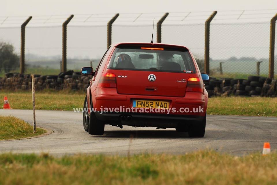

 I managed to get to a sprint event at Barkston Heath on Mothers day and really enjoyed my day out. Our best time was 58.4 seconds to travel 3/4 of a mile on a twisty track. The journey there was quite harsh, bucket seats, hard suspension and no sound deadening at all, however the drive home was even worse as I was really tired and it felt twice as far as the journey there.
 The car did give me some issues and I have to sort them asap. The first was a strange one, when sitting waiting for each run the revs would build to about 2,200 rpm on there own, pressing the clutch pedal down the revs would drop back to where they should be, a second or two later and up the revs would go again  :think:   A quick diag with VCDS and no faults found, reset the throttle body and no difference either, next I am going to replace all the vacuum pipes as they look poor but I can't make the link between the clutch pedal sending the revs back down, am I missing something simple?
 Anyway, here are a few clips of the runs at Barkston and as you will see I was a little giddy  :blush:
and a photograph I have borrowed off the net showing a little air beneath the tyres too.
