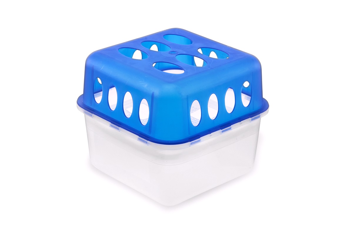

After problems with fogged up windows last winter I bought a "minky" moisture trap from Asda for a fiver ,
it is the perfect size to fit the bottle holder in the door pocket and has completely cured the mist problem in my 09 estate.
No more waiting for the heater in the mornings.
Just had a look for one of these - did you get the 75g one or the 200g one?
I just bought a 450 gram moisture trap with one refill package for ~£3 and the thing works great.
No condensation on the edges of the rear window anymore.

I got the 75mg one which comes with just one tablet (Asda £4.95), so far it's still working and I recon it may only
have captured half a cup of water but it seems that's enough to make a big difference.
Last year condensation was a pain but not any more.
I did a bit of looking and the 200g one is huge, no way it will fit in the bottle holder in the door pocket.
As a result I just bought one of these (75g) off eBay...

It arrived!
It fits perfectly into the drinks / bottle holder on the MkII Octavia's front door pockets, it was almost as if they were designed specifically for the Octavia!
It arrived!

Glad to report my car has been condensation free since buying this.

Well, can't say I'm overly impressed with the Minky, the tablet is slowly dissolving but it isn't collecting much moisture and the misting of the windscreen is still present.
After some more online research these get very good reviews. I'm hoping the dehumidifier bags are the way to go, just buy decent ones.
