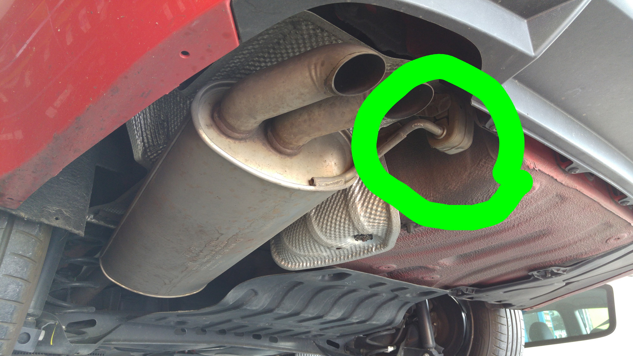

I'll do tests in the coming days, but I think the problem may come from here
Great thinking :) it surely can
No It can´t, i tried to push and pull or even hit the pipe with no sound or vibrations. The fixing is made of some rubber, so it dampens vibrations from exhaust pipe quite good.
You are right...I did the same test.
