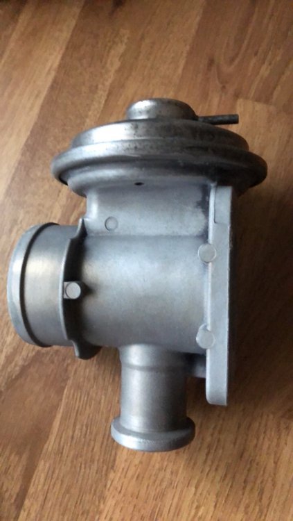

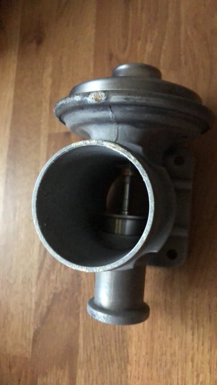

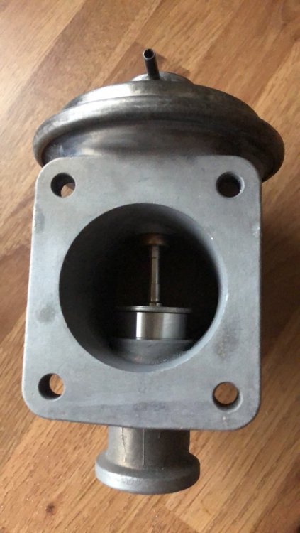

Just to help people....
You do not need to remove that corrugated pipe from the egr valve to get the whole lot out
All you need to do is remove the egr valve (3 allen head cap screws)
And remove corrugated pipe at the manifold.
This allows you to remove the whole shabang in a oner! Saves farting around trying to get those 2 cap screws under the egr which are a ball ache

I cant believe people still think removing the EGR is a performance upgrade, and its been made a sticky topic too!
Stop wasting your time and money, clean it but dont bin it!
Ask any (good) remapper, they will probably laugh or swear at you if you remove your EGR. Leave it on but let the remapper alter its cycle if required.
This article explains things better than i can.
http://www.tuneruniversity.com/blog/2012/05/dont-block-or-remove-the-egr-valve-its-saving-you-money/

EGR delete does not improve response / bhp
Possibly a coked up car going from a tarred up EGR to a delete kit will notice a power increase however.
The EGR delete isn't a performance mod, its more of a maintenance / prevenative mod to stop the inlet manifold clogging up.
I prefer the other option. OEM and MOT legal. I just clean the EGR out every 10k miles. If you do it when you do a service it requires very very little cleaning whatsoever.
And best part it is free... Well if you have the cleaning products
