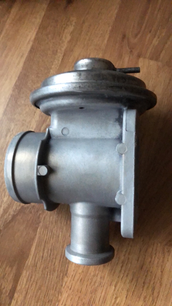

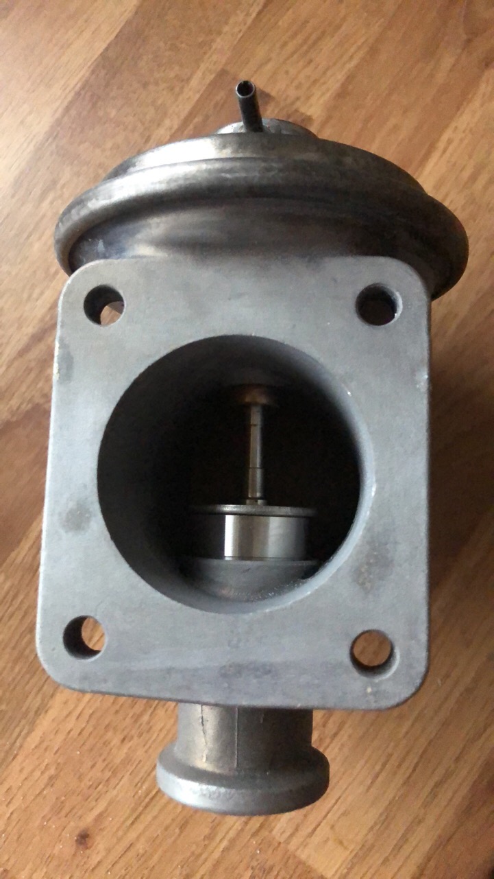

Just had my EGR off for a good clean - never been touched in 13 years and I was suprised how clean it was to be honest. Just a general gunging. I read here how it was hard to remove but to get at the rear exhaust connector bolt I made a special tool from a 6mm allen key and a 6mm ratchet spanner. Made it a doddle. I cut a 2cm length of key, pushed it through the ratchet spanner and held it so that about 7mm stuck out either side with a bit of glue. Now I accessed the bolts easy. For the bottom of the three manifold bolts I just used a 5mm 1/4 drive bit on a 10cm extension bar.

I took mine off because it was sooted up and the car was going into limp because of it, maybe a result of running on supermarket diesel. On the standard map, my perception was it made it lag a little more, but boost a little harder when it did, but when I say a little, I do mean a little.
Downside is it made the idle a little rougher on both cars, and threw a fault light on the 54- fabia (but not the 02- ibiza), both had the same ASZ engine, fixed as part of the remap I was doing anyway.
Personally, I'll keep running it, but If I were doing it all again from the start, I'd probably not bother but fit one of the little restrictor plates at the bottom of the feeder pipe instead.
