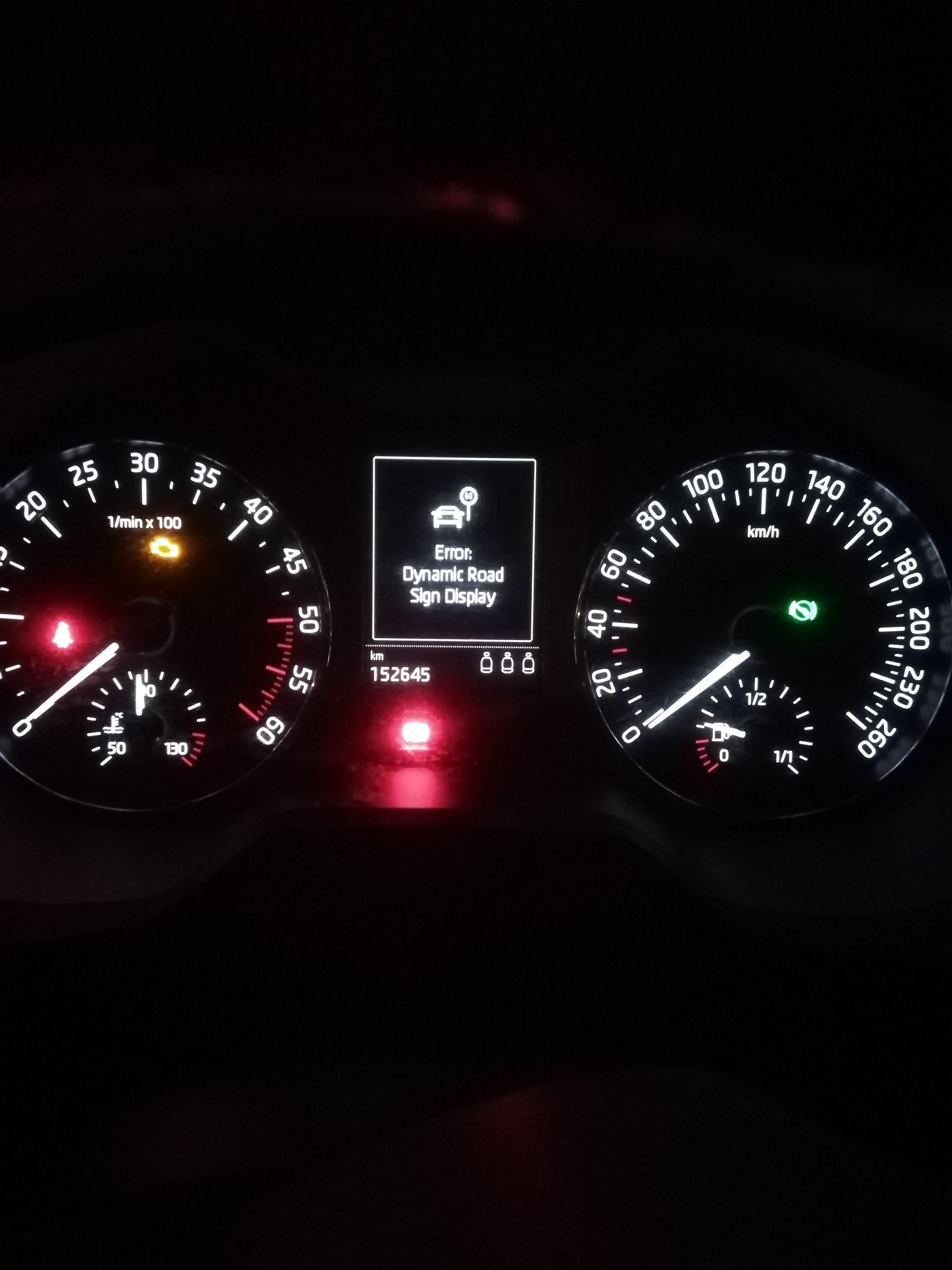

Hello,
I recently bought obd II cabel and vcds for my skoda octavia III and yesterday I tried to enable sign notification (I didn't know I needed front camera to work) and now I can not erase the error, when I turn the ignition on. I have turned everything back to standard (as it was before) and it still pops up an error. Does anybody know how to erase that error or disable the function? I have tried scanning and then deleting all dtc codes, but error is still there.
Thank you.
Looks like the maxidot is still set for tsr enabled.  Double check the settings to ensure you have reset them all, particularly controllers 5f and 17.
I wouldn't bother with it, I find it more of an irritation than useful, blocks out the VC clock.
I have tried several times to check and uncheck (in 5f and 17 channel) but the function is still "on". Is there any other option?
Still haven't solved the issue. Does anyone have a clue? Any reset of the ECU?
One thing occurs to me...  When enabling traffic sign recognition using OBDeleven or VAGCOM, after all the adaptations are complete the function is still not active.  It is necessary to enable it through the menu in the Columbus or Amundsen menu.  If it isn't set on though the menu, then it won't appear in the maxidot.
So I suggest that you could check whether the menu item appears in the Columbus/Bolero menu.  If it does, then uncheck the option.  If it doesn't appear, use OBDeleven or VAGCOM to add the menu item back, and then uncheck the option.
Once you have done this the traffic sign recognition is disabled and shouldn't appear on the maxidot.  You should now be able to undo the controller adaptations if you wish, and the menu item associated with it will disappear.
Try this and see how it goes.
