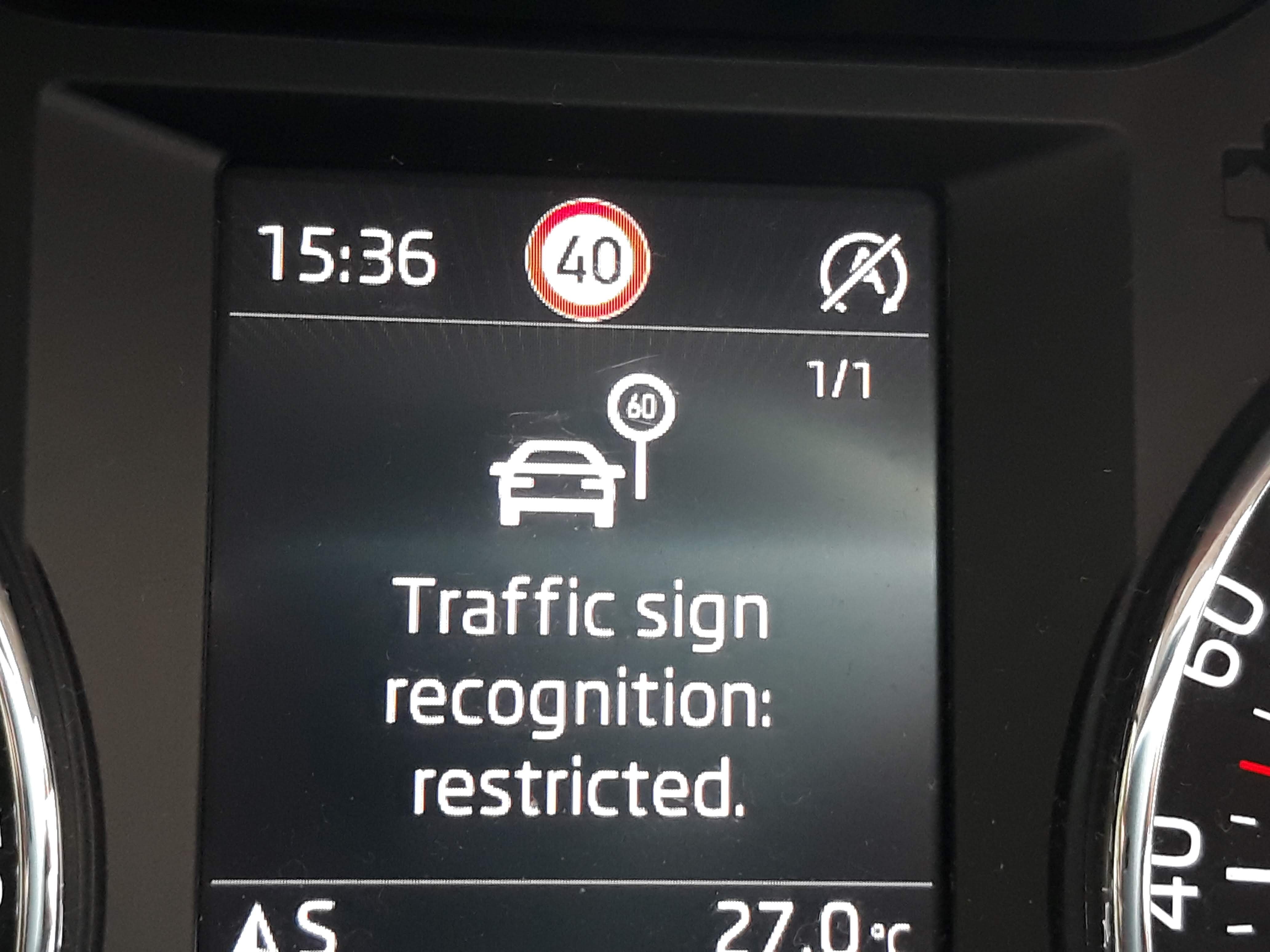

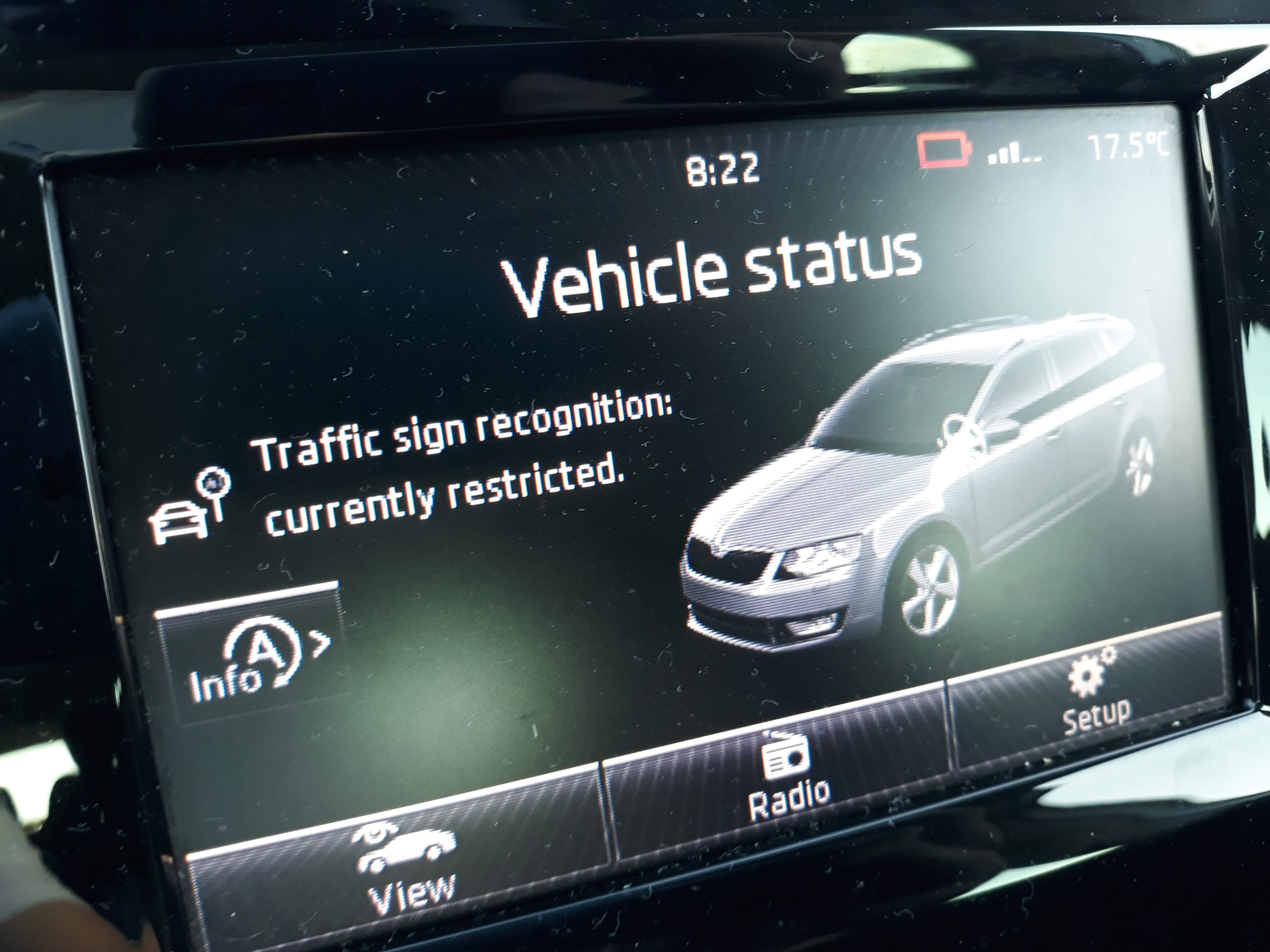

hey guys.. i have been following this forum for a while now and i havent seen (on this or on any other vw forum) that someone has found a working solution for this problem...

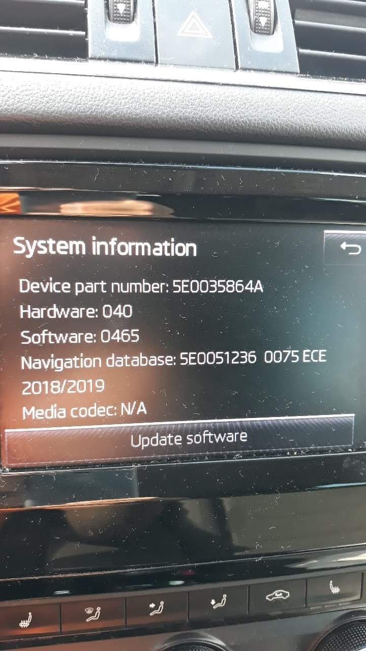

I have skoda octavia elegance MY 2015 with amundsen. Recently i saw on this forum this topic and since I have lane assist camera,thought that I should activate sign recognition, and I did.. asked my friend who has VCDS for a favor and after couple a minuts, it worked...at least i thougt so till the morning when I went for a longer drive :D
this is the current situation on my car and all the things I tried.

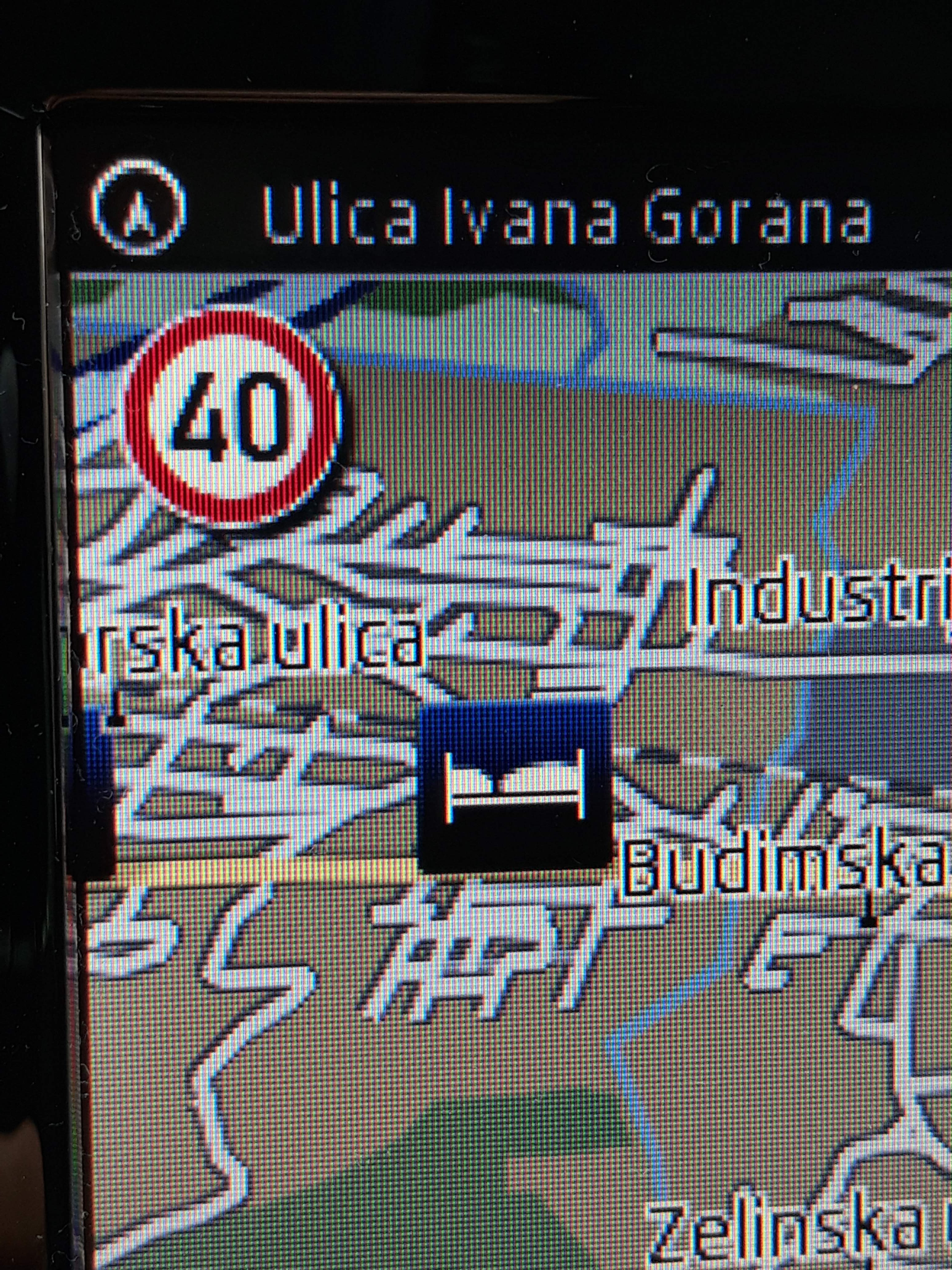

1.. Amundsen turned on... car normally reads signs on NAV and on MAXIDOT but I stil get recognition restricted message
2.. Amundsen turned on... SD card removed from MIB1... car normally reads signs on MAXIDOT but I stil get recognition restricted message

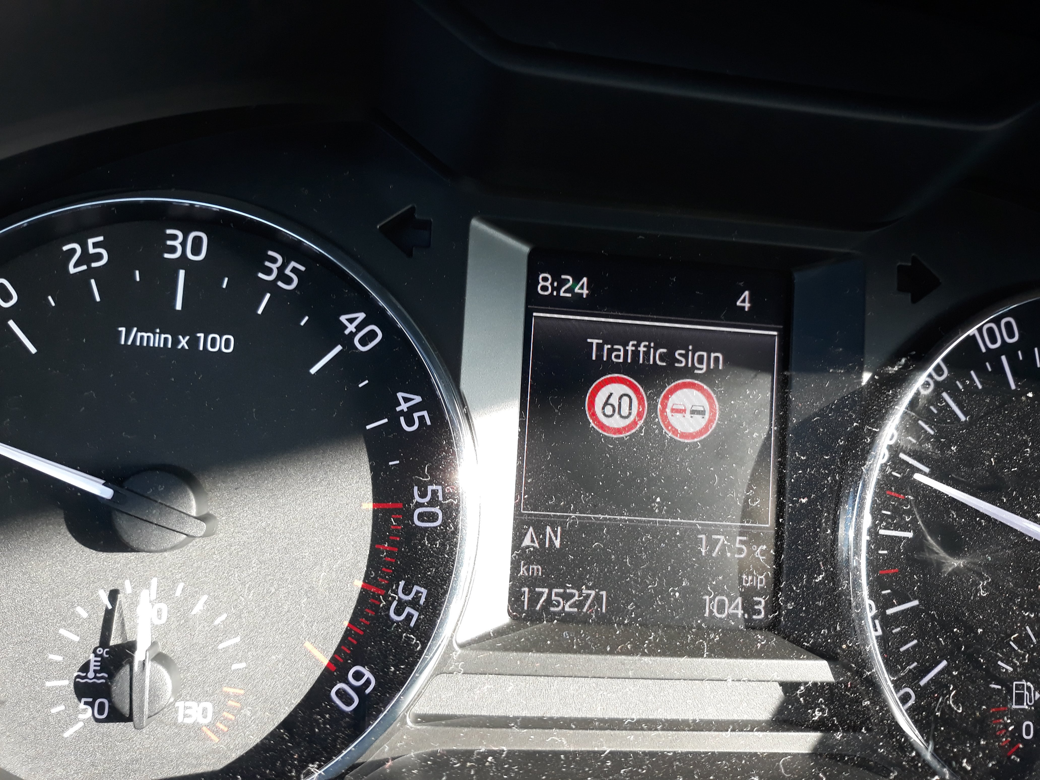

3.. Amundsen turned off.. car normally reads signs on MAXIDOT but I stil get recognition restricted message
4.. Amundsen turned off.. if a camera doesn read any sign for a couple of mins... stil get recognition restricted message
i think that I didnt forget any combination :)
also... when it recognizes no overtaking sign.. it does not remove it by default after some time even if I go to speedway for example. i have to turn off the ignition to remove it...
i followed steps for activation here on the forum, but have read somewhere that this does not work ok with MIB 1 ???
what am I missing here :) ??
SORRY FOR THE DUST :D
Edited by ShokreKTM
This is how it works on the MIB1 Amundsen, the only MIB1 that doesn’t have the restriction message is the Columbus.
