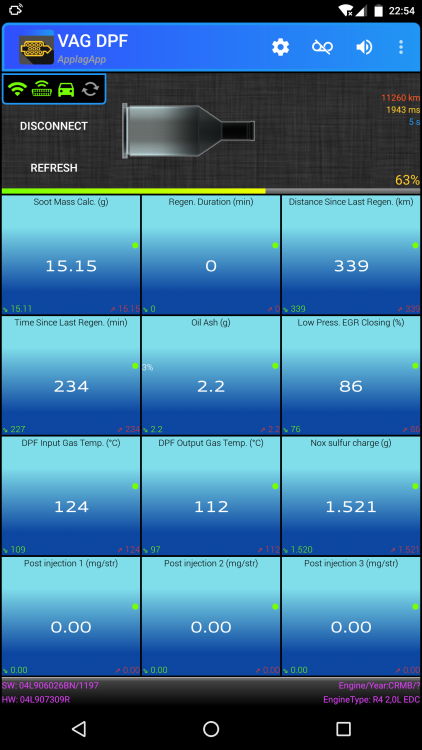

Redfab,
can you please confirm that I got it right - Oil Ash level is the permanent level of DPF being filled (3%), as result of regens?Where 63% is the soot level (equal to 15 grams)
Edited by TTodorov
Yep that's it.
63% and 15.15g of soot is how the dpf is filling up leading up to the regen.
Mine regens about 88% and 21-22g.
2.2g of oil ash is the oil what the regenerated soot converts to. That can't be changed. Mine is currently at just over 20g. 2009 1.6 tdi 45k miles.
(Unsure where you get 3% from)
Edit. See the 3% now. Never noticed that before. Going to check mine out now!!

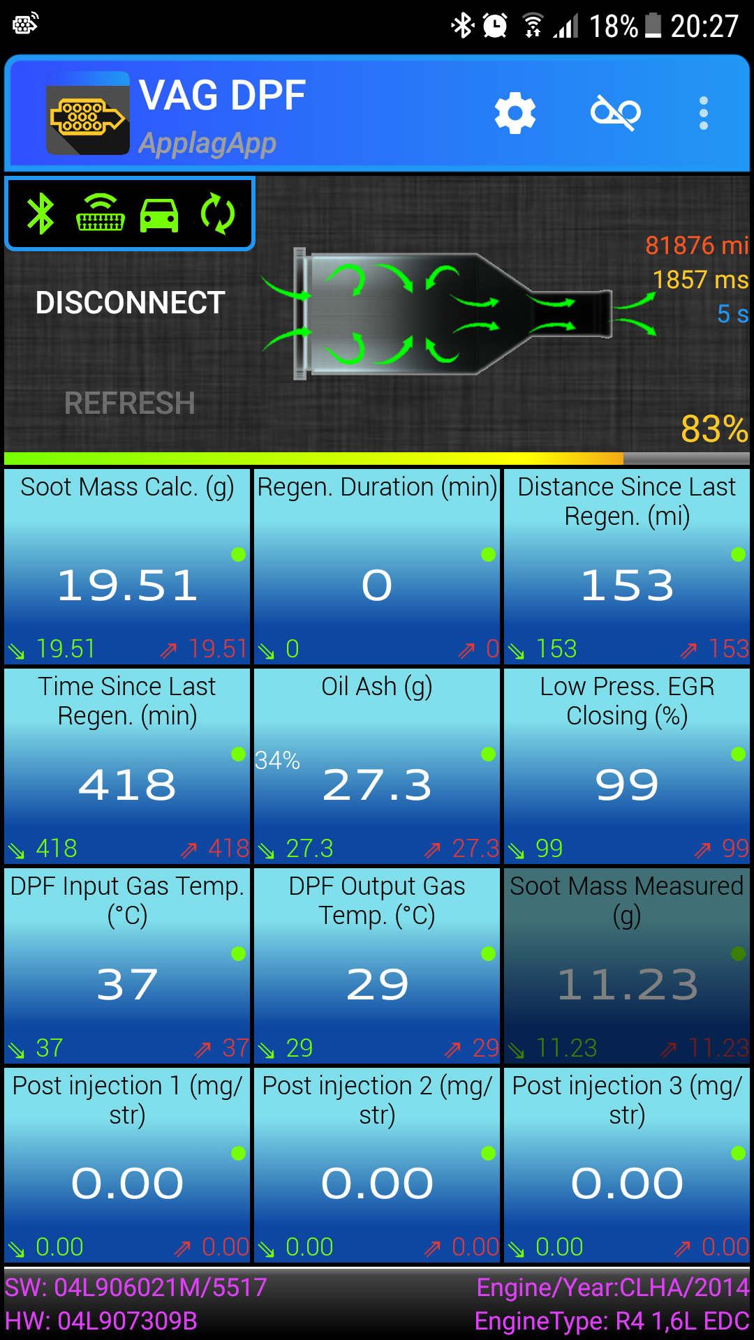

My car 2013 with 82k miles, my regen starts at 100% and oil ash on 27g
Can't see 3% too?
Edited by bakili
Found 3%, never noticed this as well
What's your oil ash % showing with 27g then bakili?
Mine is 29% with just over 20g.
I think TTodorov has quite a new car with just 3%.
Here my readout
@bakili
just in the same square where you see 27.3 for Oil Ash (g) has a percentage - yours is 34%
@Redfab many thanks! :)
