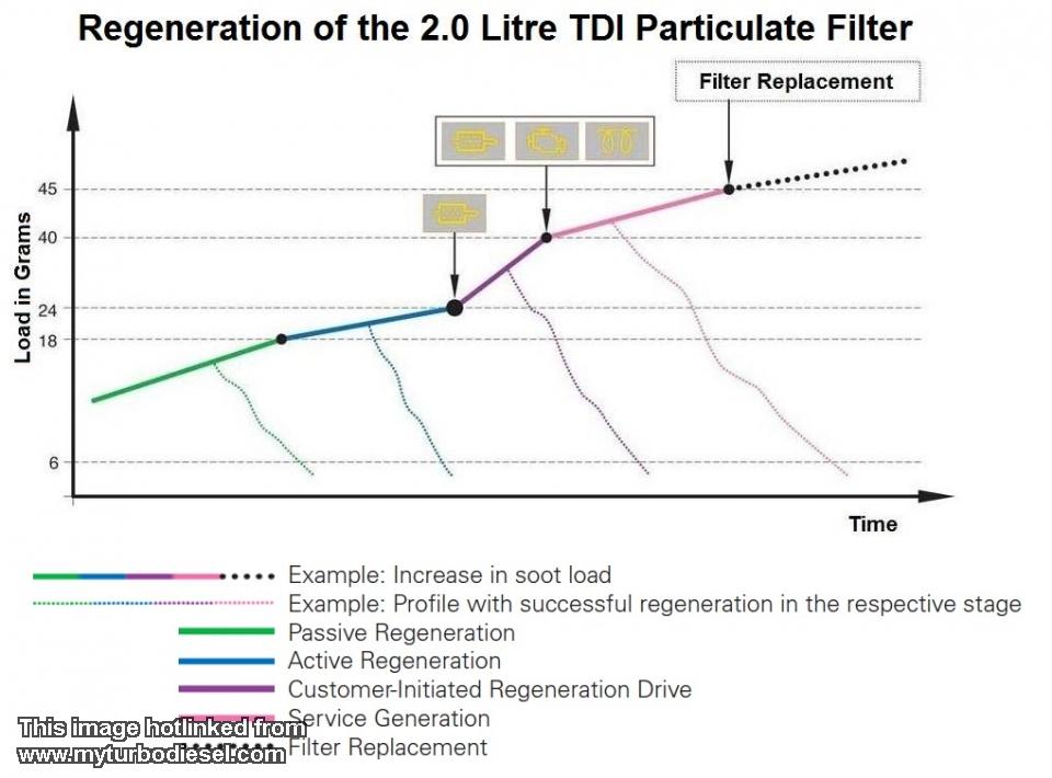

don't stress at first place (been there, done this)
it will do it's job, help the process if you catch it and if you can do it at that time. Attaching a good presentation picture for reference. Any other questions ... do not hesistate to ask
