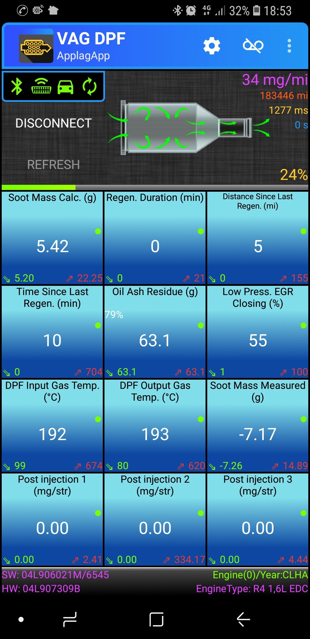

A bit off topic , but i need help trying to understand  one of the figures below. Soot mass(g) measured how can it be negative? Appreciate any help.913019312_Screenshot_20190106-185313_VAGDPF.thumb.jpg.e2d50f0739a69b59948ce53cb4f35524.jpg
Sorry I don't know the answer to your very reasonable question but I do raise an eyebrow at the oil ash figure as you are well on the way to the maximum of 80 grams. Does the engine have a lot of miles on it? Does it drink much oil?
Not sure what the car will do when you get to 80g. Maybe just a warning light that the mot tester will pick up or it might go into some limp home mode.
Almost certainly the only fix will be a new DPF.

The mileage of my car is shown on the top right corner - 183446. Seems to be reasonable for its mileage. Havent really noticed change in oil level, but then again i havent really got a flat surface to park on in my area.
