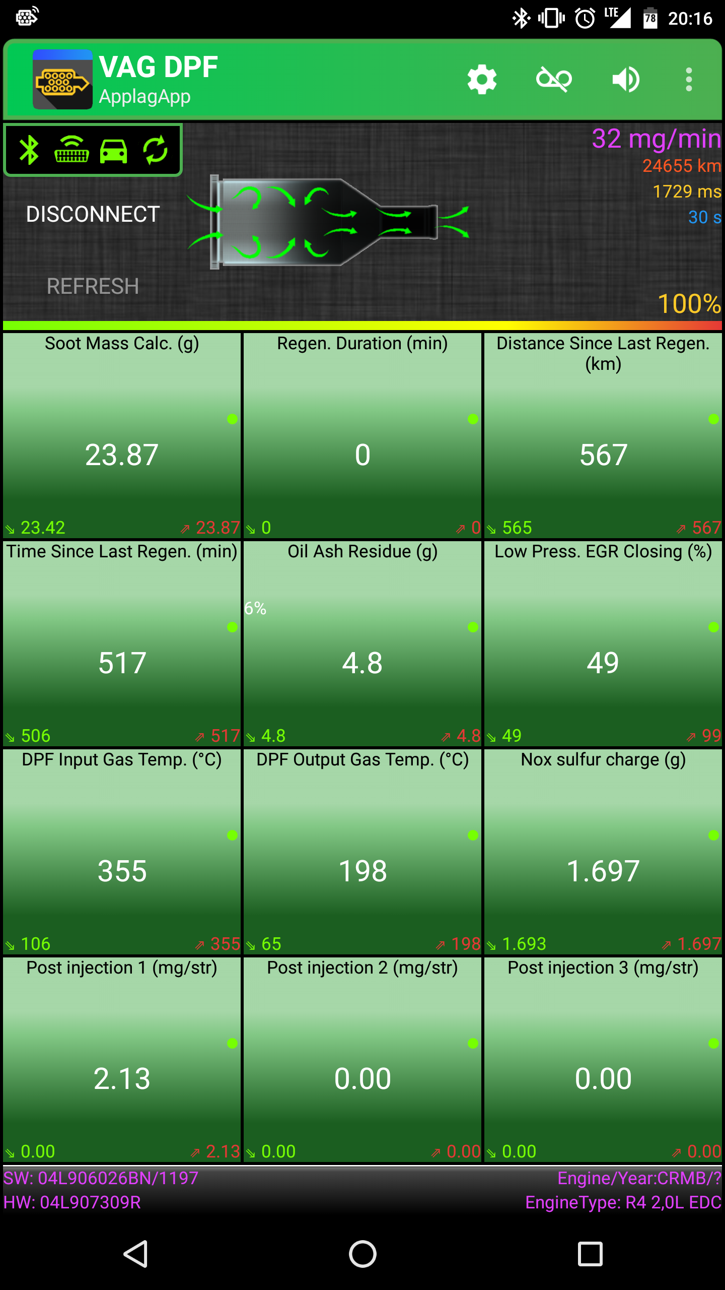

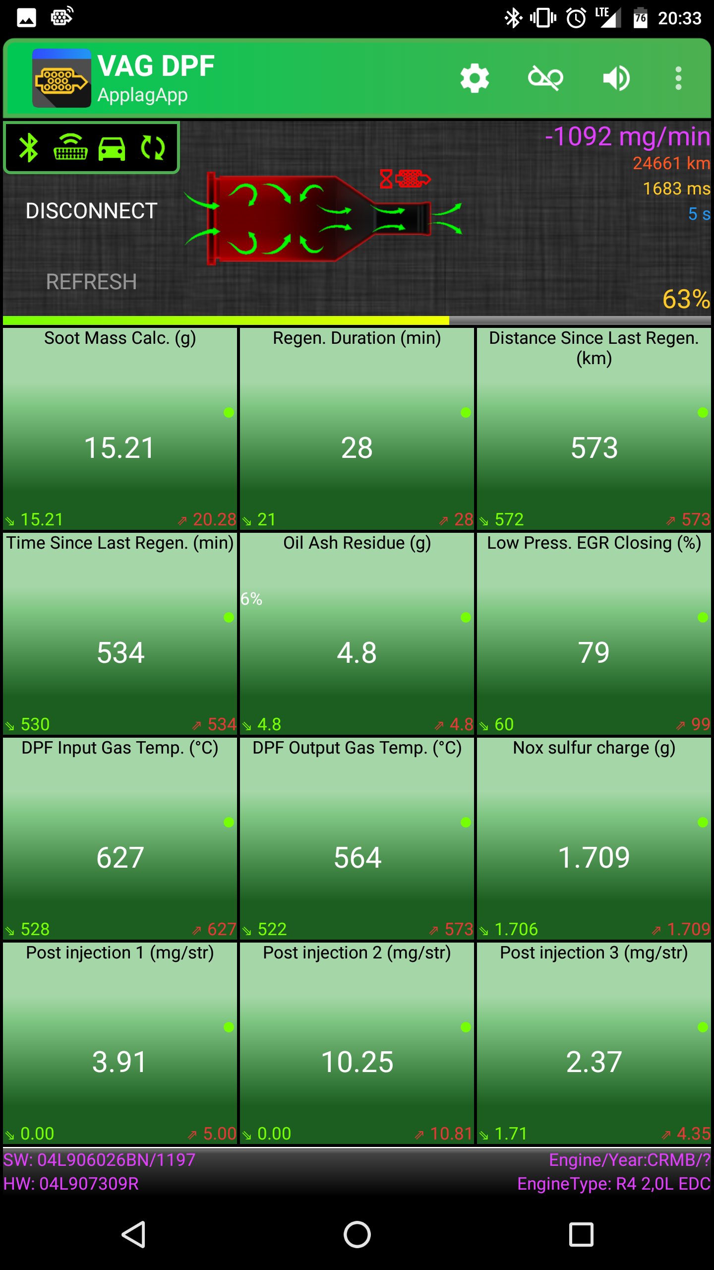

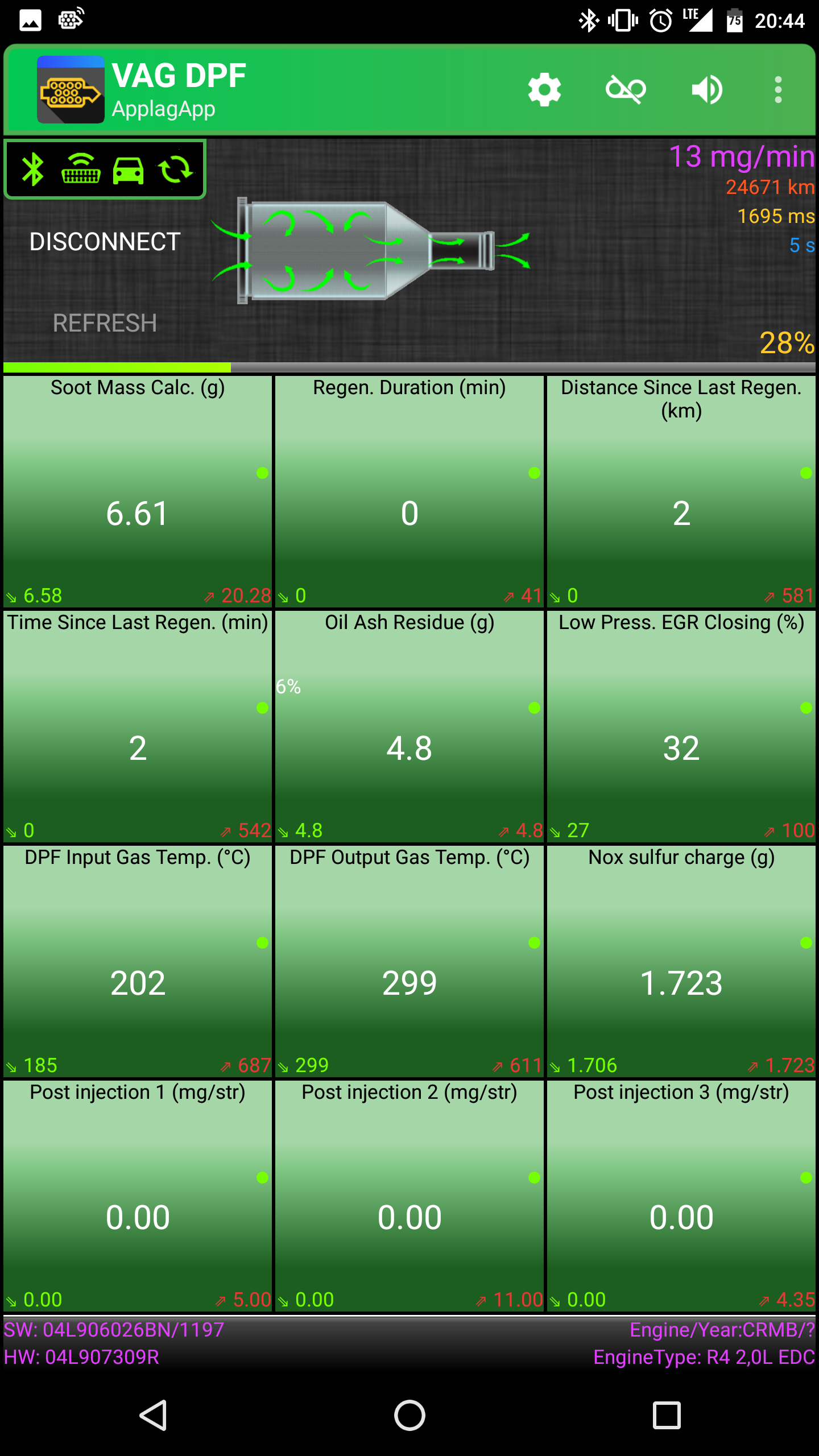

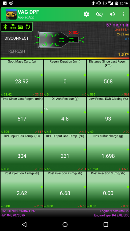

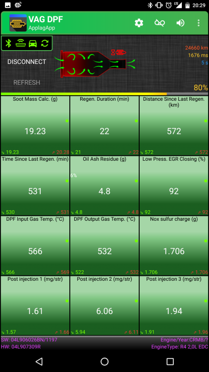

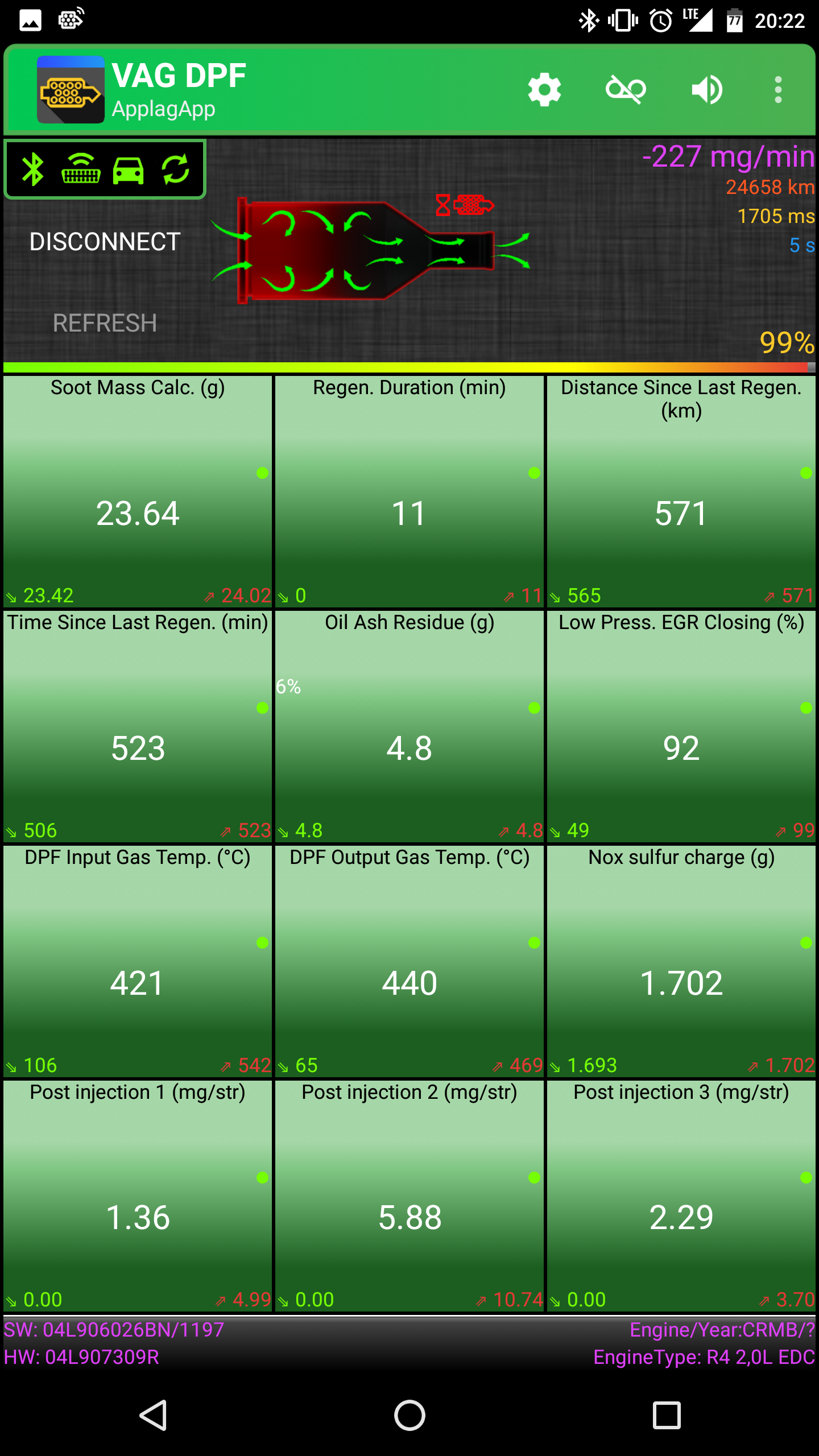

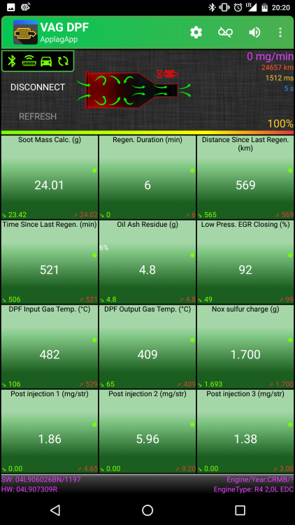

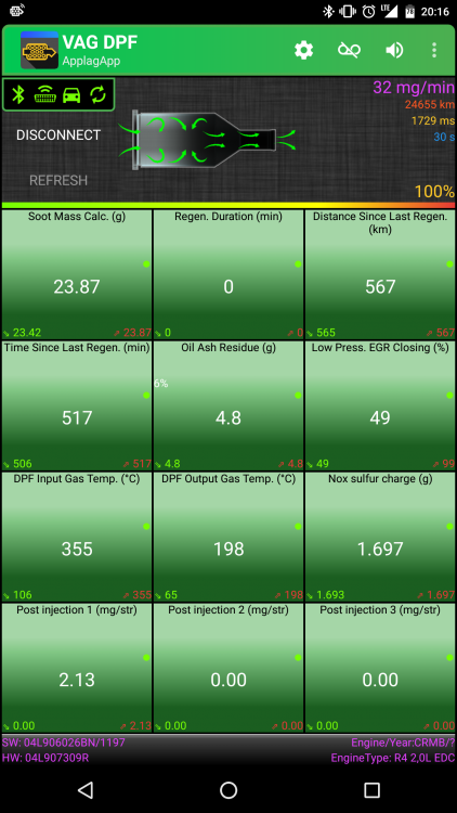

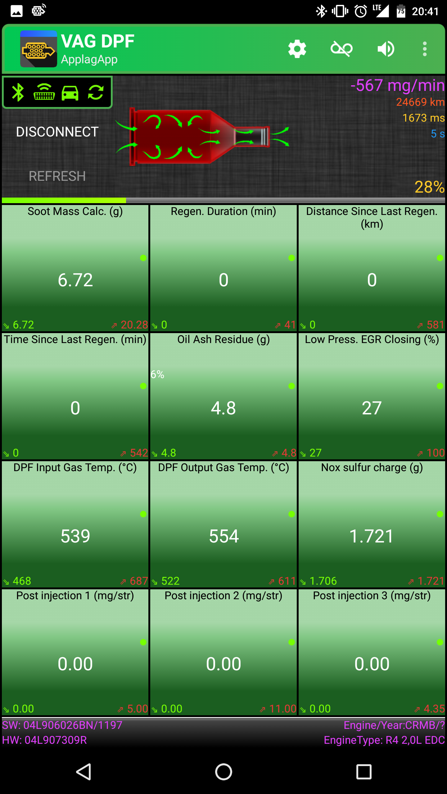

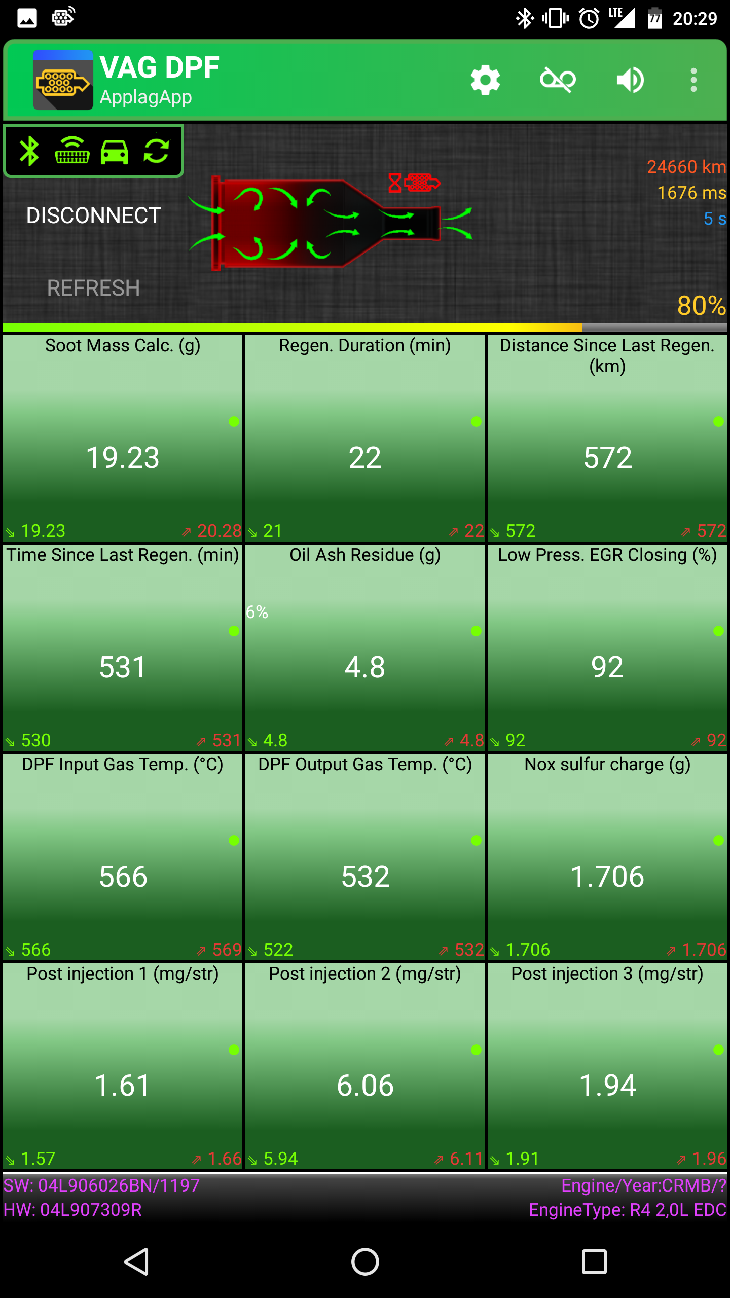

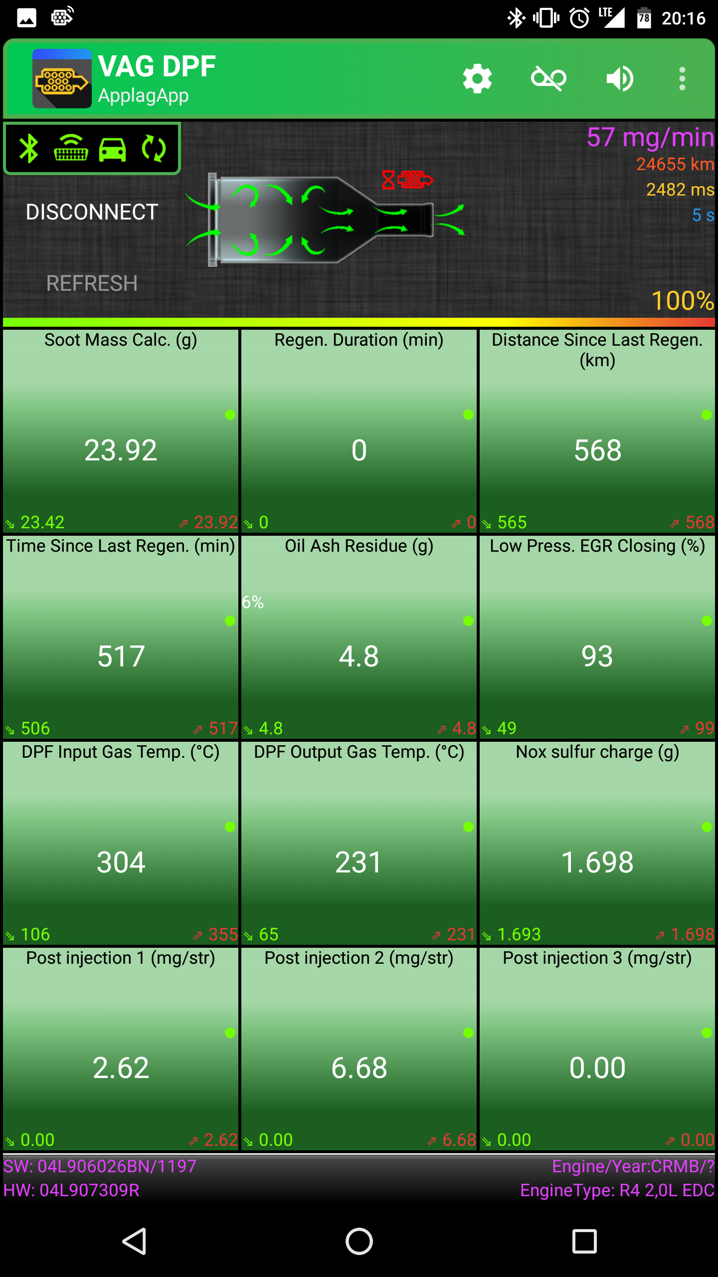

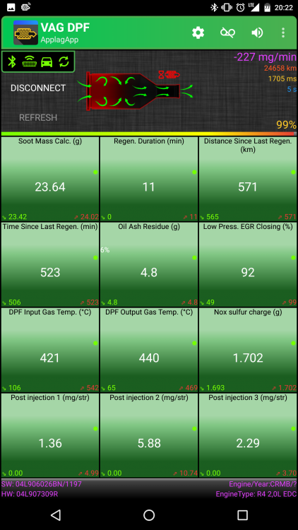

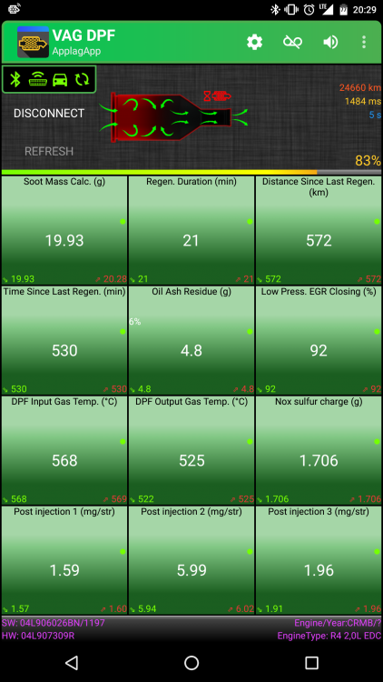

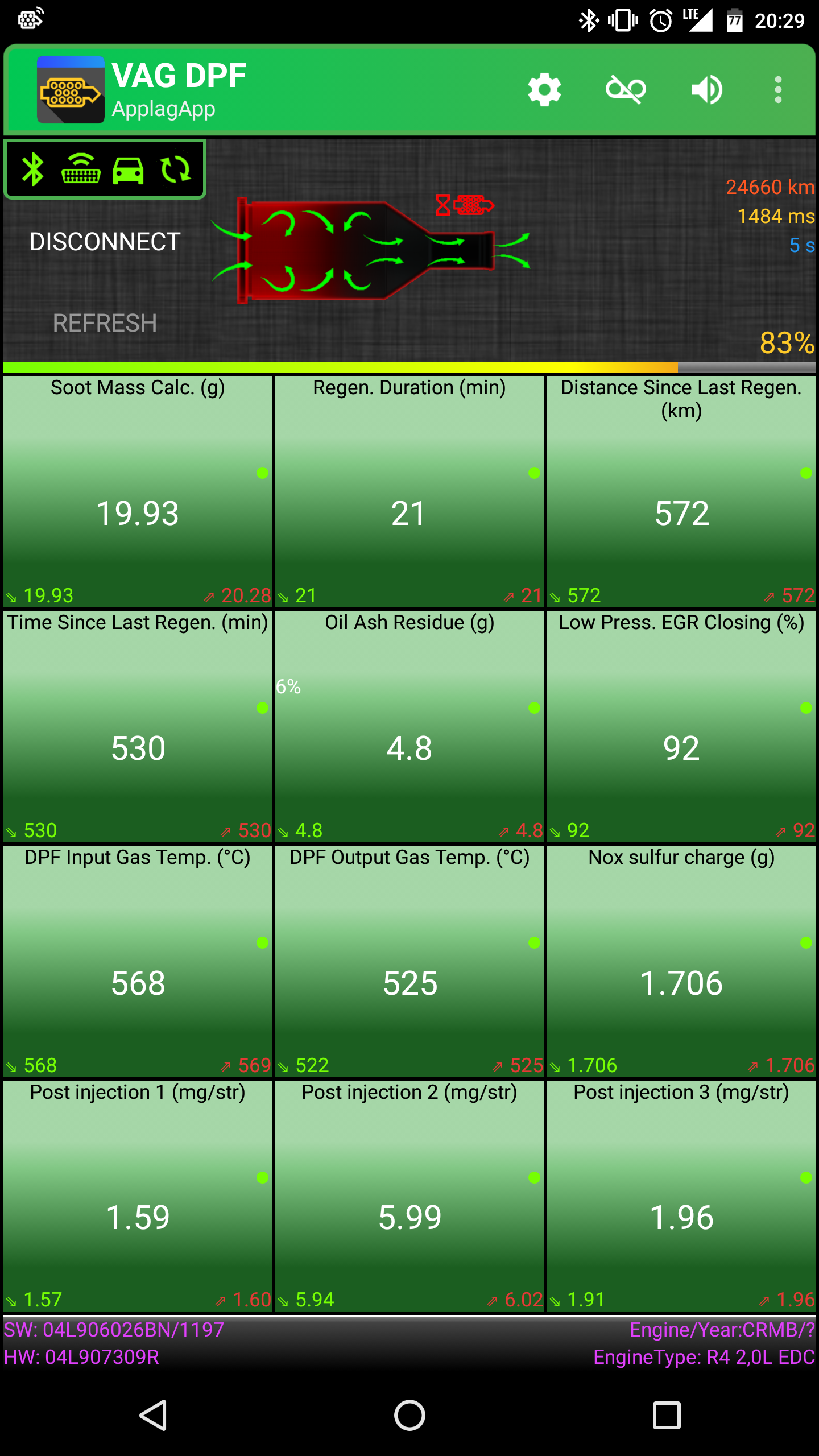

Just want to share my conclusions, monitoring the DPF regen process using application. In general :
1. DPF regens starts when the progress bar reaches 100%, which in my case is 24 grams of soot mass.
2. After 24 grams are collected the ECU schedules the regen (red icon on the right side of the DPF filter).
3. Once regen is scheduled, ECU starts heating up the filter to 500+ degrees. Icon of the filter becomes red.
4. Once temperature is reached, process of soot burning starts. Revs per minutes play smaller role than engine being loaded w/ consumers, uphill climbing, etc. On the right top one can see the values of mass decreasing around -500mg/min to -1300mg.
5. New info for me was that even on idle the soot mass decreases. Slower but decreases.
6. Usual regen in my case lasts around 30 mins and around 15 kilometers.
7. I'm careful and for 25k km the oil ash level is calculated to 6% usage. This is permanent level of filter being used.
p.s. values are calculated as the ECU does not have methodology to know exact values.
Hope this is helpful for you.
