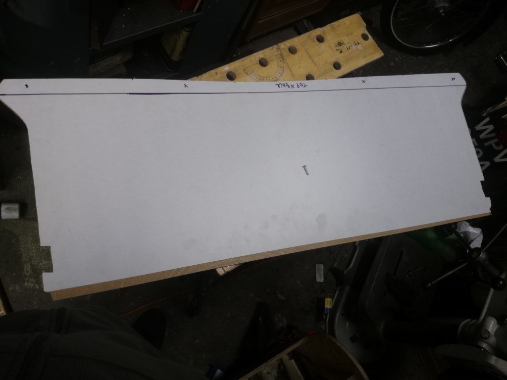

cut some 6mm mdf to size (ideally 8mm as the screws come thru a tiny bit)

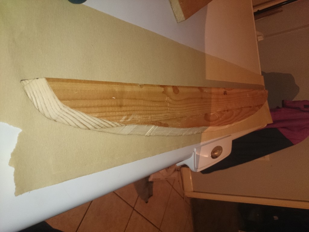

add some inch thick wood to the edges
post-114623-0-67101800-1396393540_thumb.jpgpost-114623-0-26030500-1396393570_thumb.jpg
use a router to finish the edges

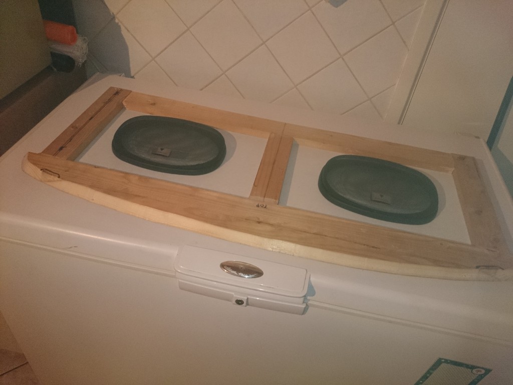

cut some holes for the speakers, mount below the 6mm mdf
add some wire mesh over the top to prevent saggy holes -fnar fnar

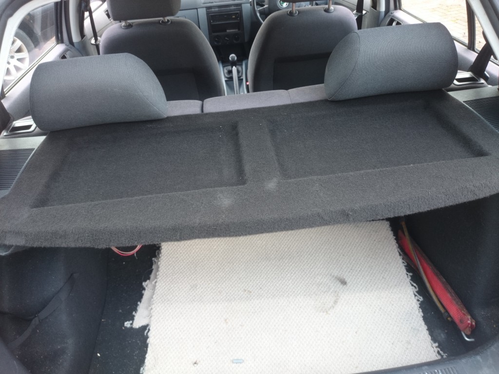

finished thing
Tada!
Looks HEAVY man.
it weighs about the same with the speakers in as the original shelf...
plus with no eletric windows i've saved the weight of 4 motors...

Looks good. Great work
Looks very good, deffo a stealth shelf I'd never know

Only problem I can see is not with the shelf. Those side pods, supports, either side of it are flimsy plastic crap. Though they could be filled with wood/mdf and grip foam or similar, I s'pose.
Ahh yes the supports, forgot to mention I added a few self tapping screws to that as it was hanging off when I purchased the car!
For a moment I thought it was a chest freezer with 6x9's

Looks like your rear headrests are the wrong way around?
yeah the head rests are in back to front, good spot! Guess they'll stay like that until I can be bothered to build some doodahs like the ones that came with the original shelf to hold it down, since no one sits in the back its not a problem and it works very well!
Oh, I didn't realize you were using them to hold the shelf down. Haha
