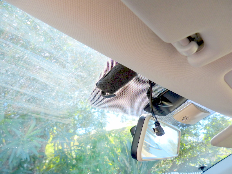

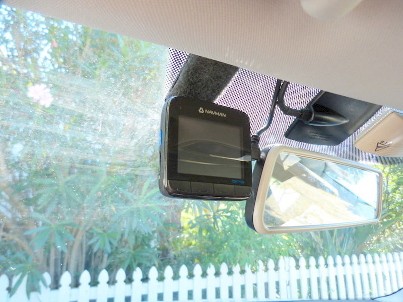

Does anyone have a motion sensor cam to capture any carpark damage/vandalism?
There's a park function with my Navman. This starts when the ignition is turned off and works until the built in battery runs down. Sadly this battery is so puny it only lasts for a matter of minutes.
