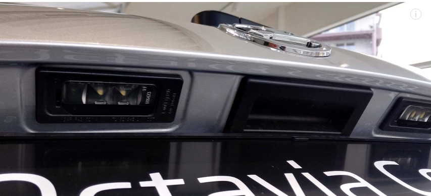

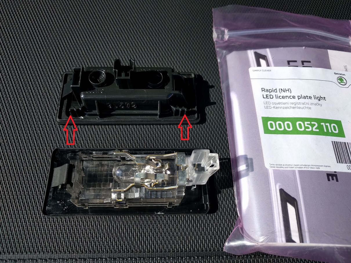

I did this today on my octavia III combi Vrs (my14), did it exactly like It says In the vcds index but we got the broken bulb fault everytime. Tried changing the "Lasttyp 25" to "41" and other options but didn't do the trick.
ONLY after trying the soft reset and clearing the error codes did it work.
Andyvee, you could update the sticky thread, with info of the soft reset etc.
Btw I used:
skoda rapid OEM led-light modules
Part: 000052110
9.90€/ for 1 at your skoda - stealership.
just cut these plastic "wings" and they will fit the right way.

Without wanting to re-ignite the great "which way around" debate for these, the correct way seems to be the way without the wings being cut.
The light is more than sufficient and this orientation seems to be the same as used by VW group cars with the LEDs from factory.
See the posts in this thread, page 2:
Edited by ahenners
So which way is the "right" way? I just followed the  instructions here from the threads and cut the damn "wings" off.
I fitted them with the black "lip" facing inwards and the lights facing outwards. That's how I've seen them on most pictures.
The black strip on the light should face inwards - so sounds like you have it the correct way, but you likely didn't need to cut the wings for it to fit this way. People cut the wings because they thought the opposite way around was the correct/better way, but it would only fit this way by making the modification.
