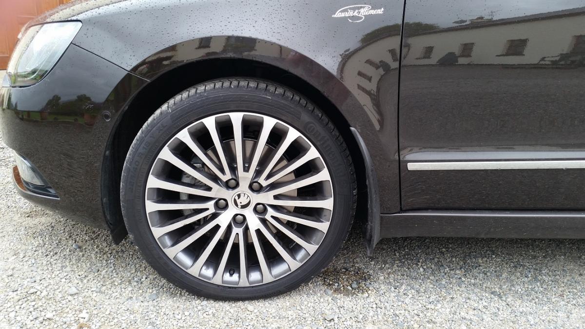

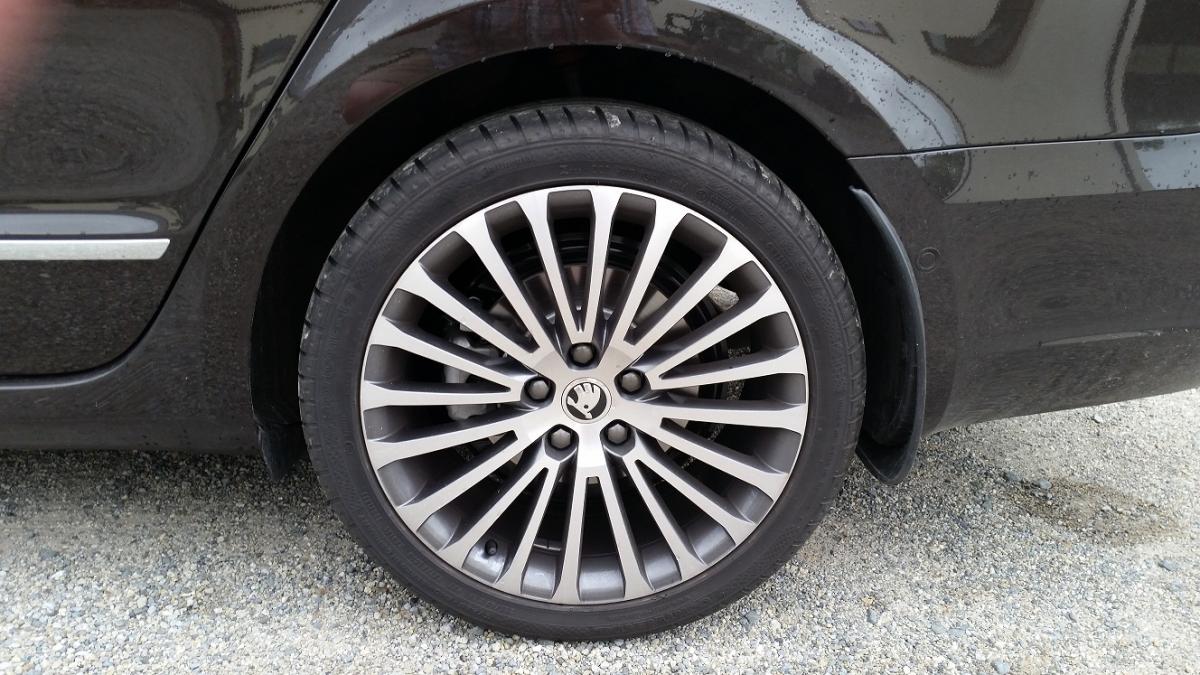

Well you're making some progress anyway even by the process of elimination. What tyres did you have and did they order the same?
Original tires = Continental 225/40 R 18 Y  Sport contact 2 (Still on the back)
replacement tires as above but Sport Contact 5 (on the front)
they look different
The back tire is "chunkier" than the front. Think it just looks a bit off having different looking tires on the front and back
Side view
front new tires
Back - Original tire
