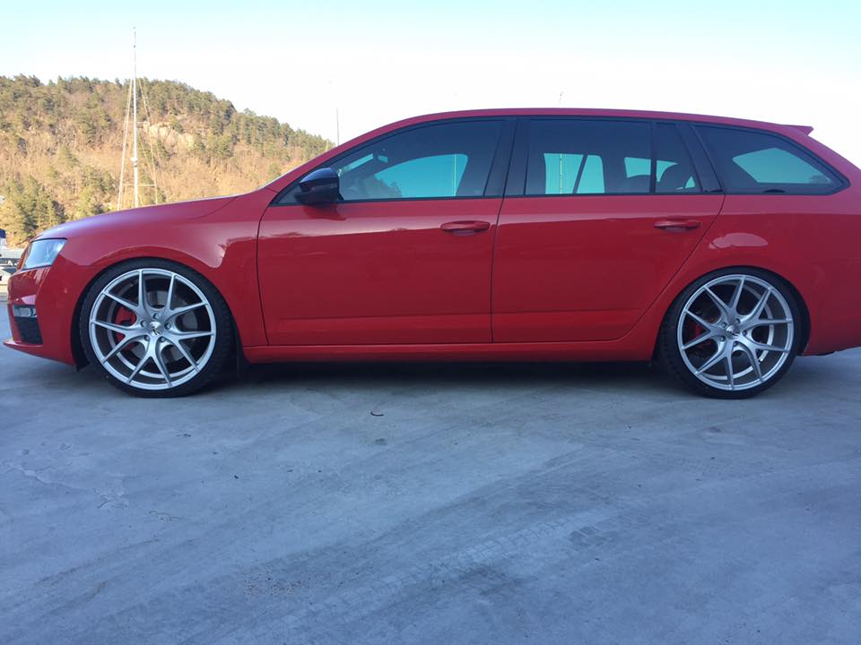

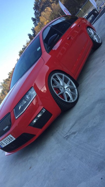

Ok, some more pictures before/after
Back
Front
Loving the look and performance!
Measurements after 50km:
- 40mm back
- 31mm front
  :clap:
