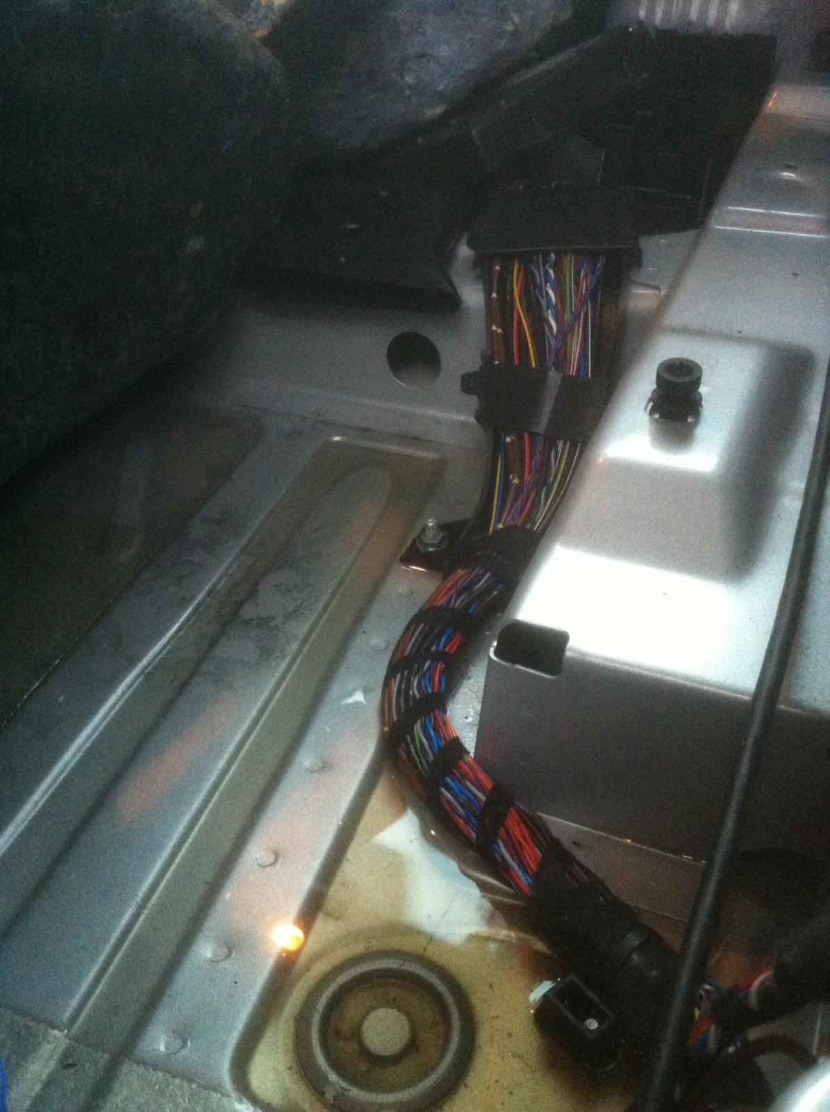

I have now managed to remove the center console. Rear ashtray took a while to figure out, I had to pry it out with a lot more force then expected but all went well in the end.
Now to look for the leak.post-123456-0-48648800-1415564196_thumb.jpgpost-123456-0-00021900-1415564316_thumb.jpg

Eek!
Thats proper stripped out! Your a braver man than me doing that.
Hope you find the leak, and manage to put it all back together again (with no rattles)
Regards
Damo
Jeez, not even a big workshop like ours would do that
10/10 and a gold star for bravery!

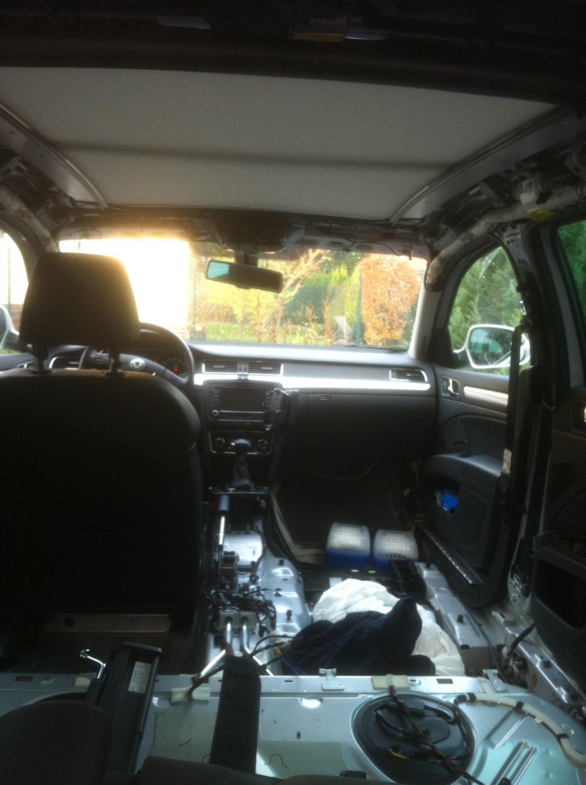

I have also completely removed the roof lining to get a proper look at the sunroof drains.post-123456-0-09479700-1417470719_thumb.jpg
They all look dry and no really noticeable water stains on the inside of the roof lining.
Hopefully the car wash will show me the leak, it will save me a lot of money.
The garage wanted €1200 just for stripping the car out, then finding the leak would have been on top of that!
