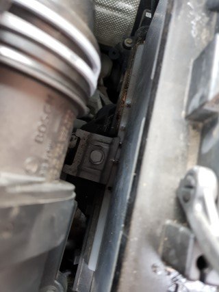

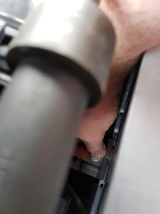

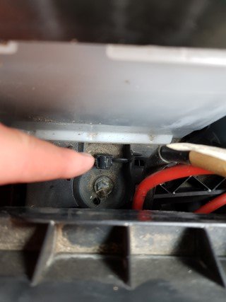

You can make enough room to get your hand down there by unclipping a few hoses from the air intake. If you're really stuck you can unhook that section of the intake (this is what Skoda recommend in the repair manual) but I found I didn't need to once the small hoses were out of the way. Use a 250 mm long extension bar on the ratchet to get down to it.

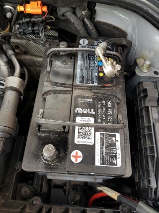

All done and took around 15 minutes with no horror stories!
Skoda Superb 2.0 TDI 170bp 62 plate.
13mm socket for the clamp and a 10mm for the connectors.
59c00c61b22c0_20170918_162609(Mobile).jpg.ca74dc154001135d50d3c18e5beaee1f.jpgOld battery
C59c00c622e877_20170918_162616(Mobile).jpg.e149c8ee10c73e764e57123738c21d97.jpgcable tie holder that was holding the power cables together.
59c00c629dd72_20170918_162624(Mobile).jpg.42ea7608f268ca29ae9e75c0b43a06c8.jpg59c00c632480c_20170918_163038(Mobile).jpg.d23c67b70c934e4483ac83a66556e01e.jpgas you can see easily got my hand down and undid the nut by hand after using the socket set and refit by hand with plenty of space
59c00c638af43_20170918_163920(Mobile).jpg.1235dd80372ff9a698a510c28e46ff01.jpg59c00c63f00f8_20170918_163933(Mobile).jpg.dd3a1994692dc628455277eb4ea64bb0.jpg59c00c6479f76_20170918_163949(Mobile).jpg.87b2e085eceb4d5dcd905df9291eda57.jpg59c00c64efa4c_20170918_164005(Mobile).jpg.2702a3ceeb78db3282a445a3f3c3ee63.jpg the warning I got along with the warning lights and within 20 yards all the warnings went out after a quick trip.
Only thing I had to do was reset was the clock. All other functions remained the same, Windows were ok, boot ok and sat nav ok!
