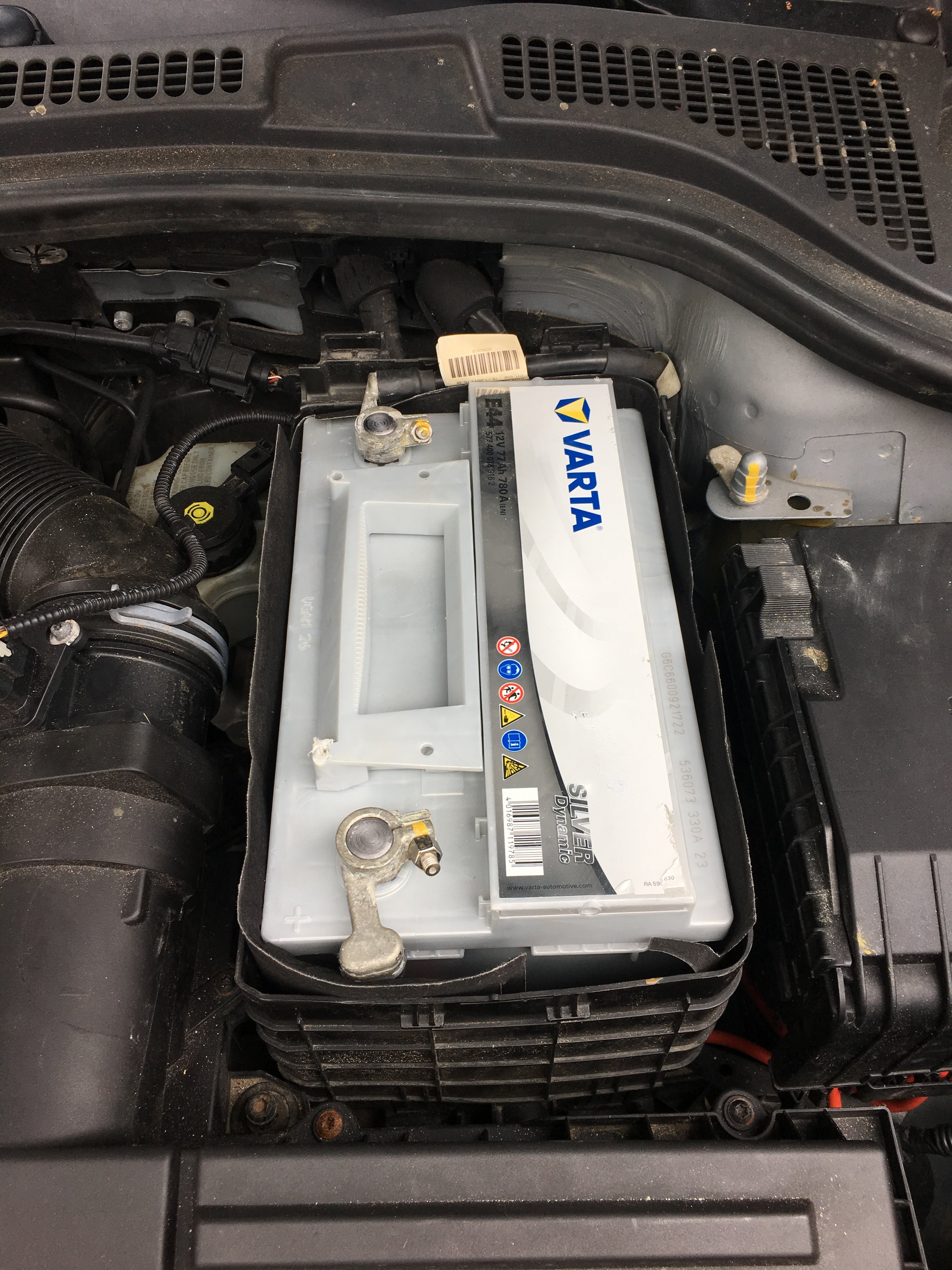

Finally got my battery in today. Quick swap without pulling the air intake or anything. The Verta E44 popped right into place with the factory covers etc fitting overnit nicely. Thanks for the help. I hope the starting issue is over now.
Joe

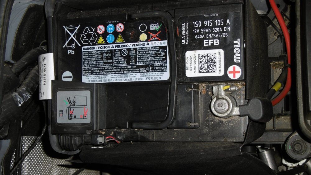

I've not heard of the orginal equipment battery in mine (unless it was changes in the first year) "MLA MOLL" - made in Germany
Amp hours looks a bit weedy at 59Ah - althought it's only got a little 1.4tsi to spin into life. Is that 640 cranking amps or 320?
