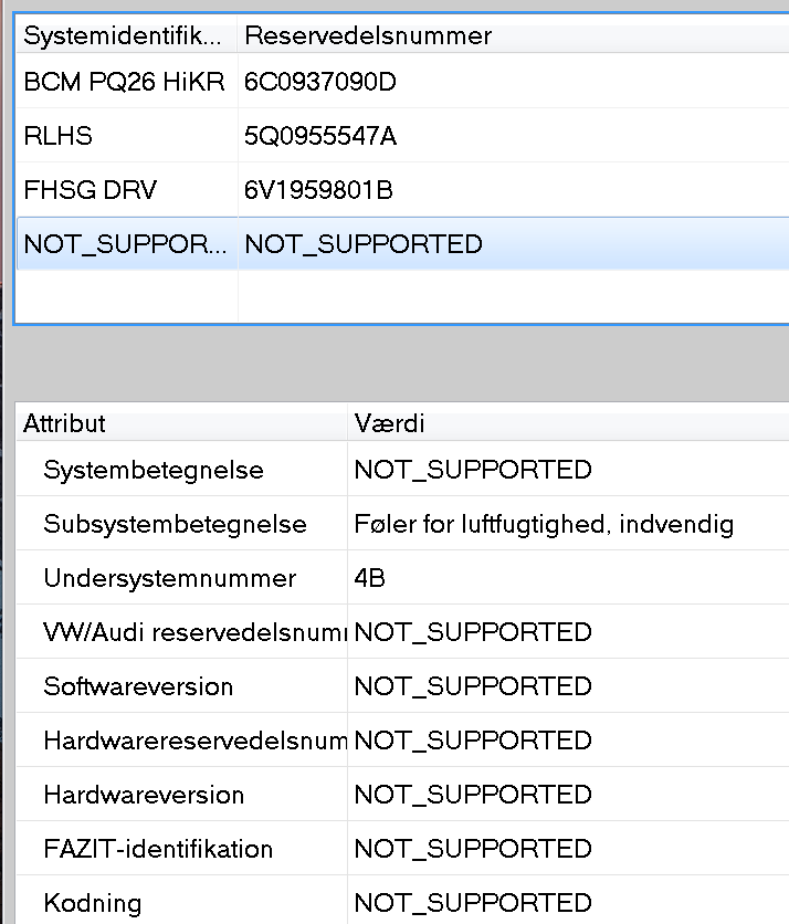

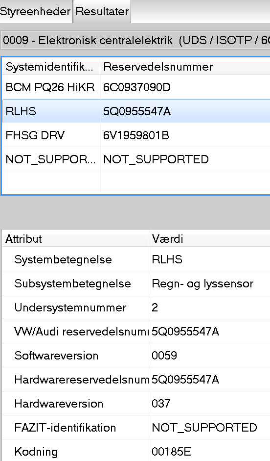

Have followed this precisely with a 5Q 955 547 A sensor, but I get an error on the humidity part of the sensor (for the climate control), is there something wrong with the coding of the sensor: 00185E, can someone help me translate 00185E? My car is a Fabia III Ambition 1.2 TSI 110hp DSG 2017 model without light assist and rain sensor.
Here is my long coding: 0C 02 18 50 42 15 4A F3 43 80 40 00 40 35 03 08 00 00 55 00 D3 0A 35 00000000000000
It appears to me as 5Q 955 547 A is not supported, while 8U0 955 559C or 5Q 955 547 are?
Thank you
