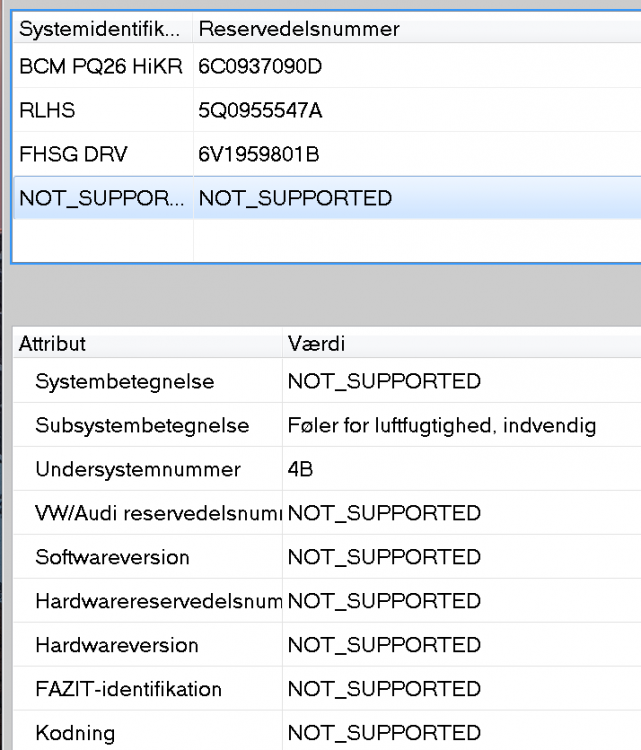

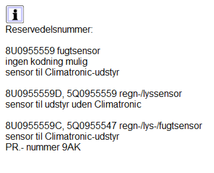

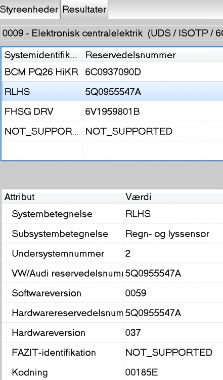

Hi,
I would like to retrofit the rain sensor so that I can have automatic windscreen wipers.
I have a SEL Estate – With Climate Control
The reason that I mention the Climate Control is that you then get the “big” rear view mirror, because behind it, a humidity sensor (P/N: 8U0 955 559) is placed.  This is the same “look” that a car with the rain sensor has, so in my opinion, you don’t need to change the windscreen.
As far as I know, the windscreen wiper stalk is the same with or without the auto function.
To help me out, your car must have Climate Control and automatic windscreen wipers.  Some cars, like mine, only have one of the two.
Could anyone with VCDS please tell me the P/N for the rain/humidity sensor?
Under module [09] Central Electric >> use the dropdown menu >> take a look at the third P/N. Could be something like 5Q0 955 559 (A) or 5Q0 955 547 (A) as previously mentioned, mine is 8U0 955 559
The long coding for the module is also at nice thing to have :p
On some cars, the light sensor I also fitted behind the rear view mirror, but not in this case.
I have a square plastic piece at the button of the windscreen on the dashboard. - Cover it and the lights will come on. The conclusion may be that this is the light sensor.
