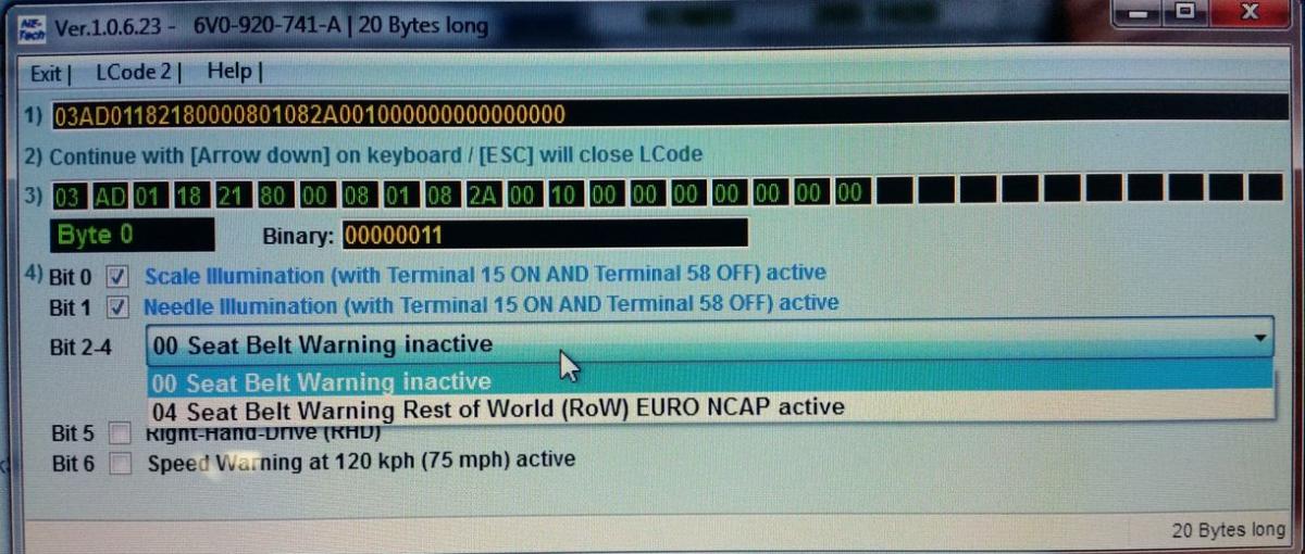

Hi guys,
What are codes that should be done to disable the seat belt warning on Fabia III?
Hi guys,

Tested on Fabia MK3 MY16
Seat Belt Warning disable:
Controller 17 - Instruments
07 - Coding
Byte 0
Bit 2-4 (Drop down menu)
00 - Seat Belt Warning inactive
Pic attached
