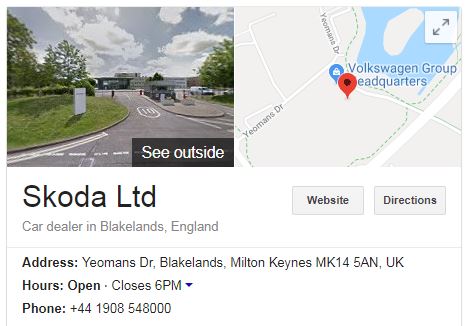

Having got the car back the week before last (with a not-as-big-as-it-might-have-been bill), it's about time that I tried to extract some money from Skoda UK.
What's the best postal address for Skoda UK customer services? Is it the VAG headquarters in Milton Keynes, or the Selectapost address that I've seen elsewhere? (Or do they end up in the same place?)

http://www.skoda.co.uk/about-us/contact-us
Well, yes. I know of the online contact form. I'd rather use something a little more formal, where I can send a proper letter with attached invoice from the garage that carried out the work. Tends to carry more weight, I find.

I intend to … once I'm sure of the correct address!
Send to both ;)
Edited by jafo
5 hours ago, silver1011 said:
Yeah, I can use Google too
