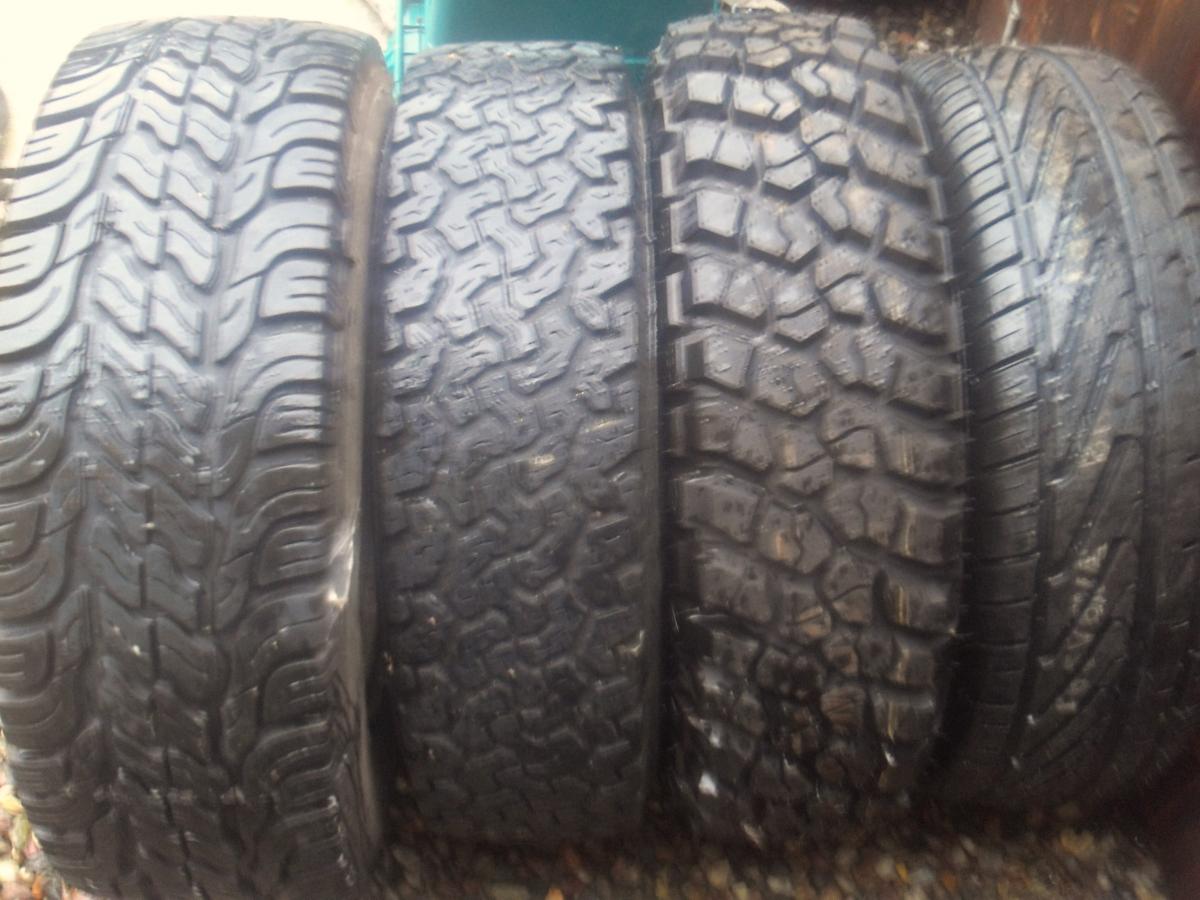

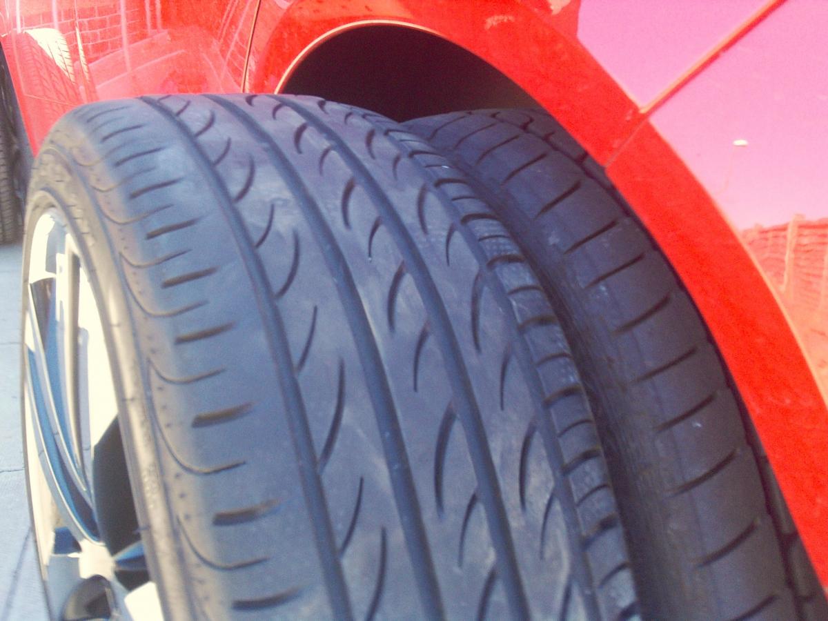

Do not assume because the Profile Numbers make it look like you will have taller sidewalls that you will.
Compare Tyres side by side, because Brand & Tread can mean say that the Tyre is Wider with Rim Protection then tread
and as an example i have Pirelli Zero Nero 205/40 R17 that are physically bigger than Dunlop 205/40 R 17
but also bigger than Hyfly 215/40 R 17 that i have on now.
