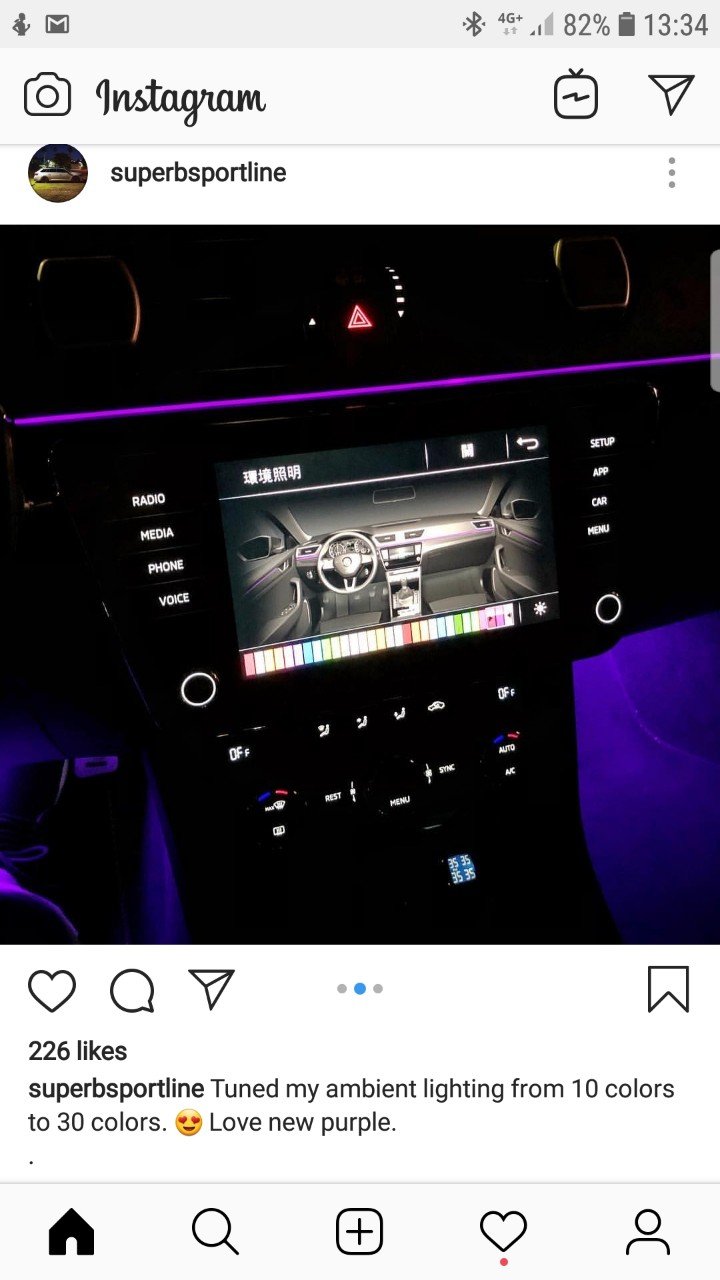

Hi guys, newbie here.
I found this going across the internet.
Anybody has any experience with it?
Would really love to have more colors. Has anyone tried to produce RGB mode? By RGB I mean that colors are changing continuously.
Thanks in advance.
Thanks in advance.
0-02-05-970c09b171724873537da8191051ceed65189c93fd54bff39b1a99740261422b_45459caa.jpg
Wow - how has he changed color of the light in lowest (legs) lightening? In my case it is always white, I can only change color of led strips.
