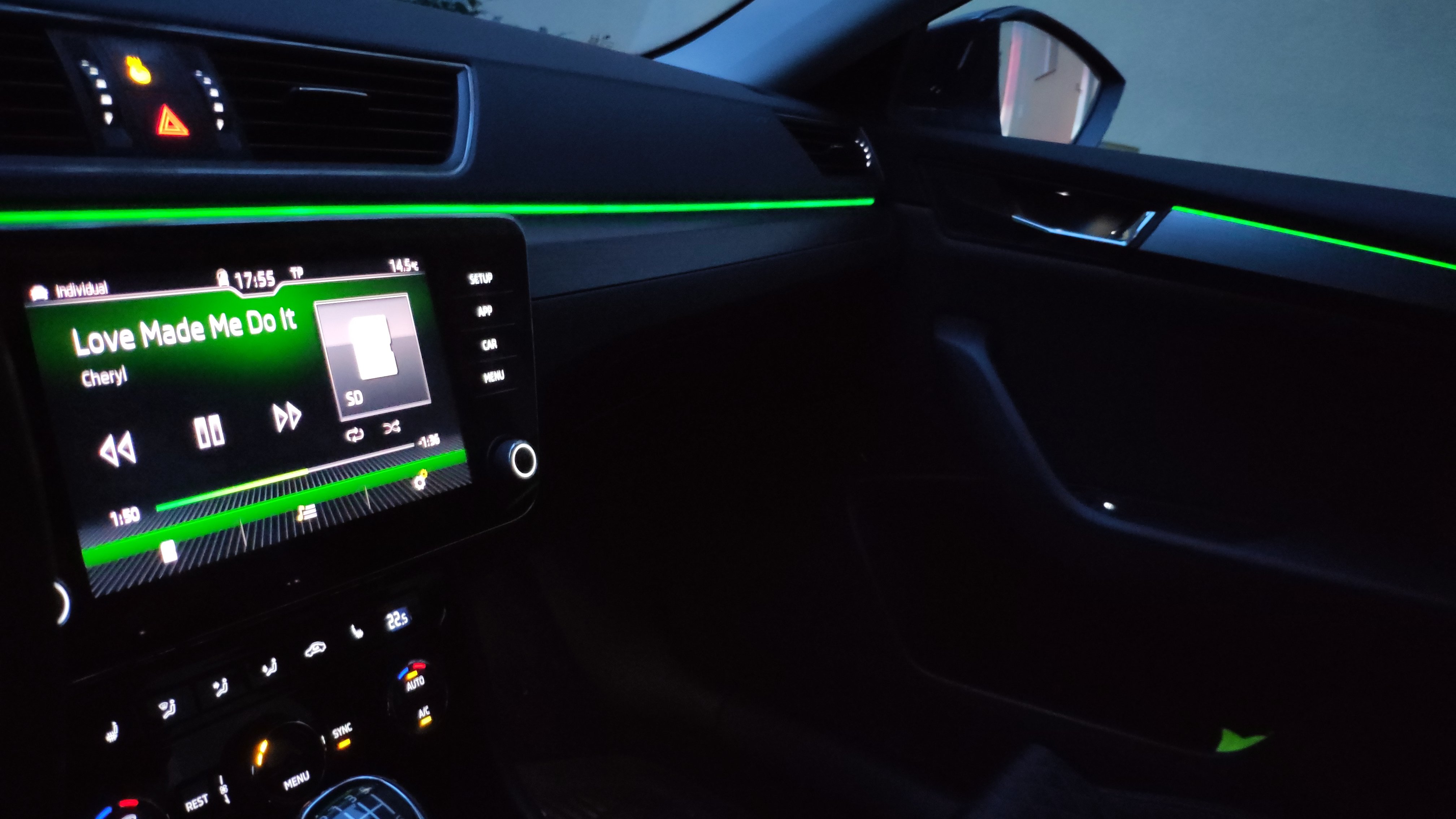

Me too! Would love to have more than 10 colors! Also I really wanted to make white but I can't find proper color code for 100% white. Sadly...  Oh I modified all colors using VCDS (ODB11 actually) and damnnn they're so much nicer now... The green is far better, red, violet, purple, all are more "vivid". I love them now. Before I modified colors I only liked "dark blue" and even that was bit meh. The new "light blue" i set is also soooo awesome... got to take some pics :D  The green I took yesterday for spring.

Um got to check I'm not sure if I can find it in ODB11 without connecting to car. Will do tomorrow.  The picture makes it few ticks too "light green". But its almost as on picture.

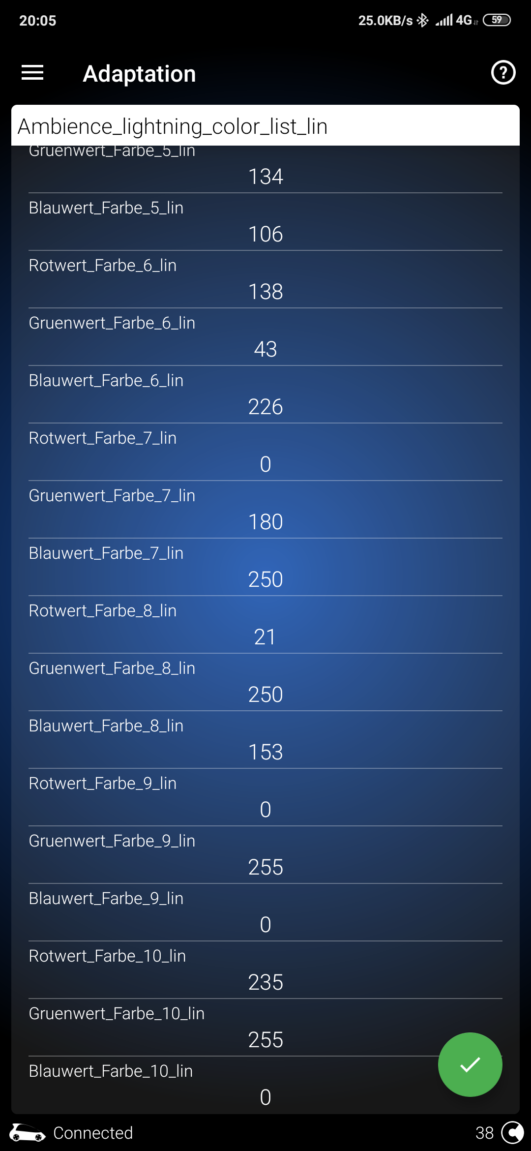

Actually its same way as Gizmo's Adaptations tried and tested, just with specific RGB values. Which are not 100% based on RGB though. It seems RGB controller for lights is not very accurate. But its still amazing that we're able to do so many different shades of colors. I'm really happy about that. In new A6 the RGB ambient lightning is like 860€ in Slovenia... Which is super crazy expensive. Even stupid expensive..

Haha its basically 0/255/0

Thanks @JackySi, I will give that a try later, the OE green is 58 / 245 / 4
Screenshot_2019-03-01-20-05-53-026_com.voltasit.obdeleven.thumb.png.775f484dc48d0b35cfc3b8a3a95baea3.png
Hi i want to change to bright green, ive changed the gruenwert farbe 9 to 255 but it changes it to red.... Am i doing somethung wrong? Im using an obd eleven
