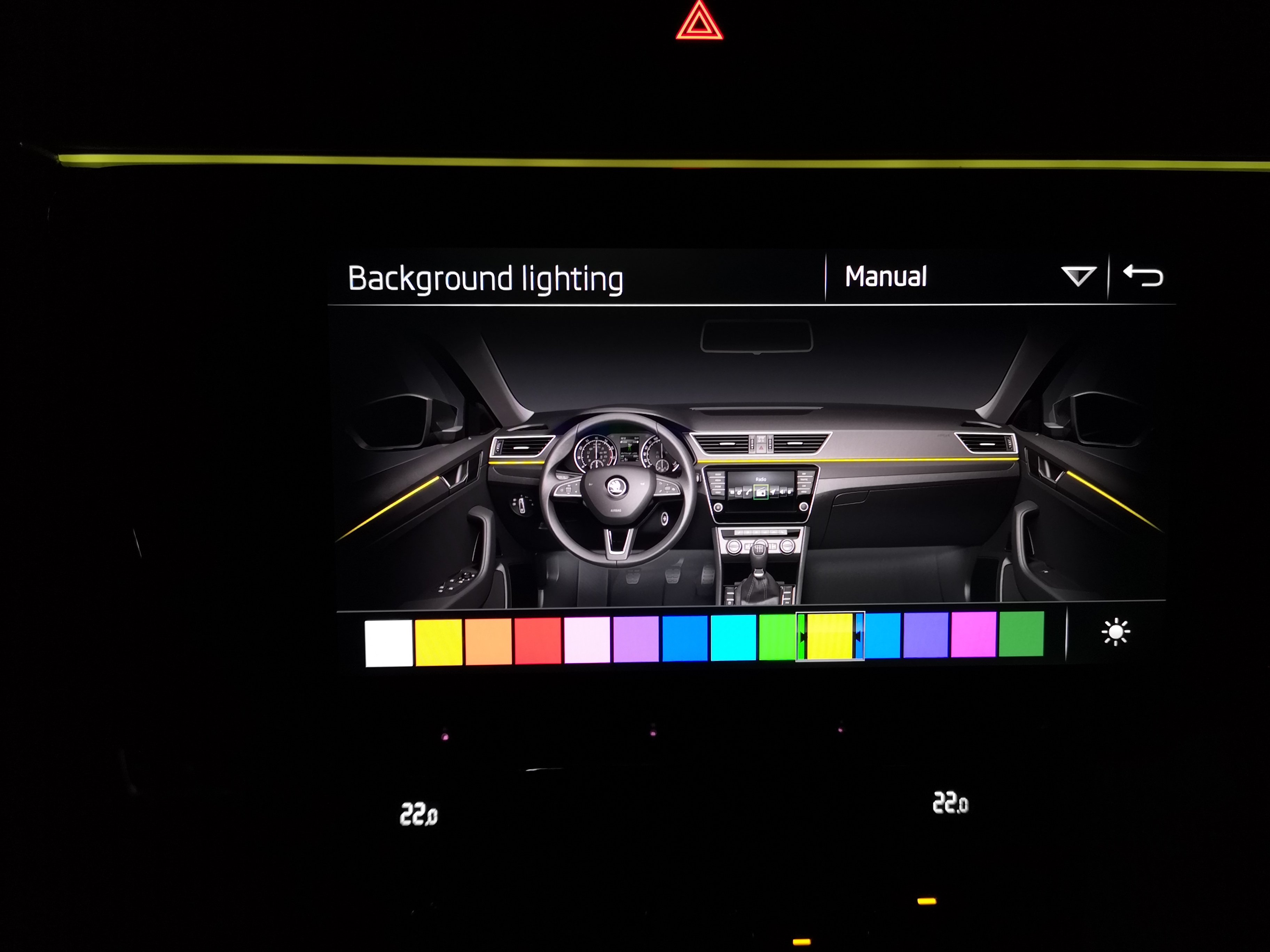

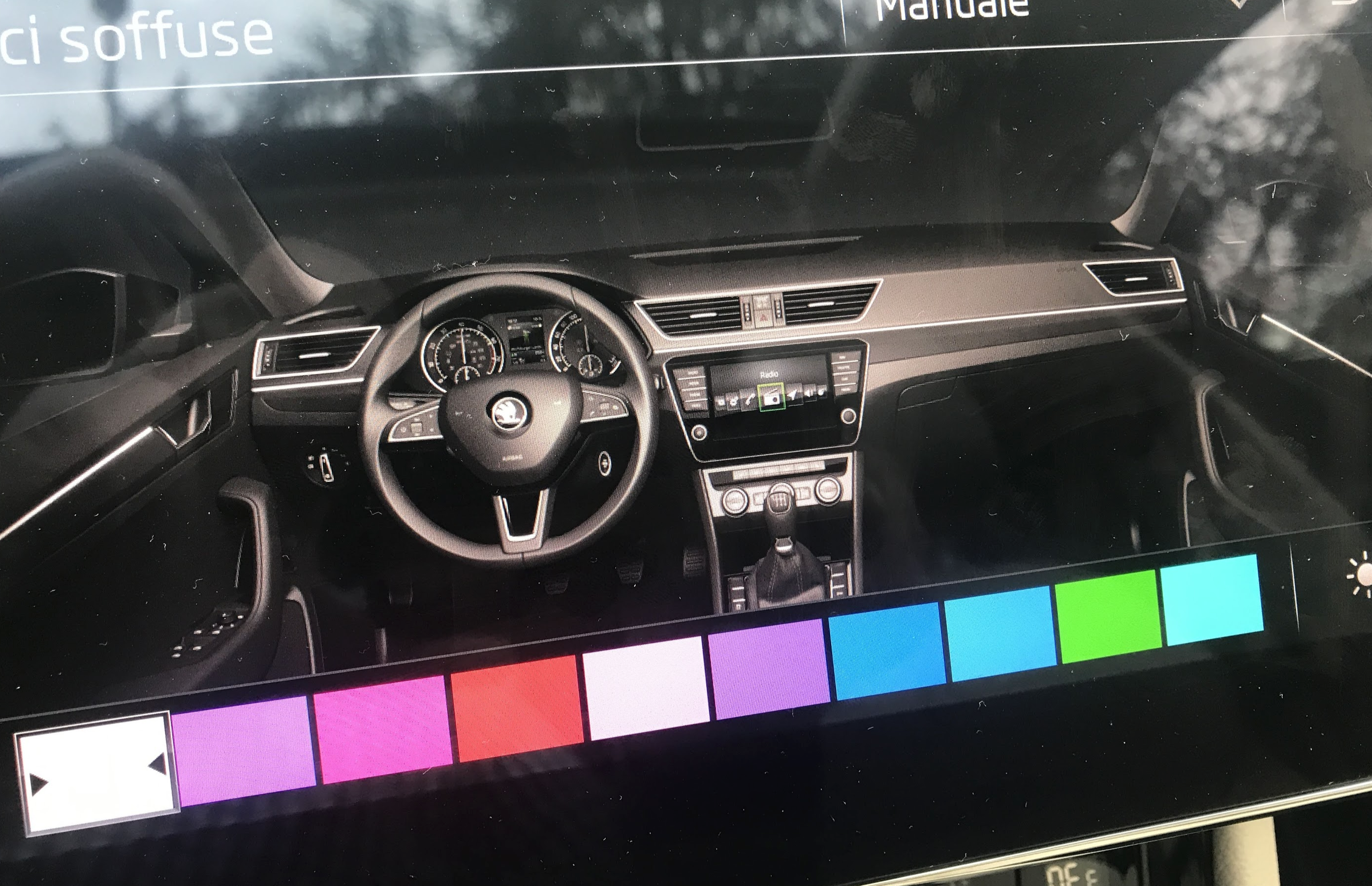

On 02/03/2019 at 18:53, newbie69 said:
This is so silly but so funny at the same time. Played around with the RGB values this afternoon and modified Red and Green in particular to only be 255 in their respective channel as the stock Red and Green included a bit of the other two colours as well, they are now proper vivid Red and Green (especially the Green is a big improvement, stock was a sorry sight). Tried the same with 100% Blue but it almost became dazzling so added a bit of Green back. I can now see the logic of "diluting" the standard colours with a bit of the other two, takes away some of the vividness but they are easier on the eye for some people.
One colour which I just couldn't manage is Yellow. According to RGB values it should be 255/255/0 but when I tried that it gave more like a faded tone closer to pale orange, just as bad as the stock one. Reduced the red to 120 and it looks better but still nothing like proper yellow. Anything we can do about it? Would like to set the basic colours as close as possible to reality.
Also, If you do change a colour completely, how do you change the colour of its label in the selection pane? Possible? Otherwise I'll just stick to modifying the colours I don't use, rather than changing them to something else.
I managed to change the colour of label too (OBDeleven):
Controller 09 - Central Electronics
Security Access 31347
Adaptations
--> Ambience_lightning_color_list_lin
--> Ambience fahrbelist
The second one changes the colour of the label
Adaptations
You're a hero!

There are two other adaptations that seem to be the ones (colour_list_lin2 and colour_list_2 show numbers from No.11 to No.30) but I couldn't get them to work.
Also, back to your previous post, I tried yesterday to customize the labels and failed miserably. Modified some RGB values under Farbliste but not only the label colour didn't change, the colours themselves also stopped being modified according to the RGB values entered for colours  and even one turned to Red.   I remember colours were turning to Red when values under Farbliste were randomly changed, another member here had this issue when he mixed the adaptation by trying to set custom colours while he was by mistake modifying the Farbliste values. Got it as before in the end after reverting all changes and doing a reset and restart.
So any special instructions as to how to get the labels to show the exact colour you've assigned to them? Do you need to copy the exact same RGB set to both the LIN and LIST adaptations? Is there a particular sequence or some post-modifying action needed? Like resetting Background Lights or turning off/on in order for the changes to be correctly applied?
Edited by newbie69
i applyed the same rgb colour to both "ambience farbeliste" and "Ambience_lightning_color_list_lin". First attempt didn't work, so i changed again rgb values and once finished i closed the car and reopened. Once reopened it worked.
But double check the values you enter because i'm almost sure that those codes you digit are not registered properly. Not meaning that you enter wrong codes but i think there is something like a bug that doesn't allow save correctly.
I had to double check every time and almost 50% of rgb values were wrong after i saved.
This worked on mine so it should work on yours too  (my 272 l&k has been built in 8th week 2019)
Thanks. This confirms that this adaptation acts a bit weird. Changing the RGB values of colours works immediately and you can see the effect right away, but modifying Farbliste you can't be sure what's going on untill you restart I think.
Maybe that is why the other two channels (from No.11 to 30) didn't seem to have an effect either. Maybe you just need to fill them, save and restart before any change takes effect. I will do some more testing...
I didn't try, let me know if it works! :thumbup:
Ok, I believe I have cracked how the whole system works and why it seems to go wrong at times and also why there are inconsistencies with some colours (my first ever very own adaptation discovery - inspiration from @Roscio after he managed to modify the colour labels even though we thought it wasn't possible) so here follows the:
Ambient Lighting ULTIMATE guide
- There are 10 different colours assigned to Ambient Lighting from factory which can be tweaked as little or as much as you like
- There are 20 extra slots to be assigned at will taking the total to 30 available colours if you so desire
- The stock colour slots, no.1-10 are controlled by two different adaptations: "Ambience_lightning_color_list_lin" controlling the RGB values of the interior LEDs and "Ambientelicht Farbliste" controlling the RGB values of the colour labels on the infotainment screen. Similarly, to unlock the extra 20 colours (or as little of them as you like) use: "Ambience_lightning_color_list_lin_2"  (RGB values for LEDs no.11-30) and "Ambience_lightning_color_list_2" (RGB values for the colour's labels).
These two (LED and label) can have different values for each colour ie. it's not necessary to give a colour and its respective label the exact same RGB values for it to work. Of-course it's good to give as representing a value set as possible in order to know what colour you're picking, but below is why you can't just copy/paste the RGB values for both in some occasions:
Well, it seems that the green LED of the system is significantly weak/dim. You can confirm this by entering 0/255/0 for any colour, this should result in a bright green but it will in fact be a much darker one. As if you had given 0/155/0 or lower. Roughly, the Green's value is 100-125 units down from where it should be. This means that to get as close as possible to a colour when following its official RGB values you have to add 100-125 units on green. And on colours where the Green is already at 150 or above this is not possible. This problem does not show up on colours which are made primarily of Red and Blue or where their ratio compared to Green is rather large. Red, orange, Blue, Purple, Pink etc. will be pretty accurate. Finding correct green, yellow and white tones is a PITA.
On the other hand, the colour labels being drawn on the infotainment (which is a proper LCD screen - not just 3 LEDs) are very accurate so using official RGB values from tables to that, will result in exactly the colour you had in mind.
So now you know how to modify the first 10 colours or add as many as you like (up to 30), why some colours are not appearing right when entering the official RGB values and how to try and correct them.
Standard procedure and Quirks:
- Enter module 09 Central Electronics and give security code 31347 as usual for this module.
- Modifying a LED colour via the LIN and LIN 2 adaptations is being applied instantly and you can already be in the Background Lighting menu and simply switch to the colour you've just modified and see how it looks ( I prefer to not already have selected the exact same colour I'm modifying but maybe that works too - can't remember right now)
- However, modifying a label's colour will never update in real time and even worse it will result in some sort of "lockdown": The number which has been modified will turn Red no matter what values you've given and all other changes even to LED colours will have no effect from that point on. To solve this you need to turn off, lock the car, unlock the car, turn on ignition again and voila, all the new or different colour labels will show up fine! Just turning ignition off and on didn't do it for me. Doing a full turn off as above worked every time.
I suggest you group all label modifications so that you minimize the amount of restarts. After all, their tones are accurate and you know what you'll get. Once you modify or add as many labels as you like, restart and enter the ... ... LIN and ... ...LIN 2 adaptations to enter the LED's  RGB values. Those that contain lots of Green won't be similar to the label but for those you can play around in real time without needing to turn off.
My current 14 colours (will add more but battery showed 67% at that point after 20min of modding with OBDEleven and decided to call it a day):
